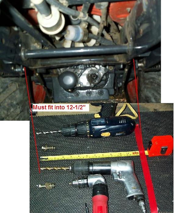

I ain't no engineer or mechanic (but I already know from experience that I need a skid plate). What kind of drill am I going to need for this job? Something tells me my cordless drill ain't up to the task.

I had no problem drilling thru the frame with my 18V Milwaukee, however, as I mentioned in a previous post, I had to cut about an inch and a quarter off the 5/16 bit in order to fit the drill between the frame at right angles. Also, drilling a 7/32 pilot hole first will make the job a lot easier. Depends on what you have for cordless drill I guess. I do not think my Makita 9.6 volt cordless would have done the job either.

Hi Rick,
The power of the drill is not the concern, it's more to do with the total lenght.
The drill & bit has to go between the frame, they should not be longer than 12 & 1/2".
Photo shows the battery drill, it's a bit to long (Solution: Chop down the bit).
A good air drill or a 90 angle drill will works great for this.
Hope this helps.
