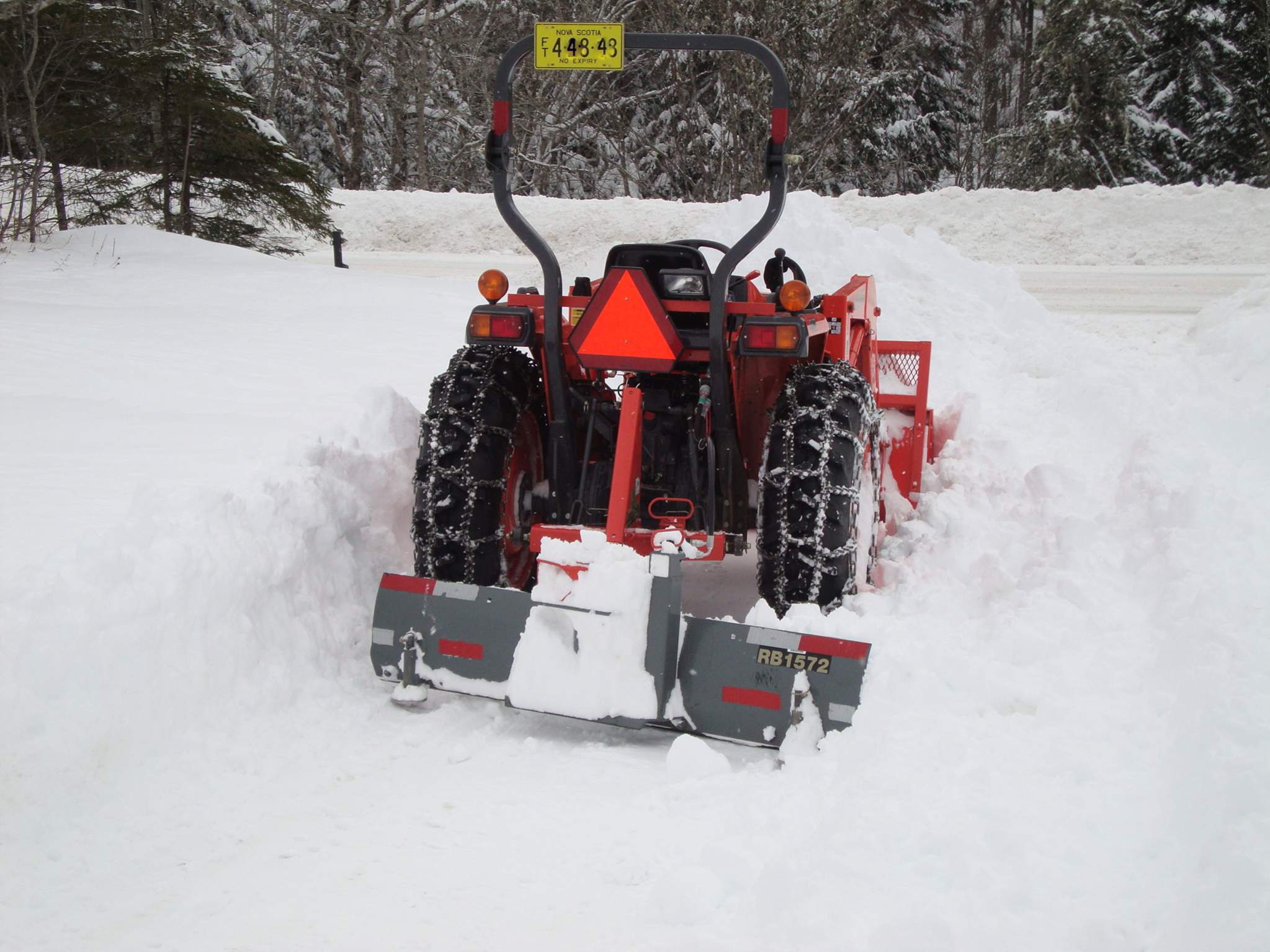

A rear blade with power angle and skid shoes (since you now have rear remotes !) is handy for snow removal, the bucket will do it but it's not that neat and tidy, neither is it efficient. I don't have a box blade, so I can't comment on them. If you do get a rear blade, get at least a 7 footer, an 8 would be better for snow. Mine is a 6, a seven would have been better, but used + cheap = mine.. The reason is, you want to be able to "wing" the snow back to each side with the blade angled while still staying on the roadway. Snow has a habit of piling up then tumbling back into the path you just cleared. I offset my blade to one side (usually the right) to get the blade as far out there as possible. Hydraulic angle control is a Godsend, no more hopping on and off all day in the winter.

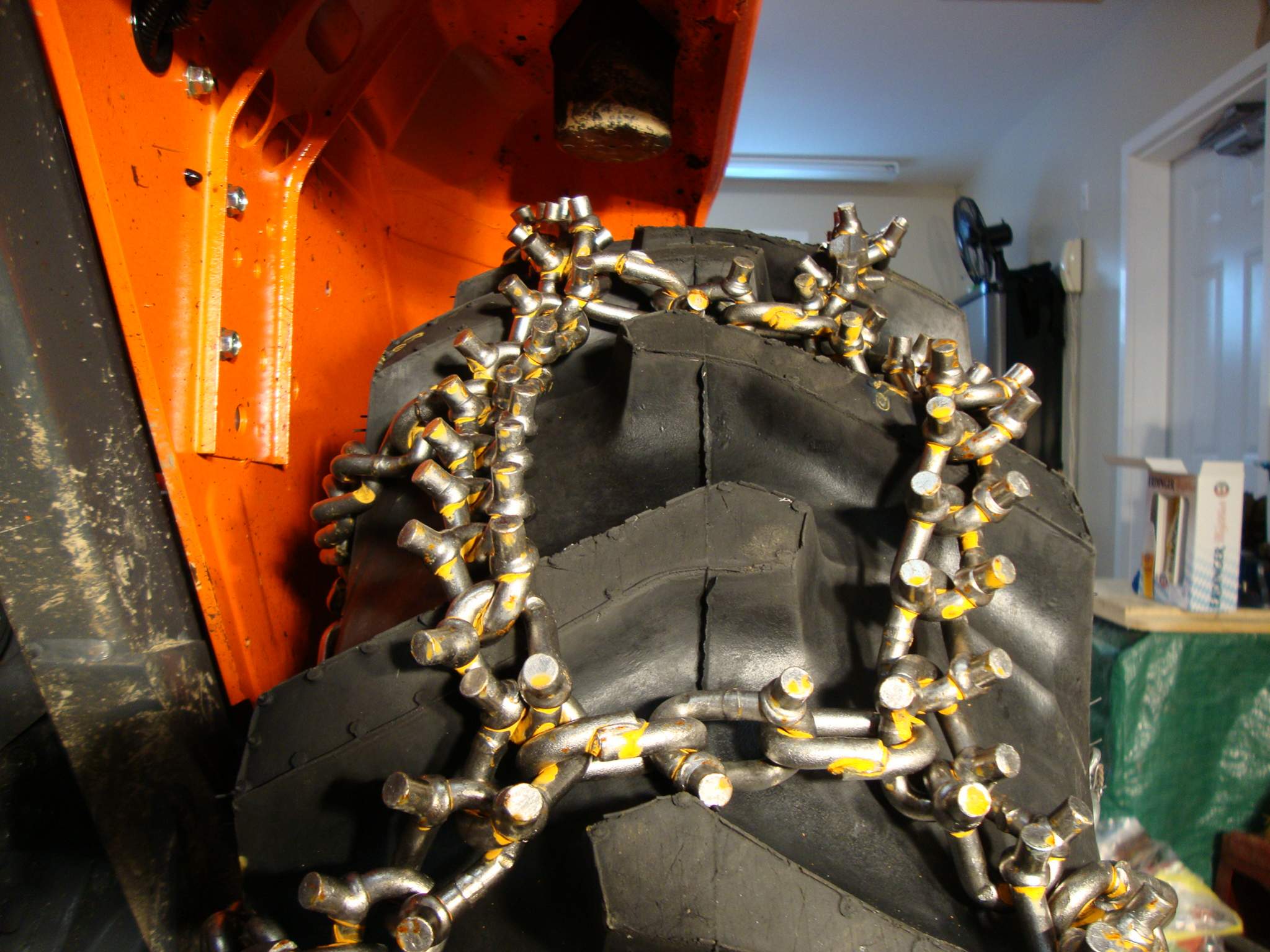

And finally, tire chains.. you're probably going to want them for the rears at least. If you don't have asphalt driveways, these are the cat's azz for around the woods, fields, gravel drive etc on ice or in snow.. made by Tellefsdal, sold in the US and Canada as either Norse Super Tractor or Aquiline Talons. Pricey, but you really do get what you pay for.
