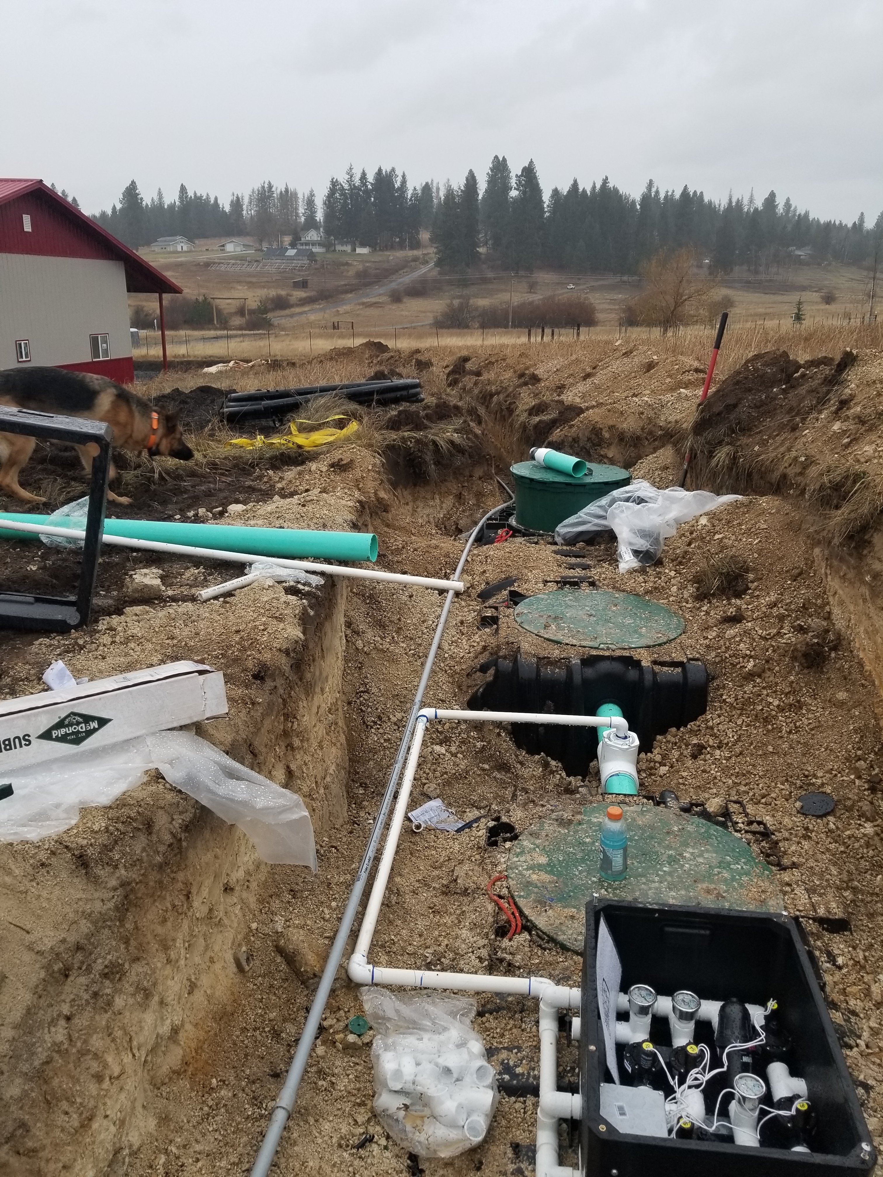

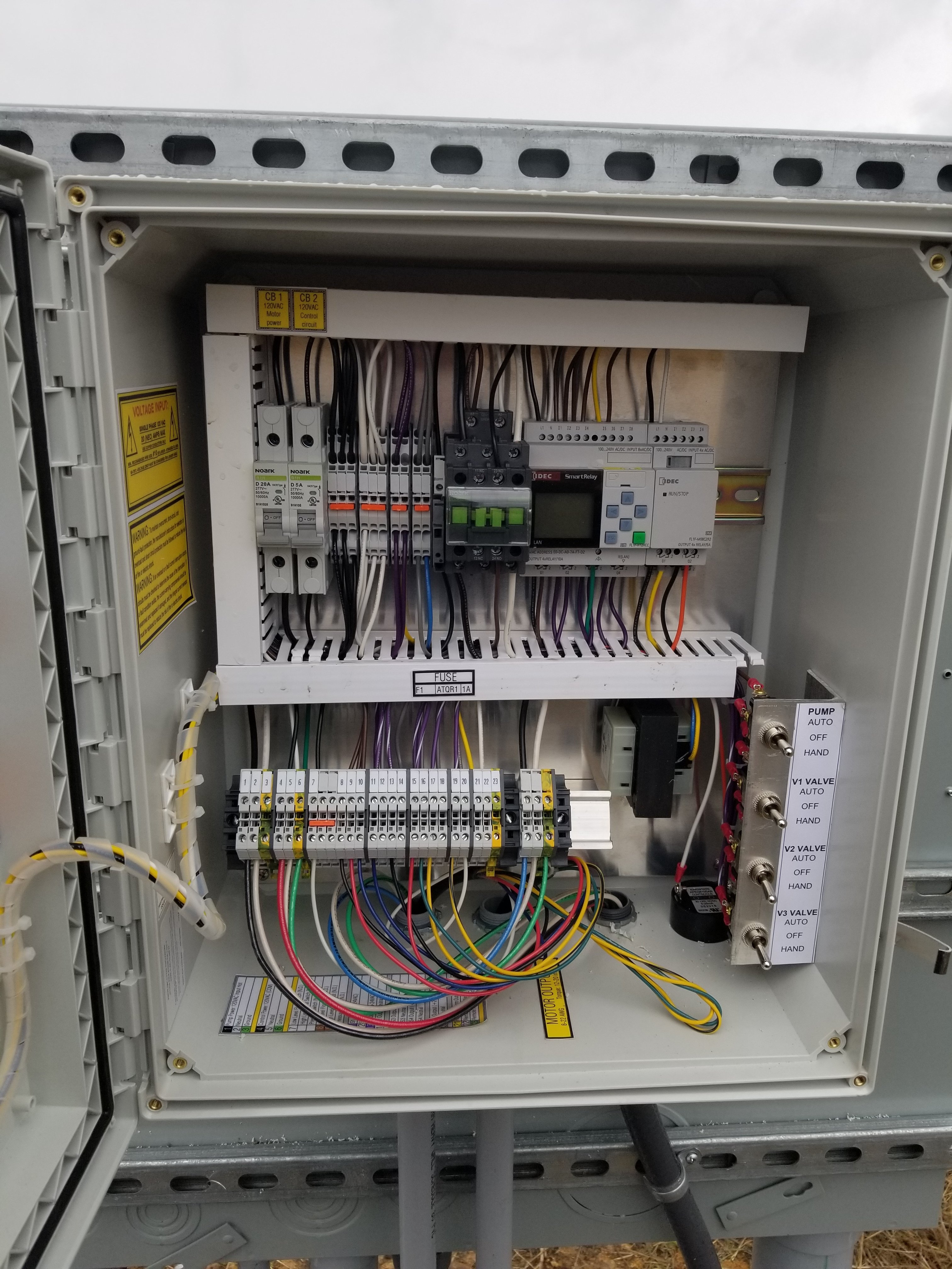

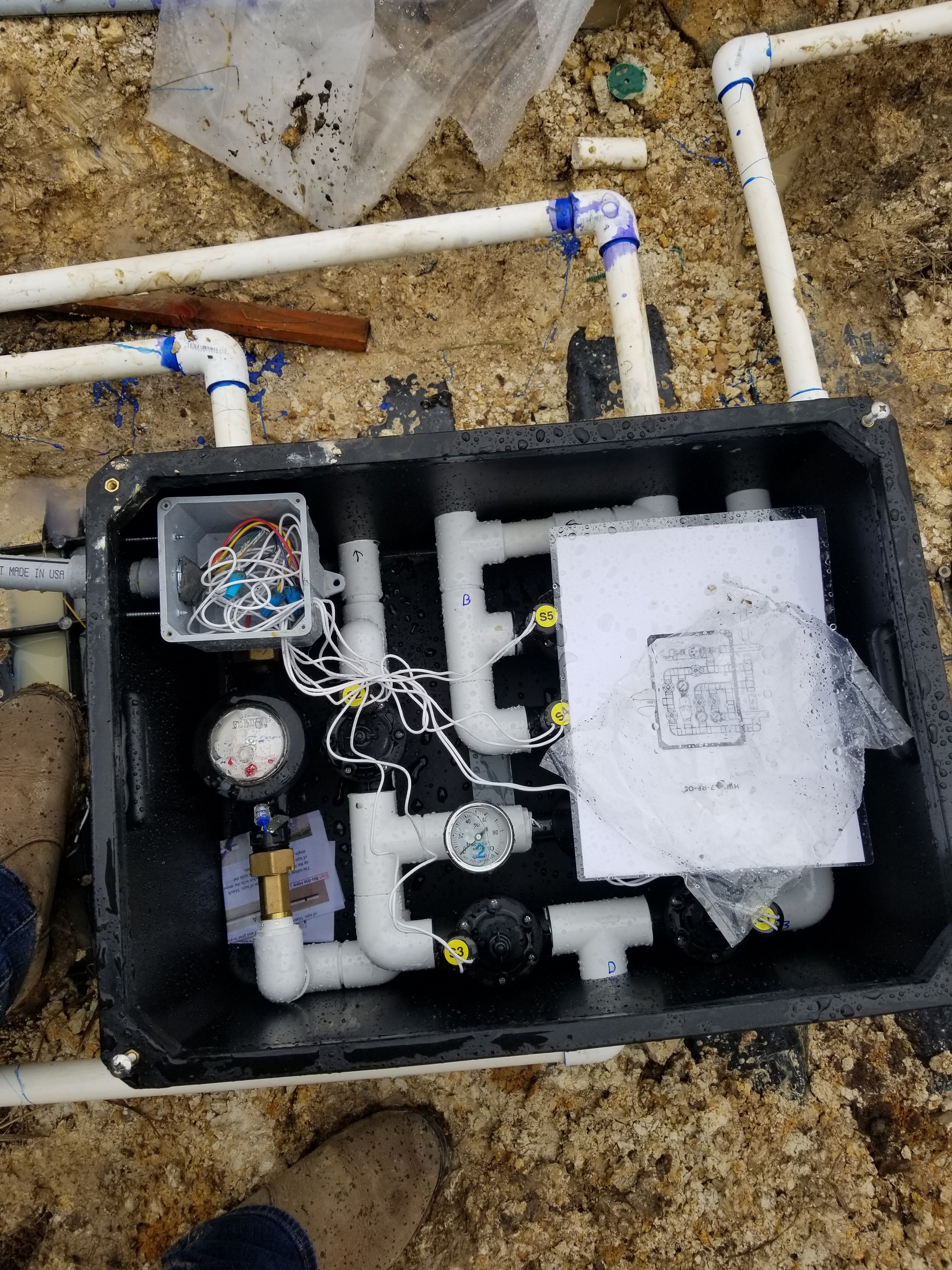

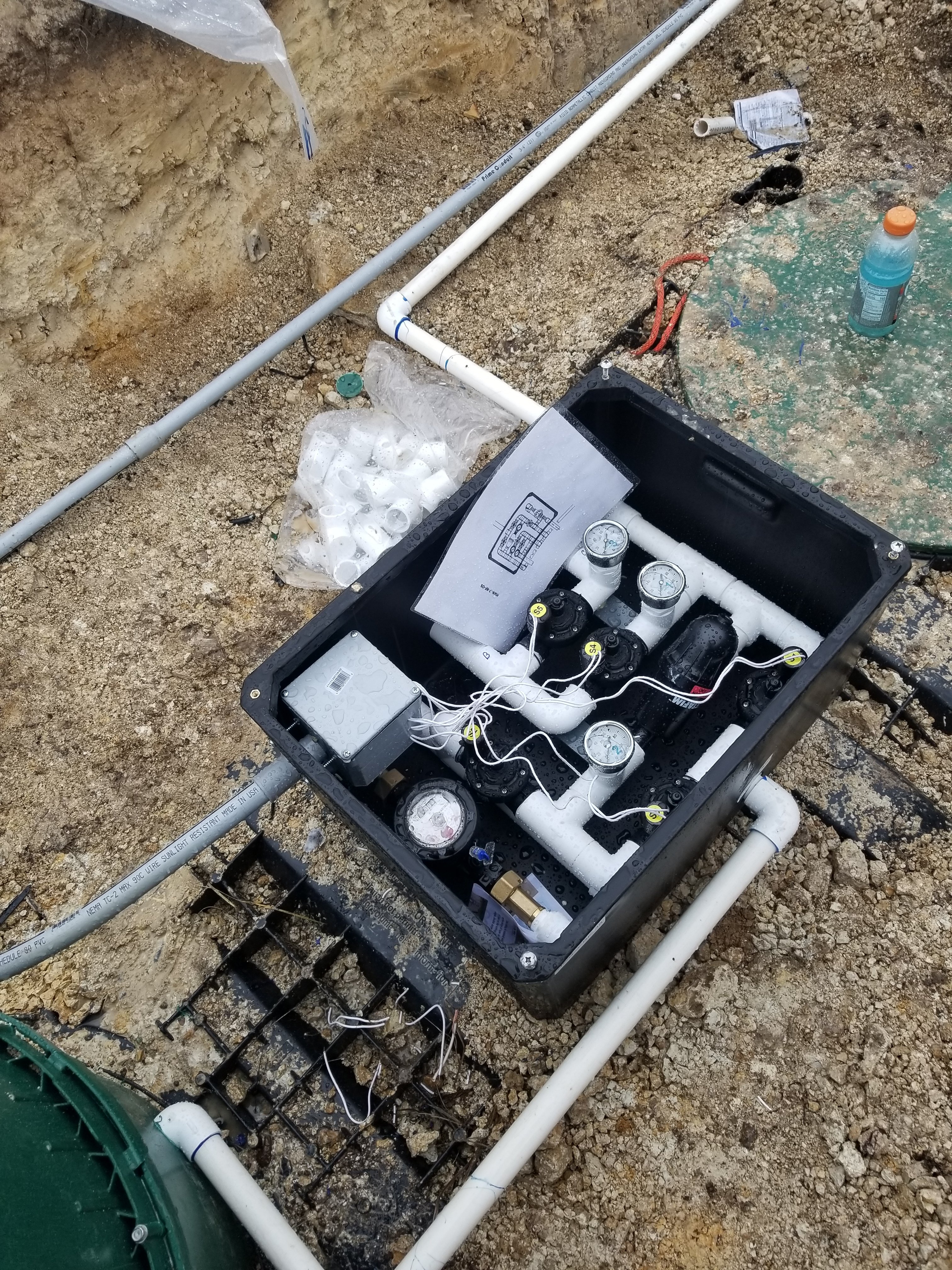

Those are simple septic systems……how about this nightmare
I wire in some hideously nasty systems near the lake.

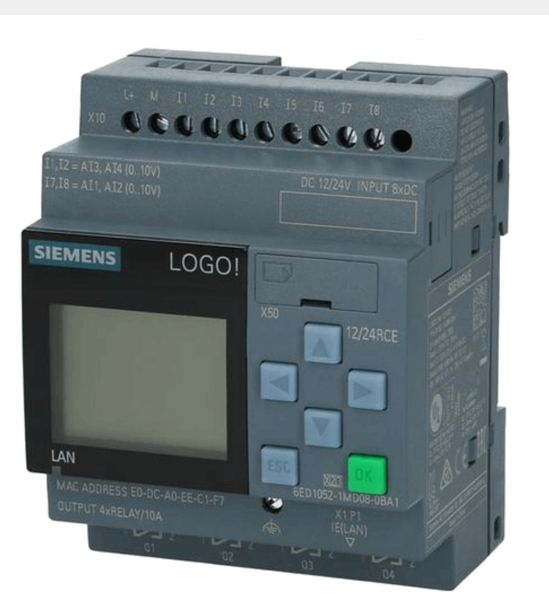

That Idec PLC in your cabinet seems to be a Siemens Logo!. I wonder if they can share software. Looks physically identical
