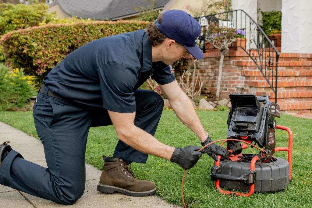

Those inspection cameras are amazing, and I wouldn't let someone work on a leach field without one. You can see the issue, know where to dig, or where to hydrotreat.
All the best, Peter
   / Buying House with Septic System #93
If you have ever been around either sanitary or storm sewer camera inspection; step one is a hydro vacuum and jet clean, so that you can actually see what your looking at. You dont "swim" them.
Ive been around the smaller ones, with what appears to be an oversized Phish tape role, and a push camera; virtual identical to your cheap automatic endoscope, and the larger ones are often track drive, and only work in 8"+ pipe; but give exact footage, 360 degree, with zoom, and even gap measuring.
Im not saying it can't be done; but the stuff ive seen; you would need to pump and jet clean; go into the tank, remove the exit riser, and feed the camera in; if you dont have an accessible junction box. If you have an accesable junction box, you would still need the system pumped, and they wouldn't work in the drain field if holding water.
All the best, Peter
Unless you know something I dont (entirely possible), thats great for the drain lines from house to septic, or in a sewer system, house to manhole/grinder pump; but of no use in a septic tank, that is always full
Yes, my comment was directed to pipes, not tanks. I've seen inspections done on four inch pipes more than a few times and once on a three inch line (80 year old pipe, with a 0.5% slope).
Cameras are a reason why I try to use sweeps, rather than 90 degree elbows on lines that I think might need inspecting in their lifetimes.
