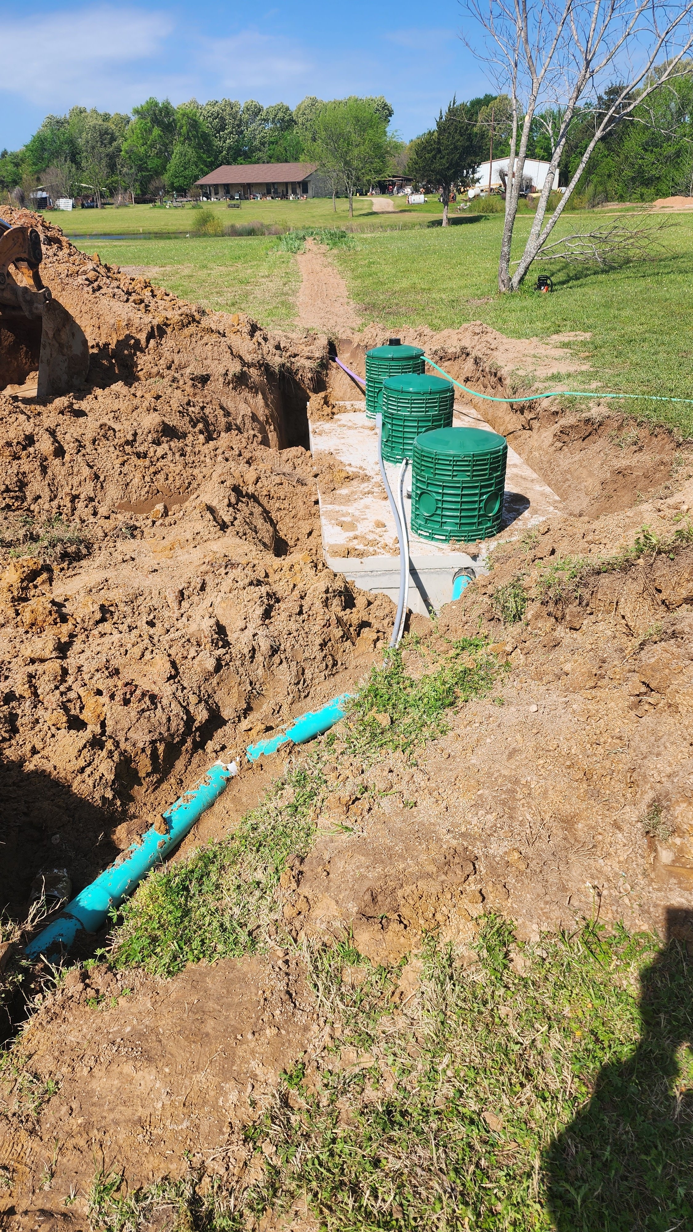

A few years ago I had a riser put in over my tank. Septic guy had been suggesting it for years. The older I get, the less appealing it became to dig down to the lid, then refill & replant grass. Not something you'd need to worry about, but I'd been hesitant to do so thinking the tank might freeze in winter, but so far no problems.
No more digging, and always easy to tell right where the tank is. Wife puts a birdbath on top of the lid.
