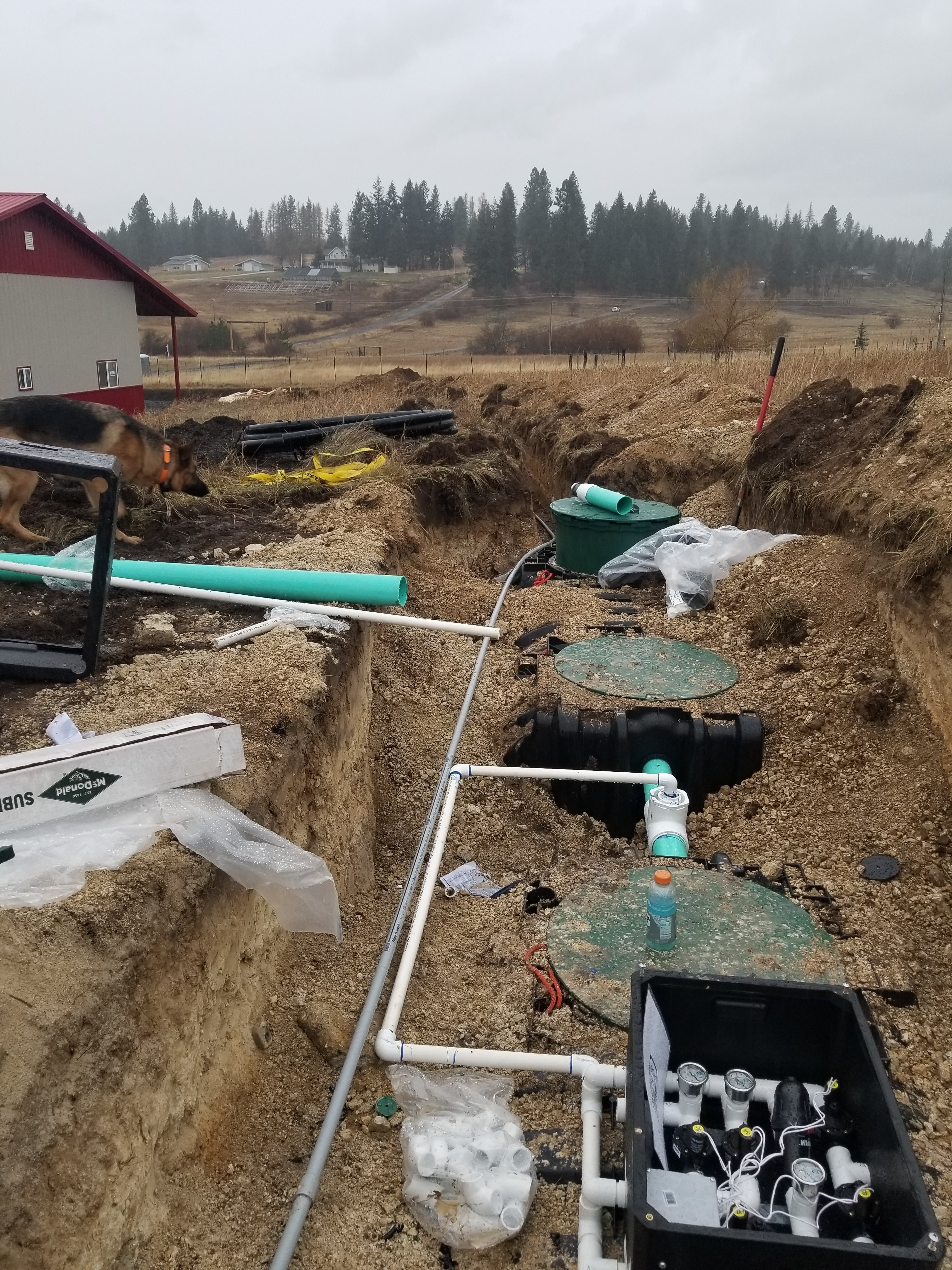

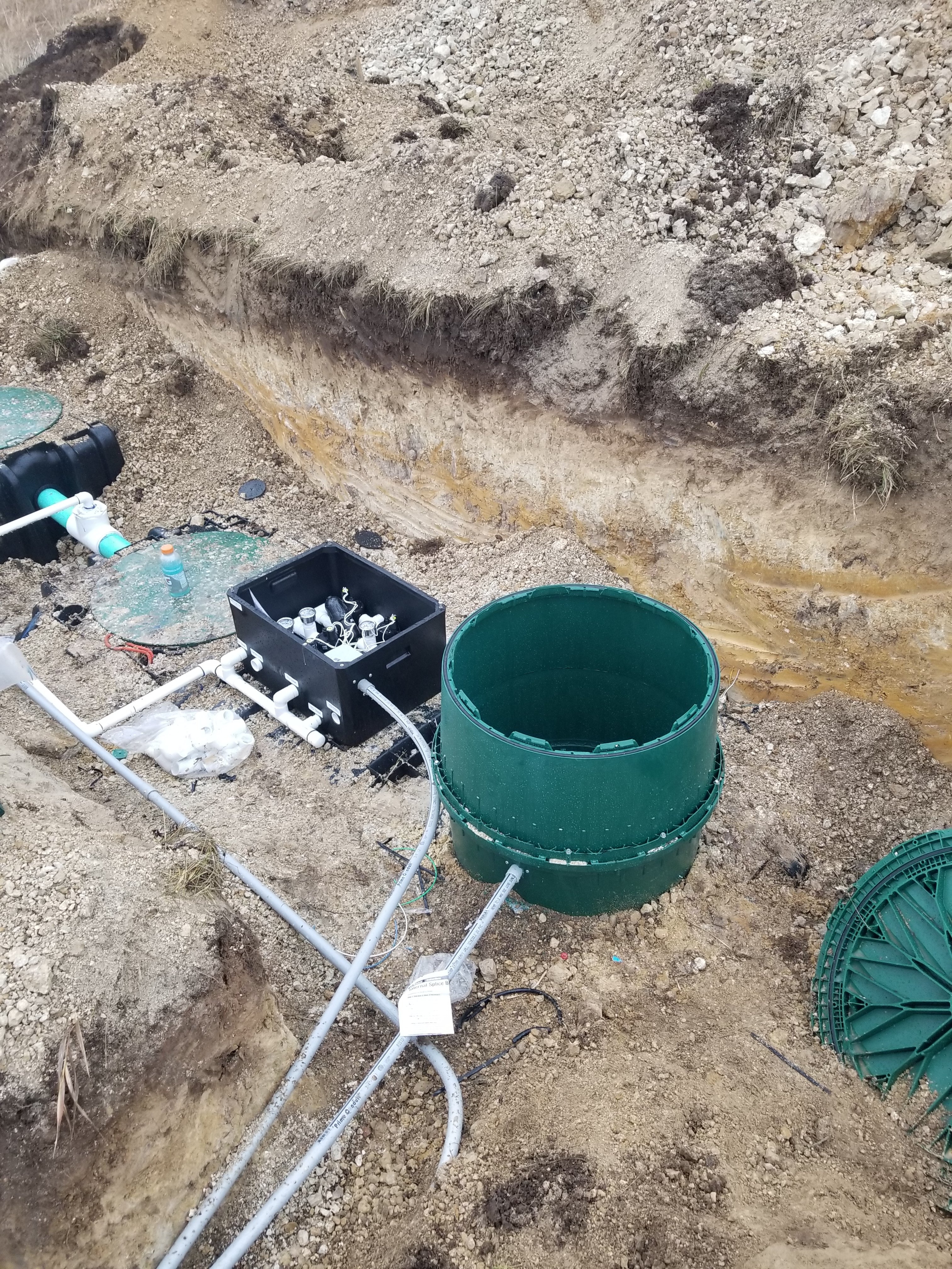

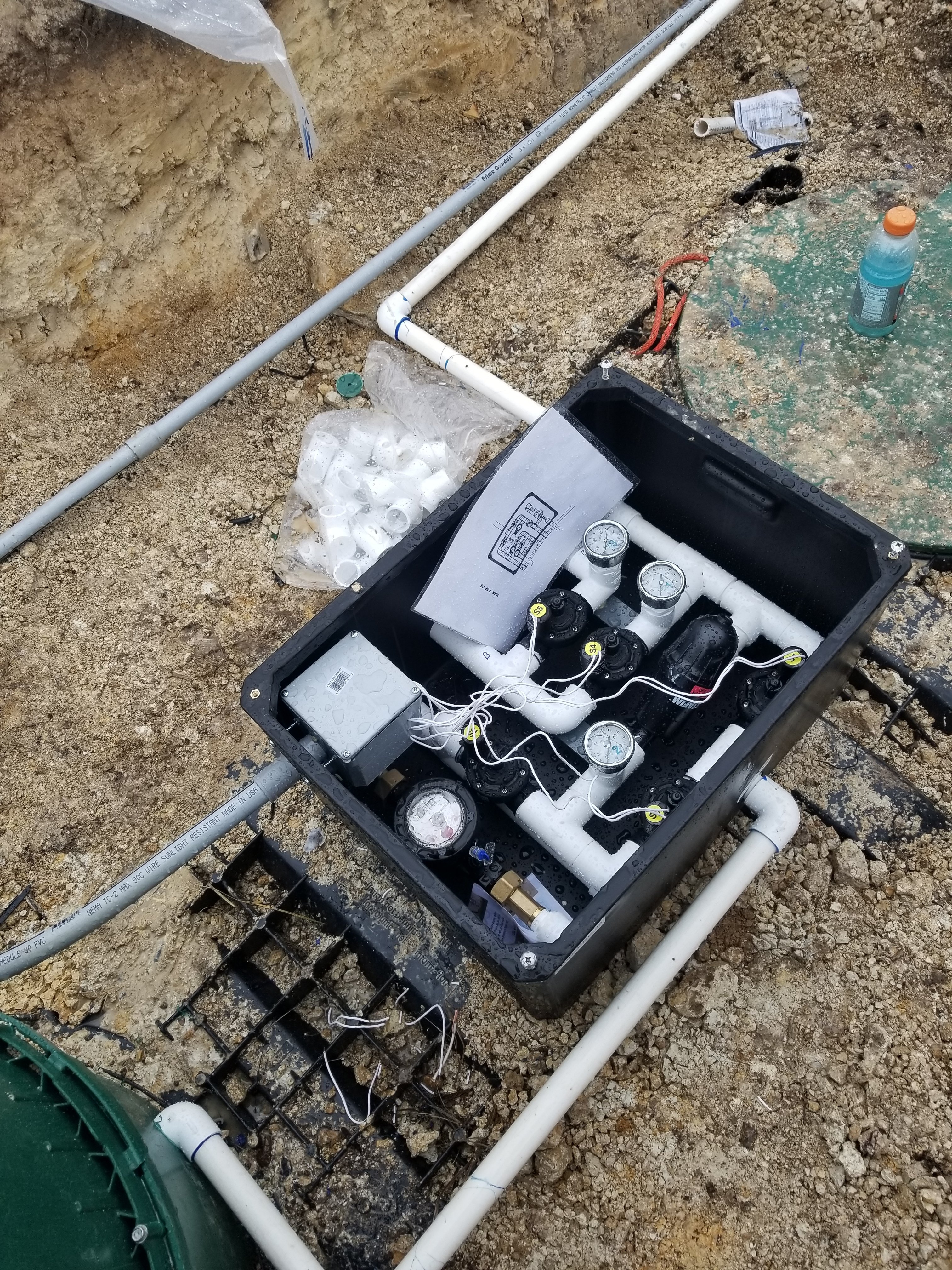

Those are simple septic systems……how about this nightmare
I wire in some hideously nasty systems near the lake.
