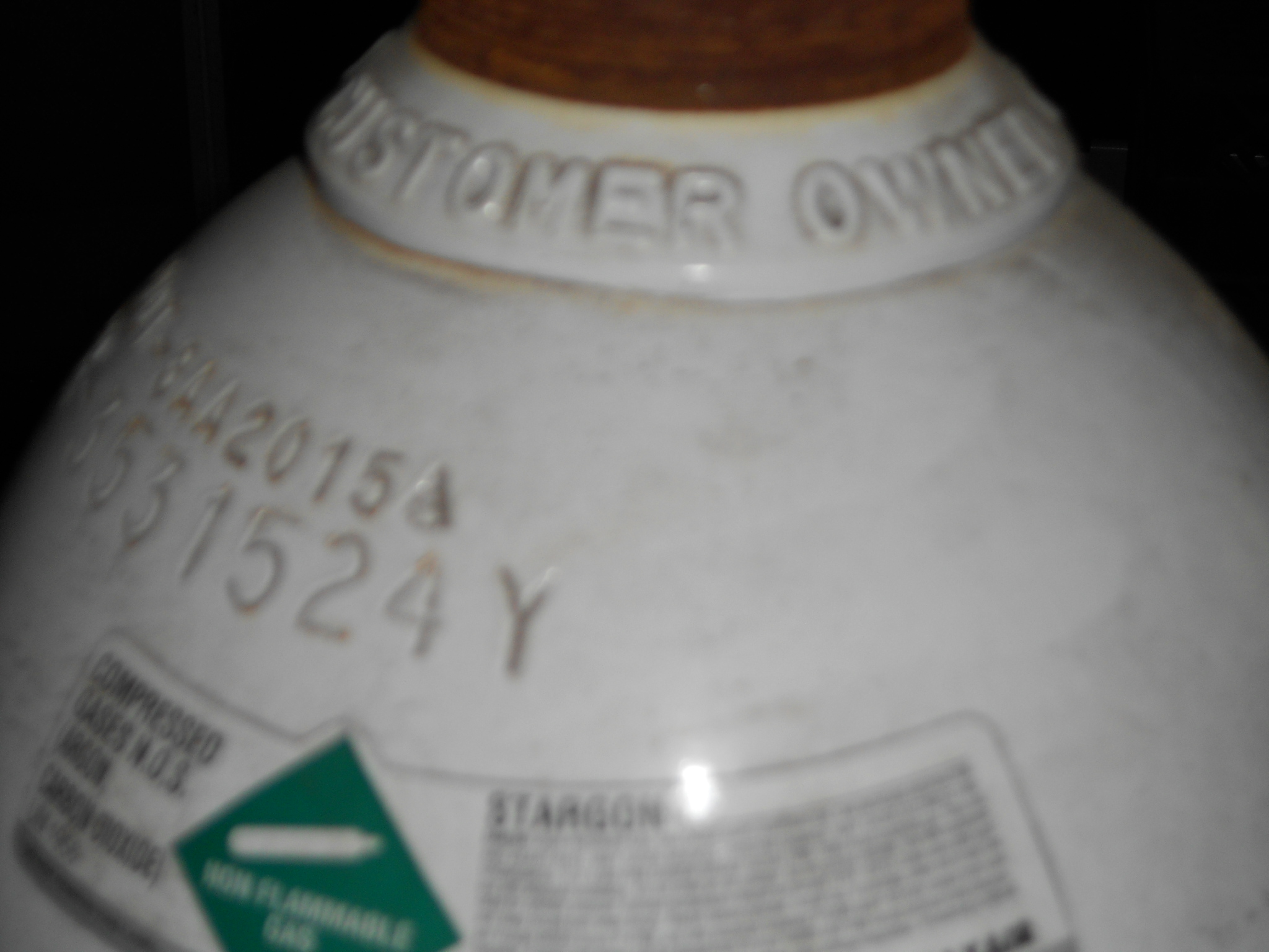

My cylinders have "customer owned" embossed near the neck. Without it they will not fill them. They have an exchange program so you drop off the current cylinder they just swap it for a full one. By doing so you never have to worry about paying for a hydro test. The problem is that none of the gas places around here have anything larger than a "L" so your limited to 122 CuFt. The larger bottles that don't get returned to the gas companies usually have the bottom cut off and become wind chimes.

Here is what you want to see. I won't even consider a cylinder without it!
