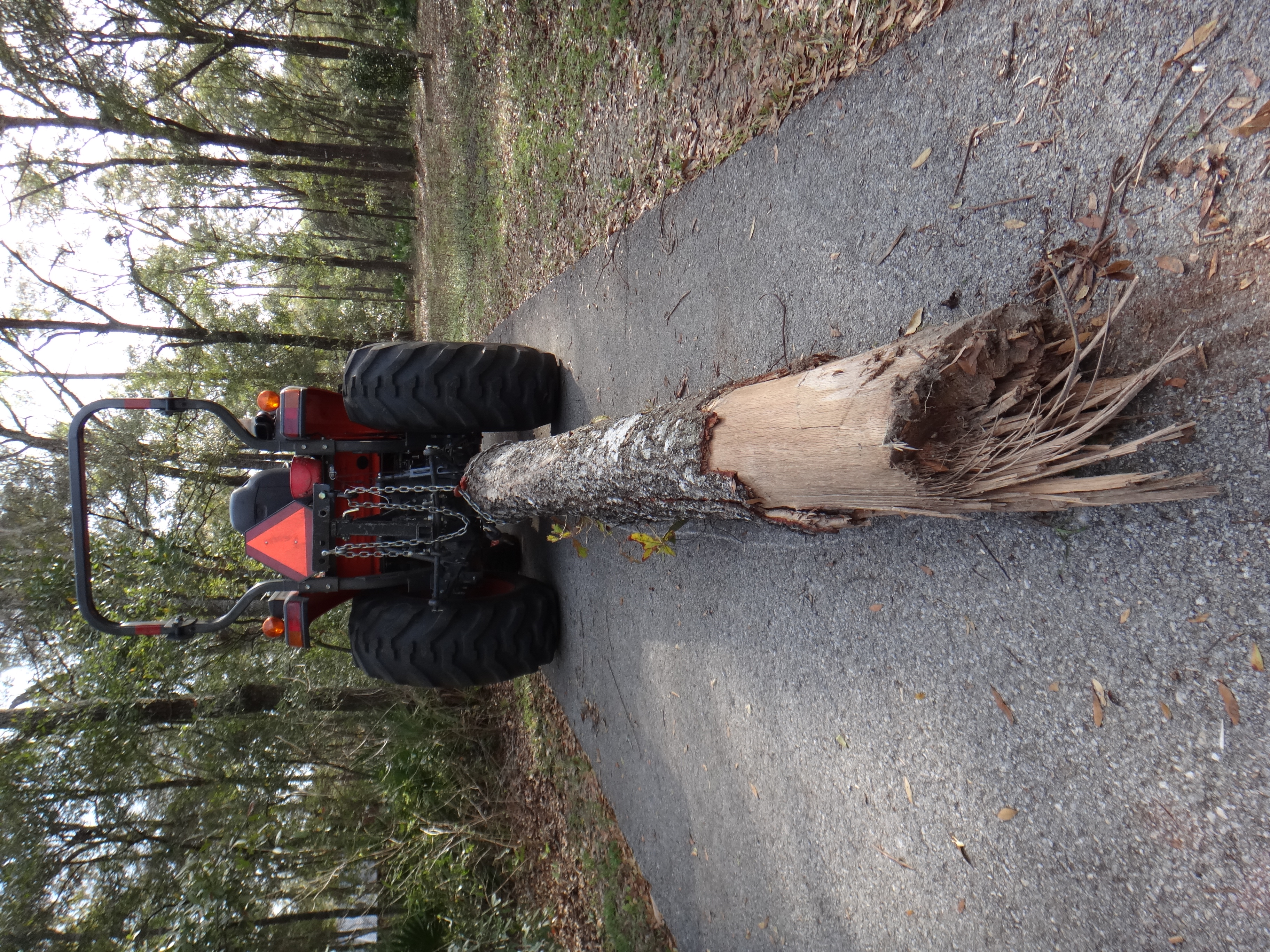

Tractors are geared low to PULL. Large rear wheels increase the ability to PULL. You will have no difficulty skidding heavy logs in 4-WD. With <25-horsepower, 2,700 pounds bare tractor weight and filled rear tires you will not lose traction under any 'normal' conditions.

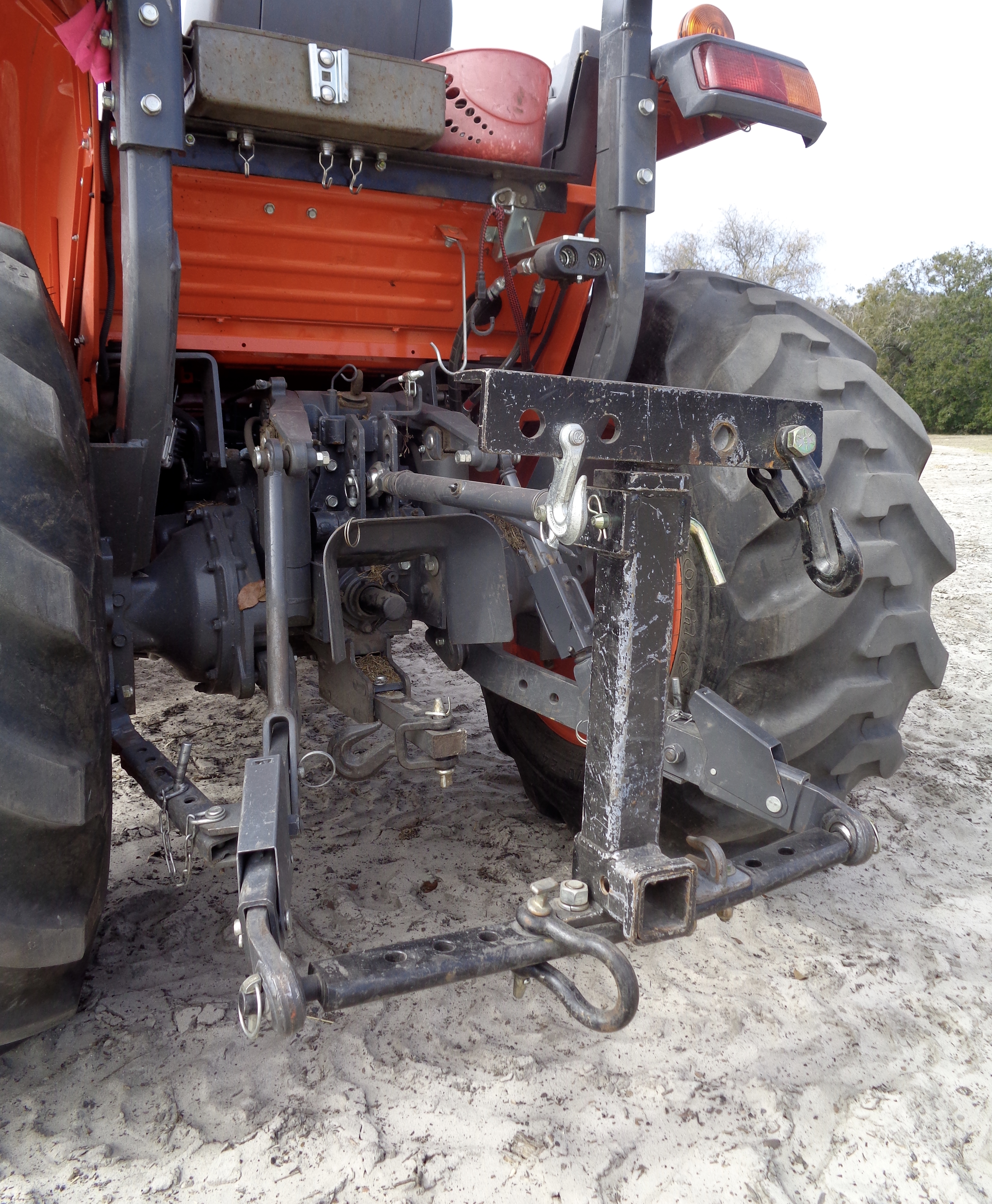

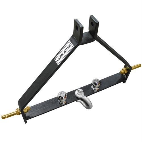

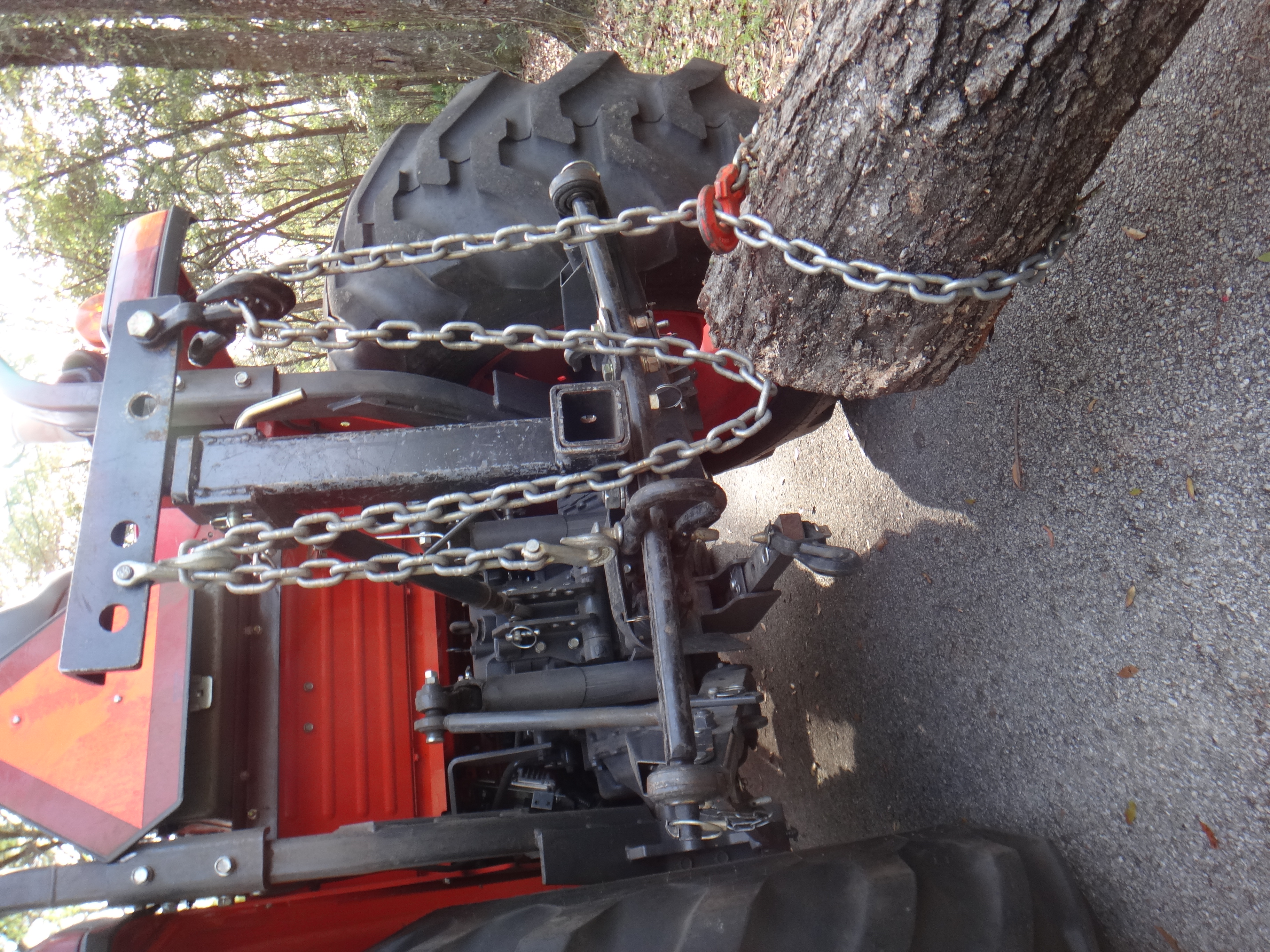

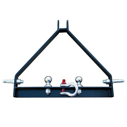

You need a Three Point Hitch cross-drawbar to elevate logs slightly at the tractor, to keep logs fairly clean when skidding. Dirt dulls chainsaw saw chains in seconds. Less power is required to pull logs when entire length is not creating friction in ground contact. Slight elevation prevents logging chain abrasion against hard surface roads.
