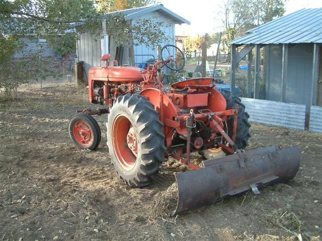

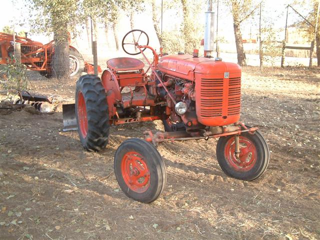

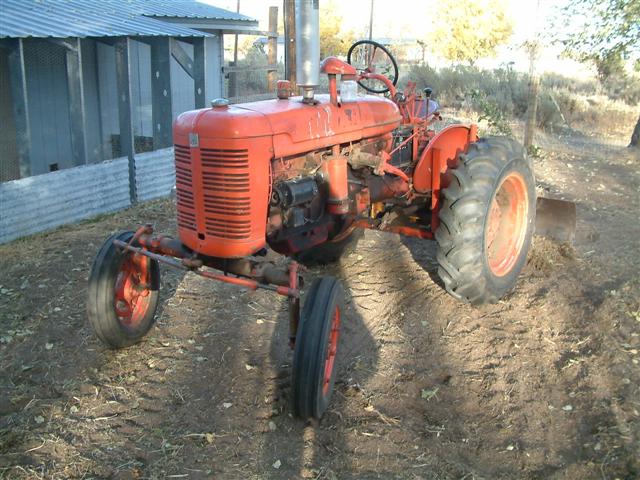

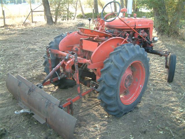

For row crops, consider something like my 1951 Farmall Super A which is the right size and has the implements for that kind of farming. Since you like old iron, this may be an attractive choice.
I found this one locally on craigslist. Price: $1300 including a 3pt hitch, back blade and a mid-mount 6-ft sicklebar mower.

Sweet Farmall Flusher ! You lucked out on that deal man.
