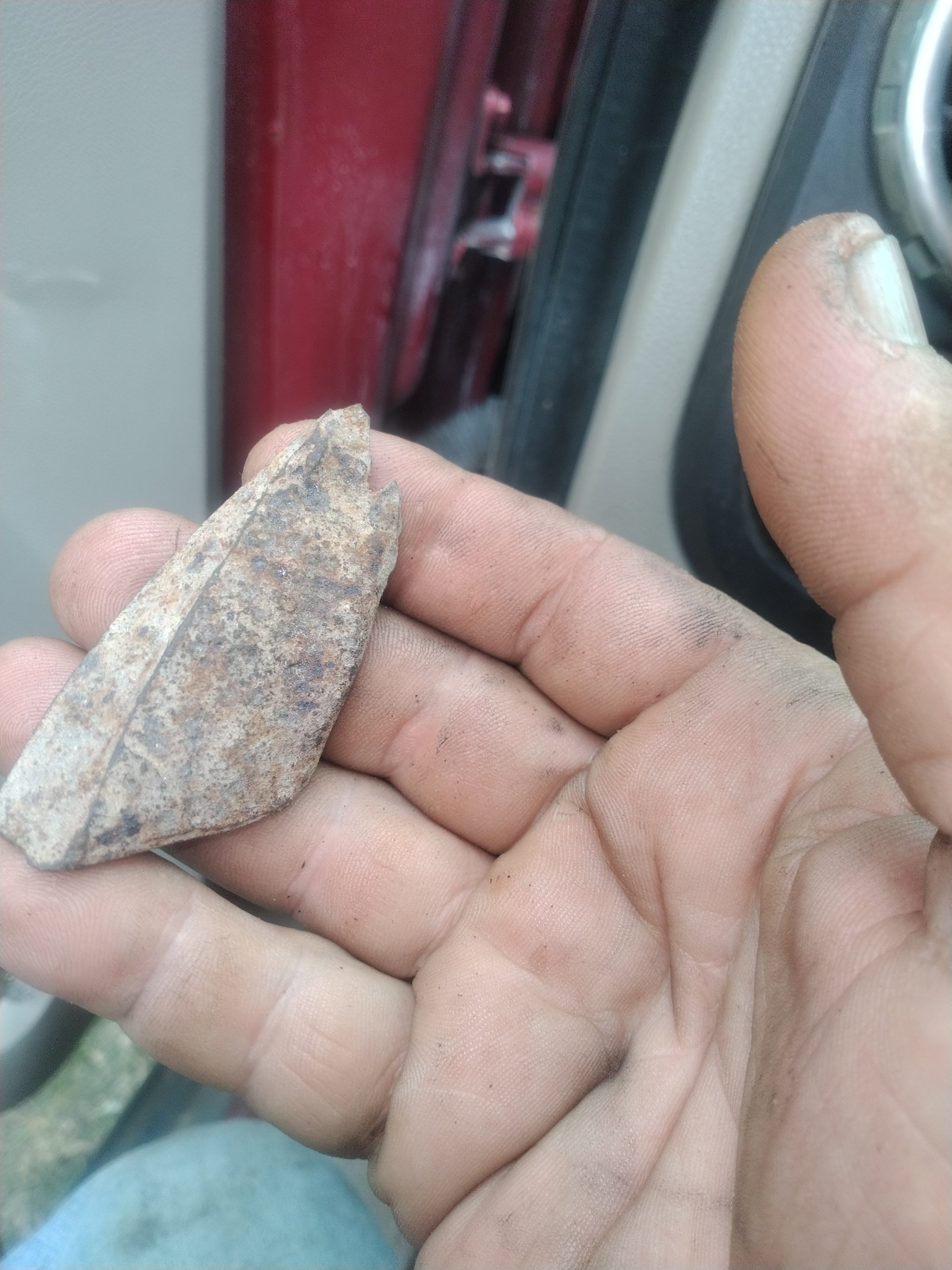

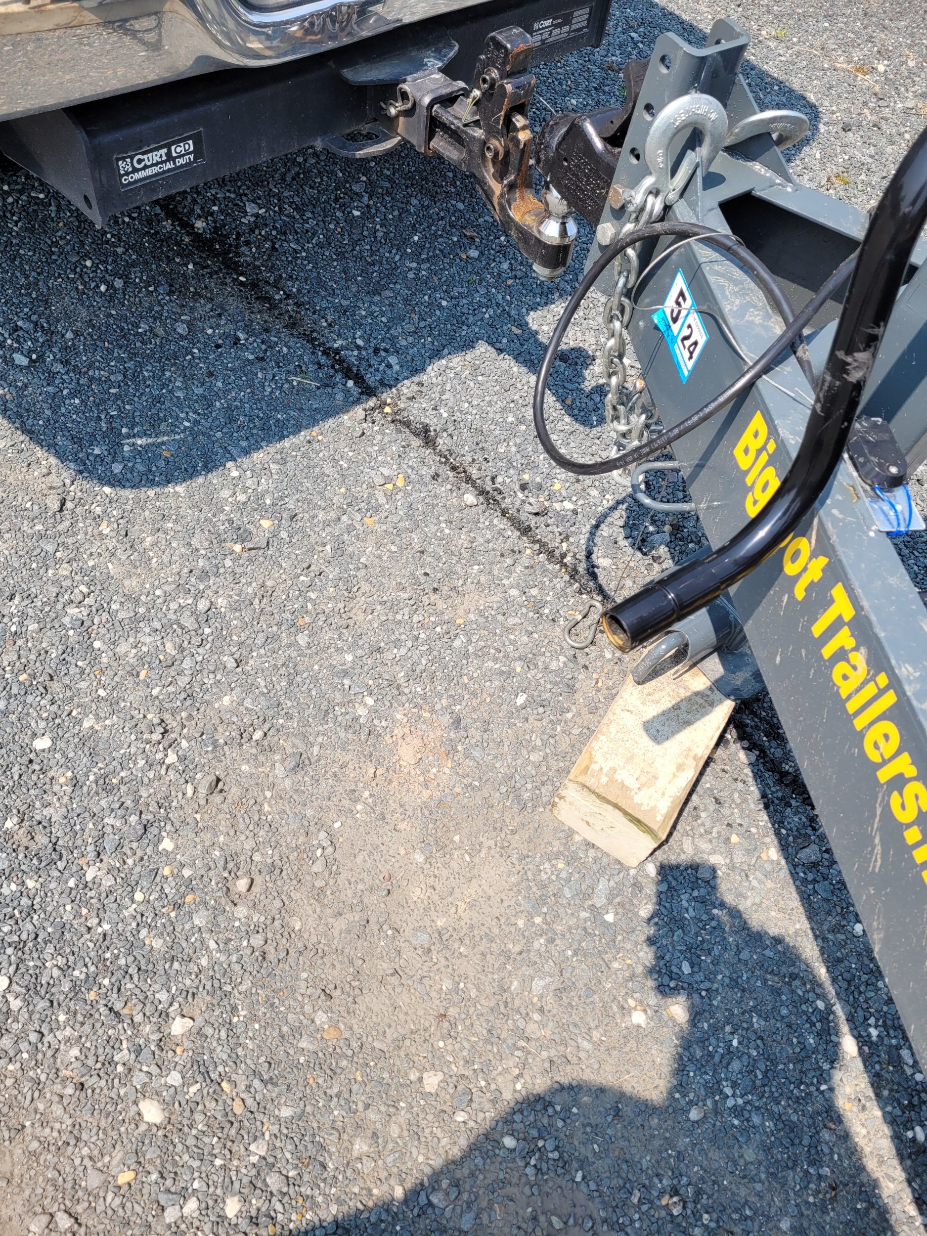

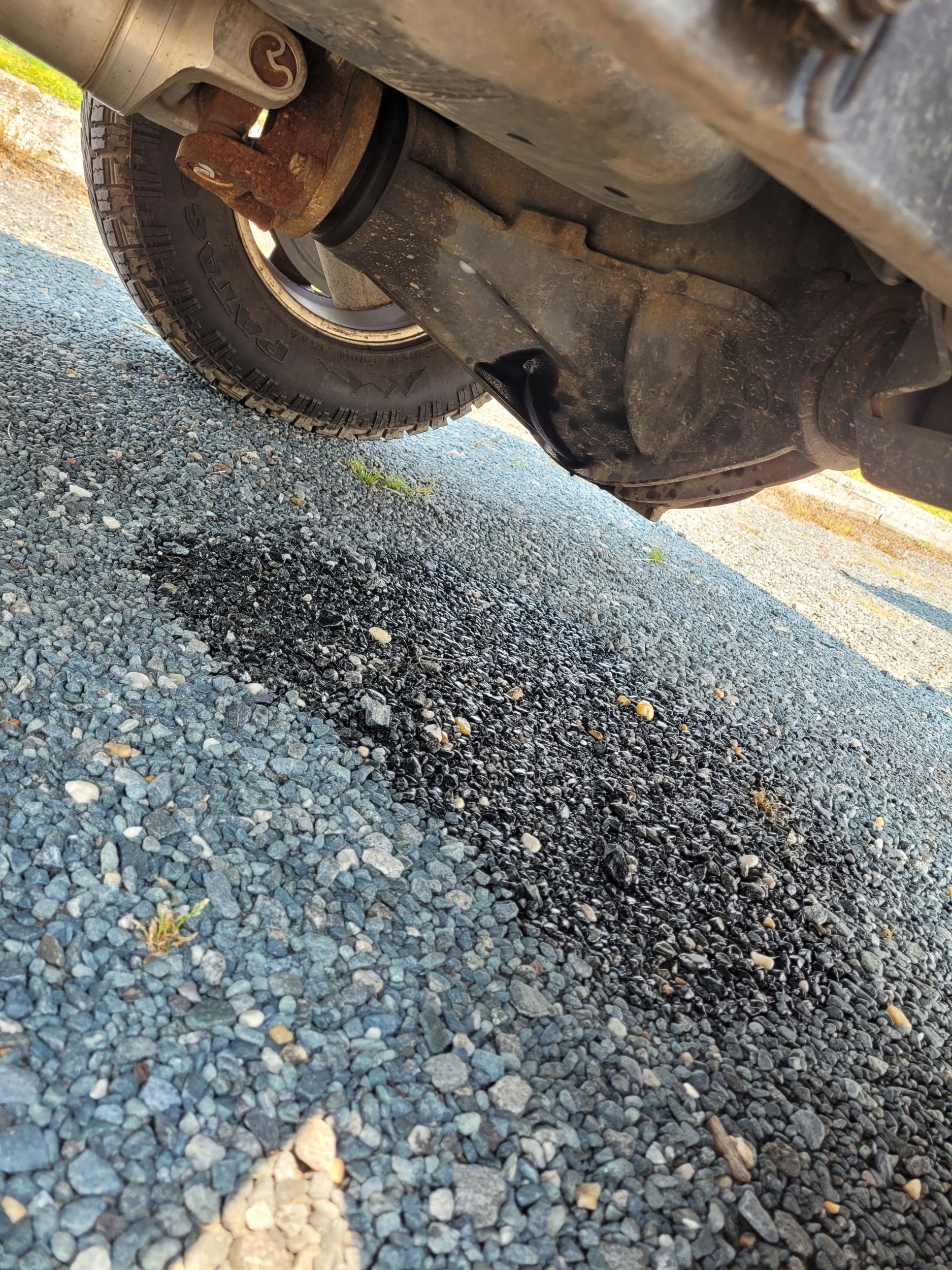

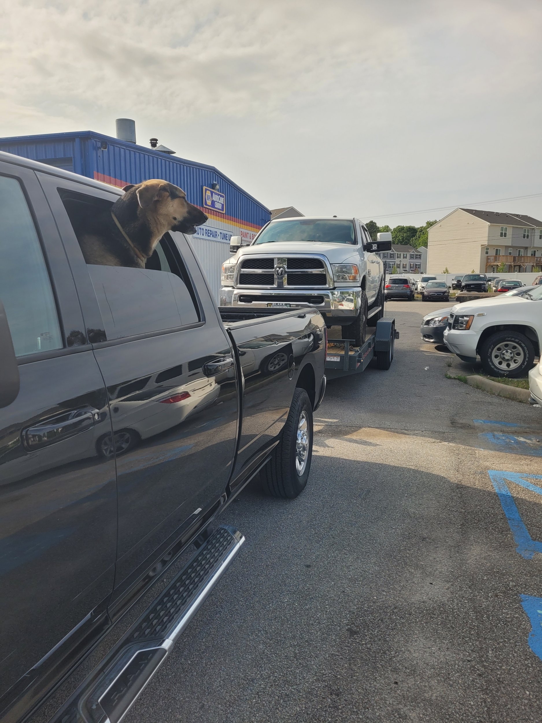

I was towing the excavator 3 hours away to a job I'll be working on for a month and a half. About half way there rolling along 60mph with cruise on, see a red light ahead and tap the brake to start coasting to a stop the hear a pop from the rear.
Press go pedal and it just revs,(with some clunking from rear) no drive. Stop at light and no go, put it in 4wd and drove into parking lot. Look under truck and diff fluid is pouring out, gear busted a hole in the casing.
Replacing it with reman rear axle with a five year warranty. Luckily I was able to rent a suitable truck(for a month) went back to pick up excavator, take to job site, then picked up broke truck and towed back to shop in my hometown, the picked up plow and hauled to job site. Was a long day was driving and towing stuff/loading unloading from 9am to 11:30pm. Having your own business can be tough but even days like this it's better than working for someone else!View attachment 801418View attachment 801419View attachment 801420

Sounds like there must have been some previous off the chart stresses on the housing to weaken it then it just reached its fail point at that moment.
People will hook a chain to the axle housing to pull the truck out of the mud a d give it a jerk. The housing gets a small Crack from the stress and here you are.

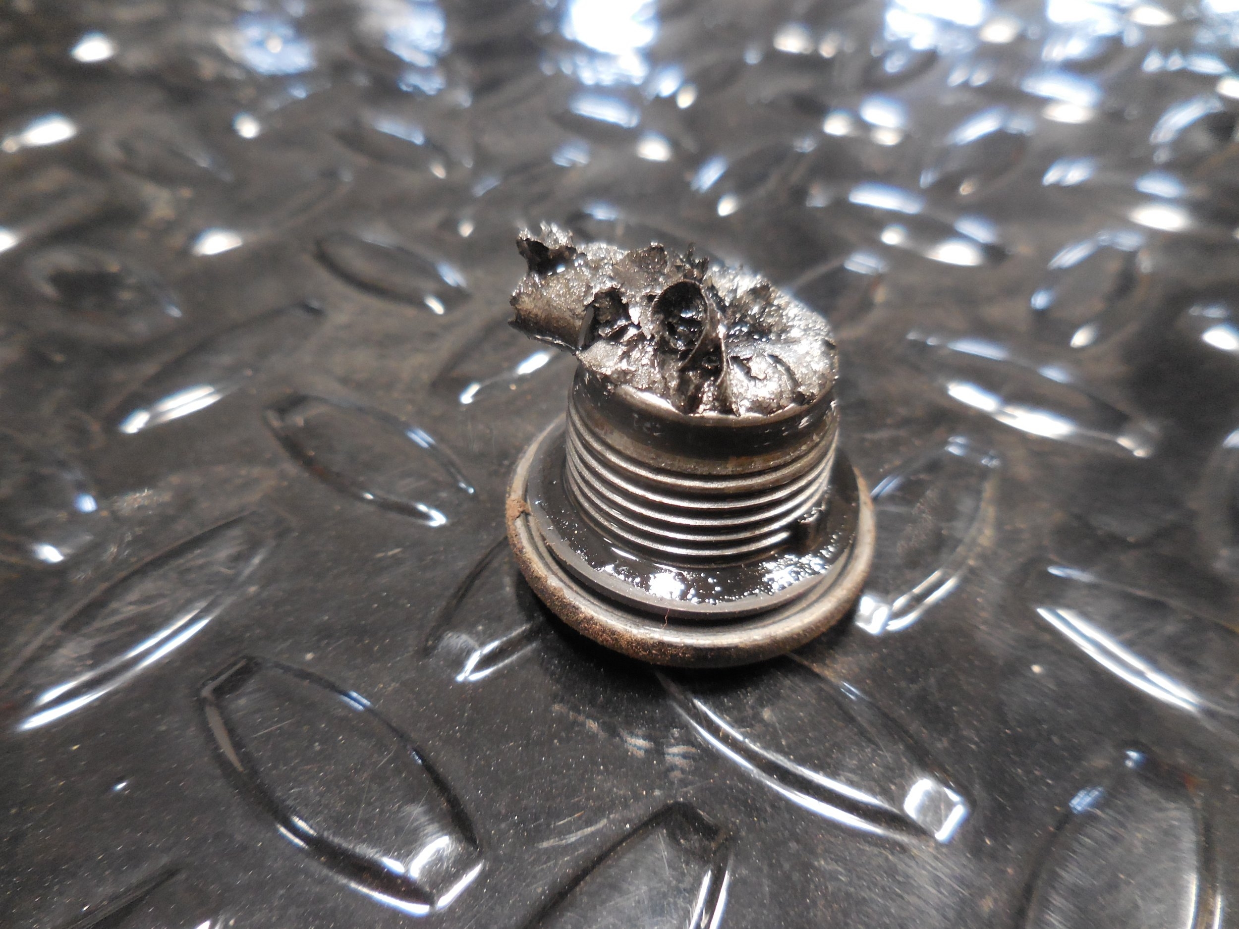

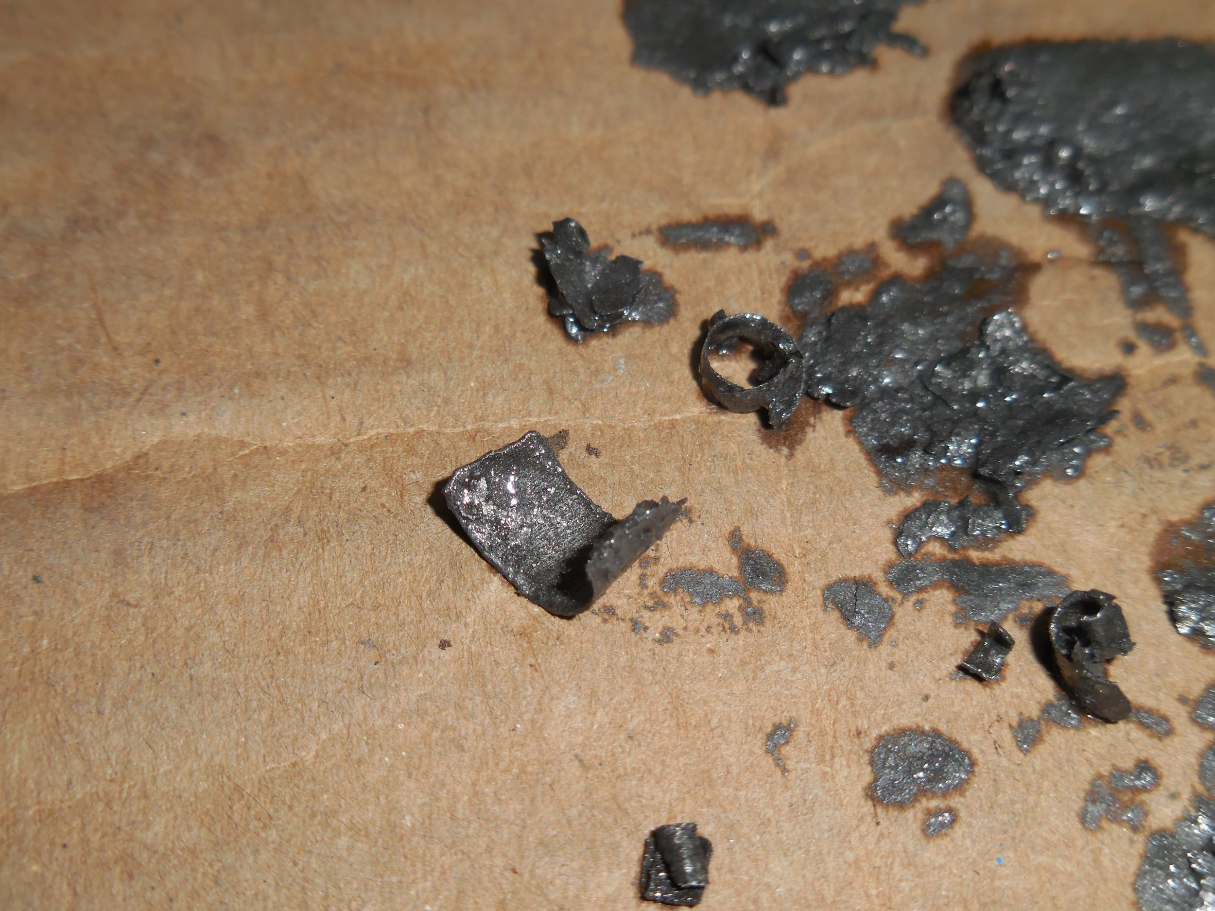

For those who haven't heard of many issues with AAM axles, I've had my fair share. This is what the magnetic plug looked like with about 2,000 miles on it (after careful break-in).
Normally I change the fluid at 500, and sure feel bad about letting this one go so far before doing the initial rinse. The diff is still alive and well, thankfully, after a fewView attachment 802659 fluid changes in rapid succession and many more cleanings of the magnet afterwards.
Also, I wish no axles (that has a removable cover) had drain plugs, forcing people to see how things look inside. View attachment 802661
