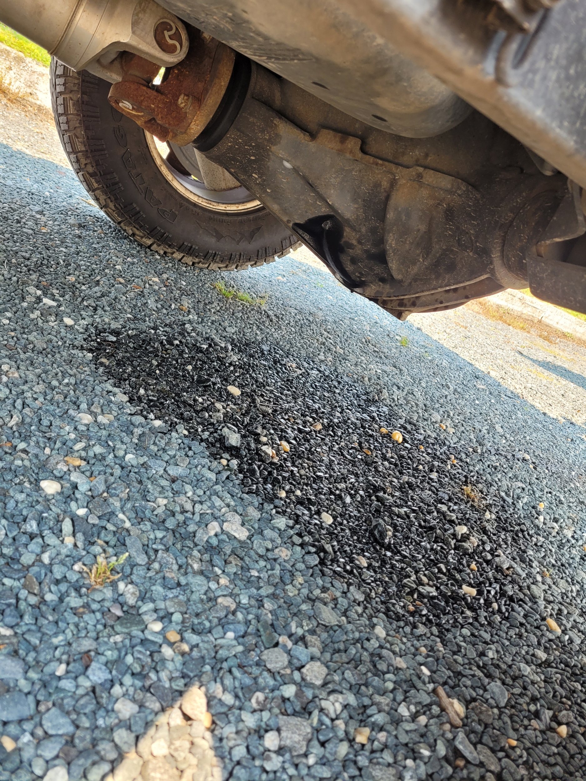

I was towing the excavator 3 hours away to a job I'll be working on for a month and a half. About half way there rolling along 60mph with cruise on, see a red light ahead and tap the brake to start coasting to a stop the hear a pop from the rear.
Press go pedal and it just revs,(with some clunking from rear) no drive. Stop at light and no go, put it in 4wd and drove into parking lot. Look under truck and diff fluid is pouring out, gear busted a hole in the casing.
Replacing it with reman rear axle with a five year warranty. Luckily I was able to rent a suitable truck(for a month) went back to pick up excavator, take to job site, then picked up broke truck and towed back to shop in my hometown, the picked up plow and hauled to job site. Was a long day was driving and towing stuff/loading unloading from 9am to 11:30pm. Having your own business can be tough but even days like this it's better than working for someone else!View attachment 801418View attachment 801419View attachment 801420

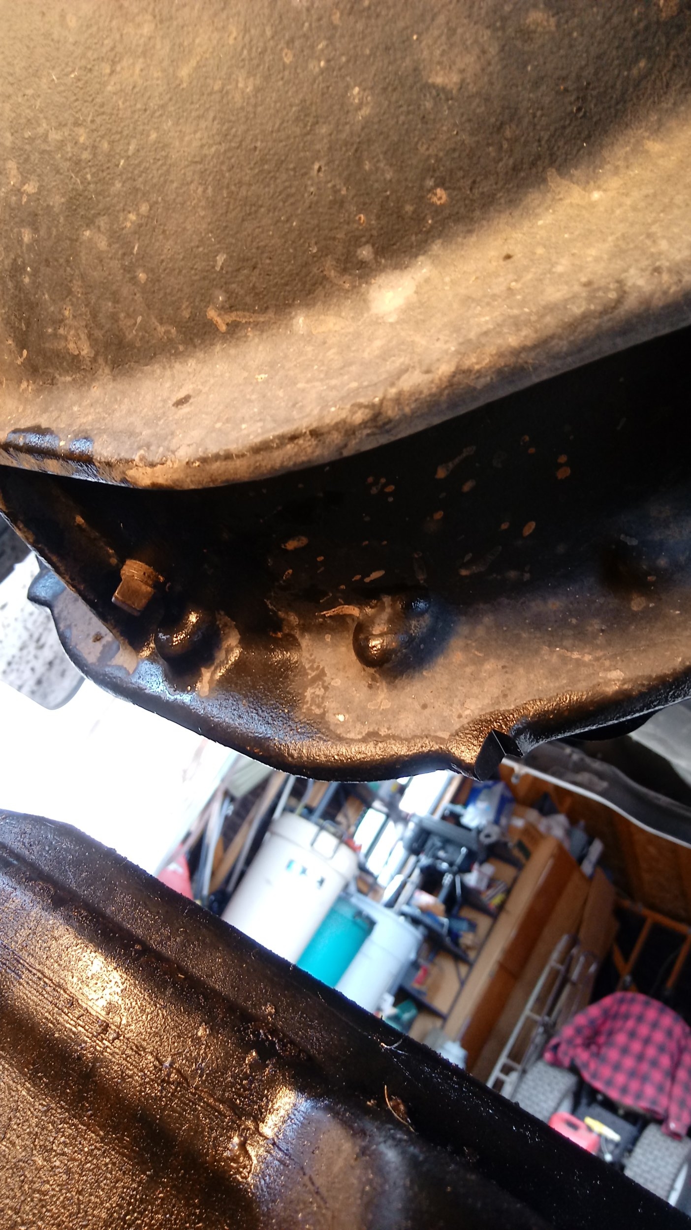

I've found the problem on those. I put a new ring and pinion, didn't bust the case. You didn't do anything to cause this. What I have found is some extra pieces in there from the factory. There is a little pocket in the diff that stays full of oil, thrown off the top of ring gear. Pinion has a slinger washer on it that runs in the pocket of oil to lube the pinion bearings. I have found good sized rivet looking things in that pocket a few times. They are black, very hard, and laying there loose. If one falls out, breaks your gears. If a piece of gear gets between your gears, breaks the housing. Don't worry about all them special hitches. Used to, if I crossed the scales and weighed less than 50,000# I was in trouble. Still have the truck, still going fine. 2002 model truck. I knew I had a piece of broke Dodge ring gear on my tool box.

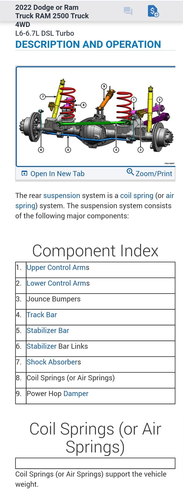

Why should we be forced to pull the cover to change oil? If the magnet is clean?? If it has more metal than normal, then pull the cover. If you want to pull the cover every time, you are more than welcome. It is a real pain to pull the cover on my '21 Ram 2500. The sway bar and track bar are in the way.
