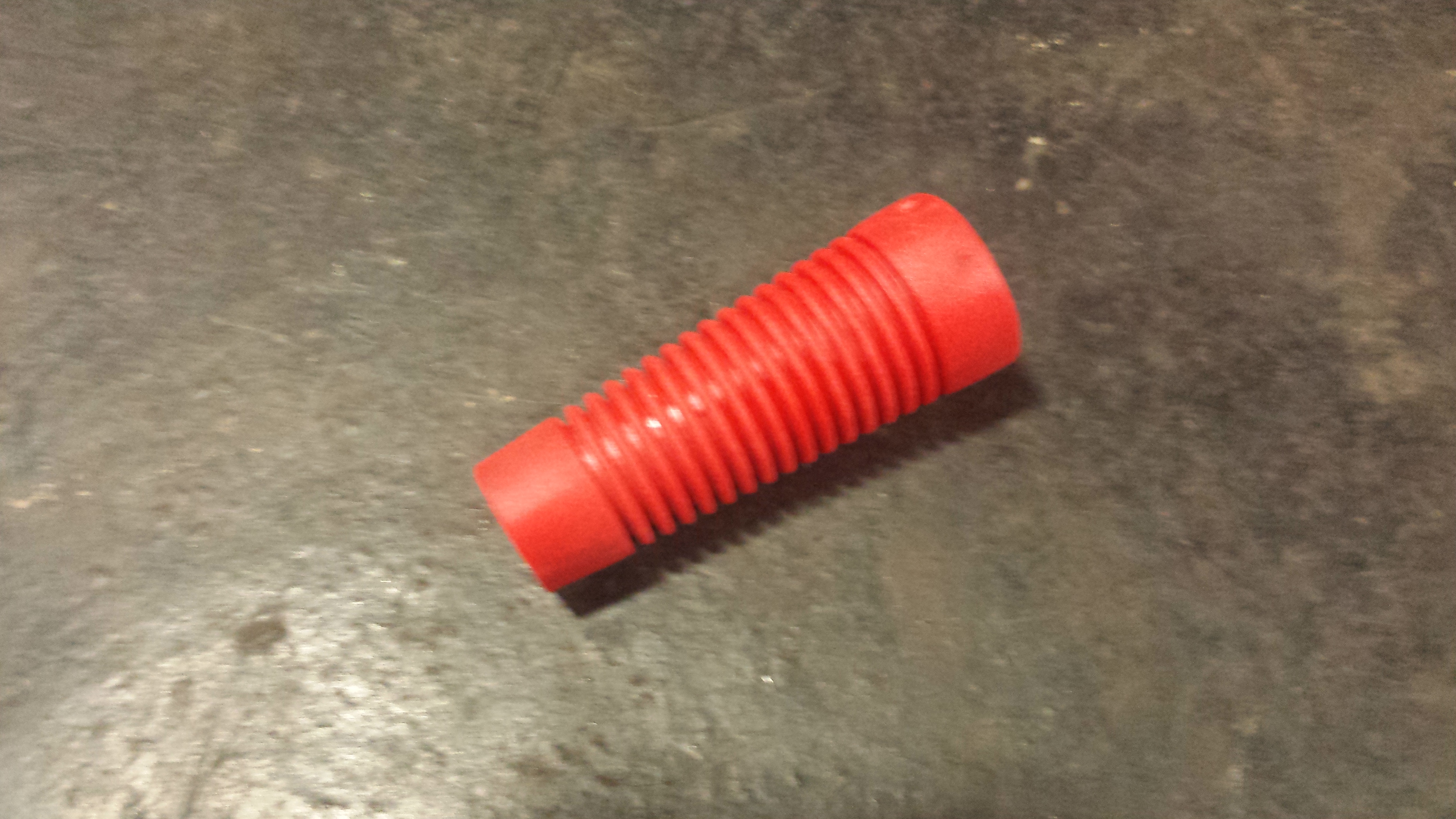

/ Busted cruise control? #19
Ribbed grip, McMaster Carr part number 9692K61. Slpiis tightly over my park brake lever. Now wifey doesn't get mixed up.
