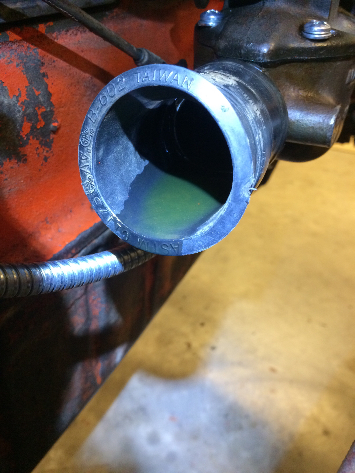

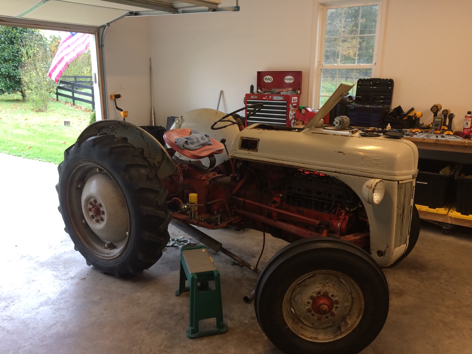

My neighbor and I may have found the problem with the 8N. Put the manifold and carb with new gaskets back on the tractor yesterday and it still barely ran, if at all, just popping and sputtering.
Remember from the beginning the carb was rebuilt? Well, we found gas pooling into the intake pipe, so even though it was rebuilt, it's still having issues. The float was set spec but gas is still getting by the float valve.
We're going to try to fix the original Marvel Schebler carb, but I ordered a new carb to get it running and to have a second spare carb on hand in the parts bin.
We also verified the timing and plug wire routing and everything looks dead on.
I get the new carb on Wednesday and will let you guys know if that fixes it.
Well, congratulations - I hope. It sounds like you may have found the problem. There isn't much rubber or plastic in an old Marvel Schebler Carb for the alcohol in our modern "gasoline" to attack....but do double check any rubber fuel lines from tank to car. It is worthwhile to go to all metal lines, although Honda mowers and a few other modern small gasoline carburetted engines seem to have found a plastic fuel line that is impervous to alcohol. When rebuilding a Marvel Schebler carb look carefully at the tip of the float needle valve. Especially if the float valve is the type with a rubber tip.
