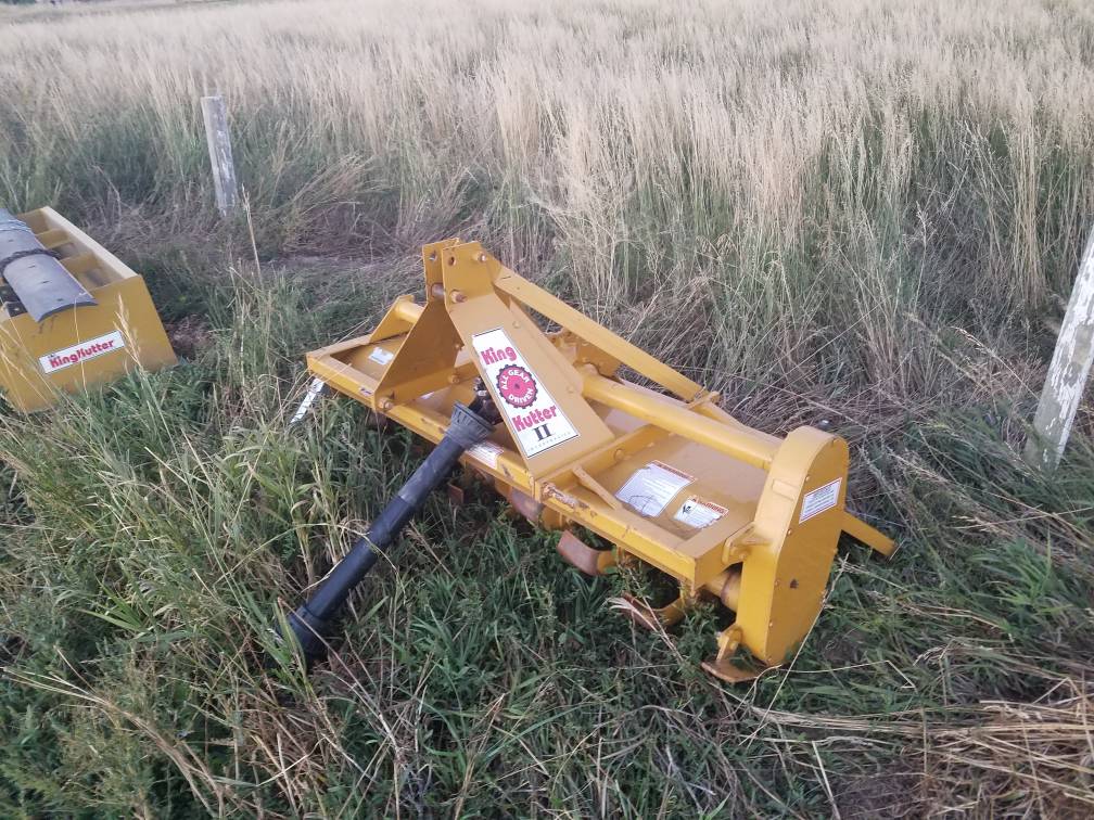

Not sure which dimension needs more clearance for your tiller. But you know you can flip the bushing around, so the collar portion is to the outside (or vise versa if you need).
I had to flip them on my brush hog:
You can see the rust on the frame behind the pins from where I tried & failed to hitch up with the bushings on. There is about 2.5" of clearance without bushings which is enough for the hooks to clear. With the bushings on it wont slide into the hooks as they hit the frame.
I've converted several non-standard impliments to be QH compatible & am working on welding a new top hook mount for a cheap back blade now. I just cant be bothered for the tiller as it works fine without bushings. At the rate things are wearing on it I'll be through at least 3-4 sets of tines before there is any real wear on the pins. 20160910_192538.jpg
