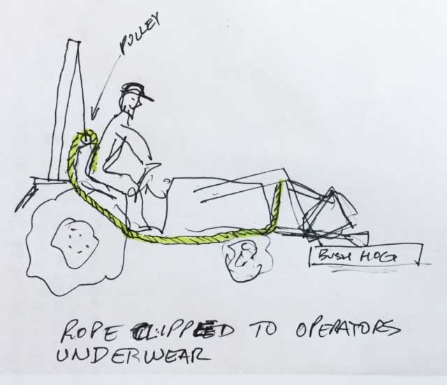

If you put a drive shaft on it, how are you going to control keeping from lifting it too high by accident? Just curious. :)
post #5 ?
Driveshaft would need sufficient overlap to accommodate FEL height adjustments. Would need a chain or something to limit the height the FEL could rise.
Might want to rig up a cushion of sorts so it doesn't scare you.
Or there are other options.

post #5 ?
<img src="http://www.tractorbynet.com/forums/files/customization/428380-bush-hog-front-bx-rope-jpg"/>
Lol!!! That would do the trick for sure!

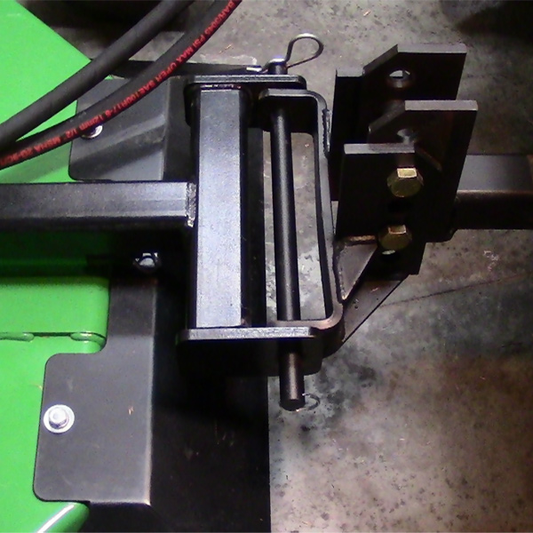

I think you may be on the right track. This video may help with the linkage issues, you could just use a chain on the fel to raise/lower the whole unit. (yea, yea, I realize this one is hydro...)
Rough Cut Mower - ProManPTO
