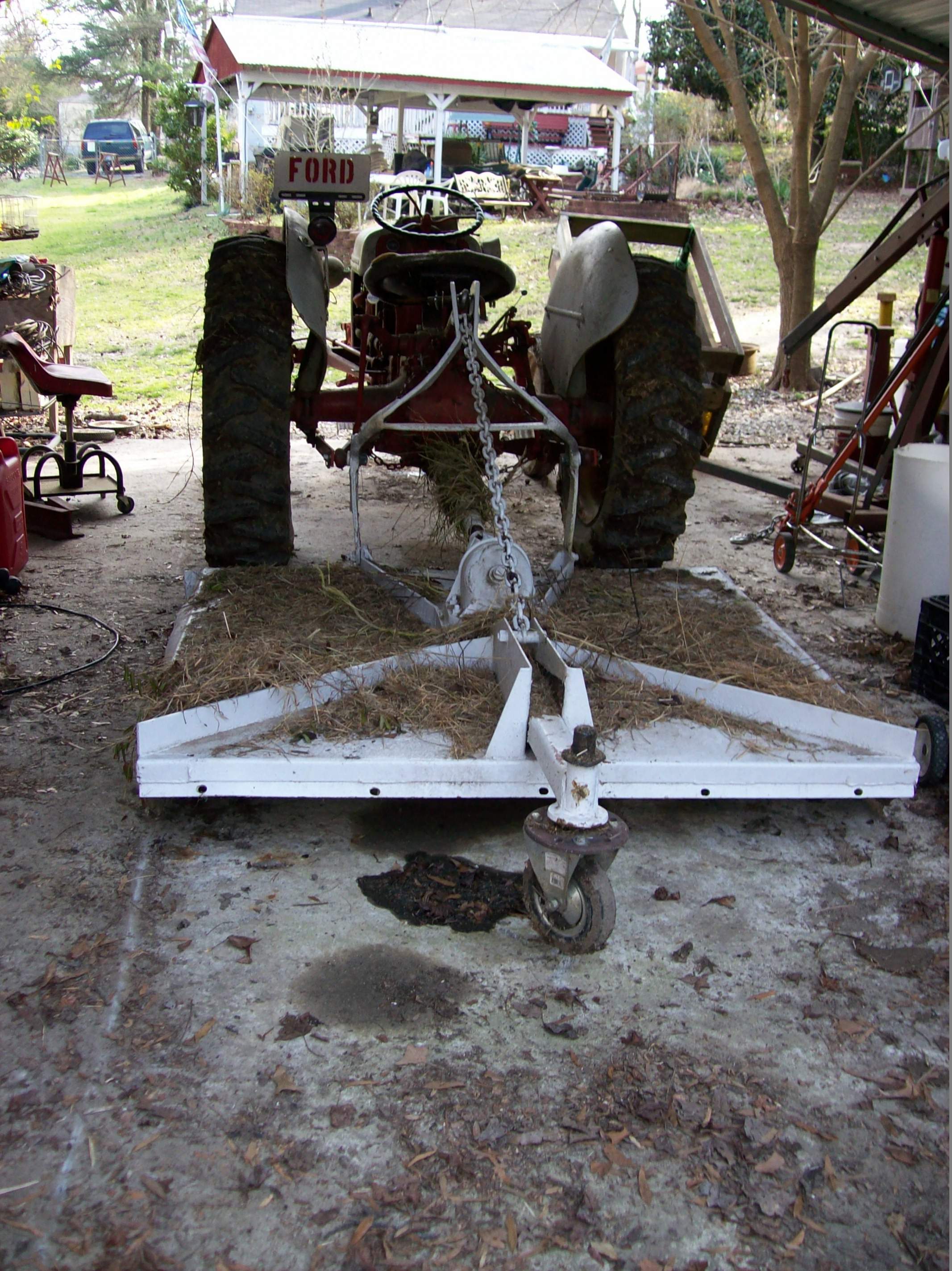

Well, I finally got the 105 Bush Hog project finished and attached to my little Red Belly today. I got everything adjusted up like I thought it should be. I used the 8” Harbor Freight caster for a tail-wheel; my daddy-in-law turned down an old car axle shaft as the wheel stud; I filled the gearbox with grease and welded rings by the 3 point hitch pins to fasten my limiter chains to the mower; and attached sway bars to the pins under the axle like I’m supposed to. It is about the limit of my tractors power though, but she cut like a champ taking down about anything I could run over with the tractor. Only problems I had was the ground was soft in some places causing the mower to dig down into the ground as the tractor wheels began bogging down in the mud. Over all, I got a serviceable rotary mower for about $200, but that includes the over-run clutch for my 8N, tail-wheel and some chain connectors to fasten my limiter chains. I learned my lesson about wearing shorts when I mow with that thing though. Da
ng briars I ran over cut my legs up pretty good and left a few thorns embedded in them that had to be pulled out when I got back home.
   / bush hog help #25
I think you would do better with a MUCH bigger tail wheel
