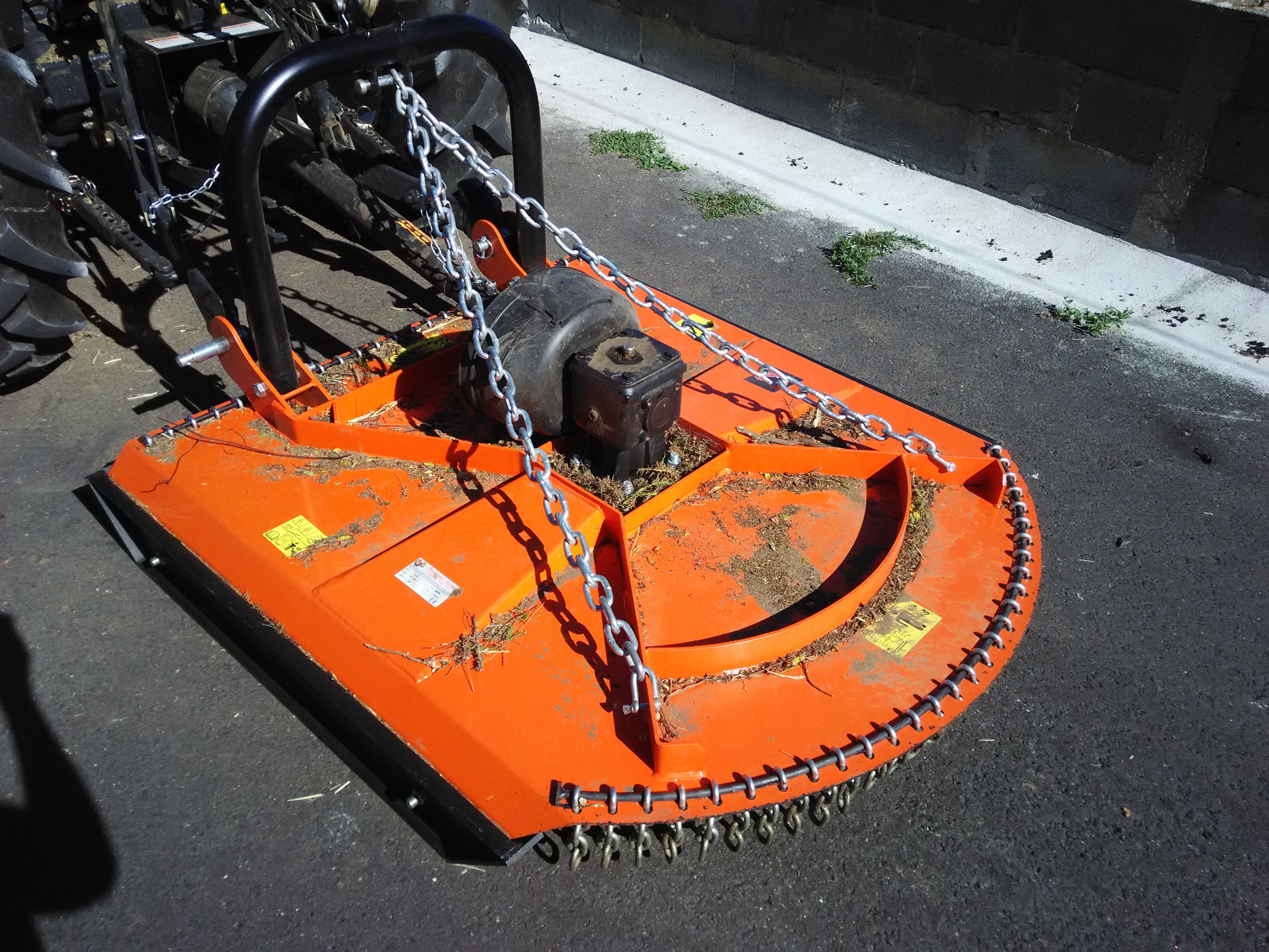

Oh boy. What would OSHA say about, not only 2 chains above the PTO shaft but two more under the deck. :rolleyes: Just rolling with the joke by the way. :laughing: These mowers are actually CE certificate compliant.
View attachment 669722View attachment 669721
I want to know more about that mower. I hope the new rotary cutter I got will suit me fine, but seeing something like that makes me feel like that would be great in some not-so-ideal circumstances

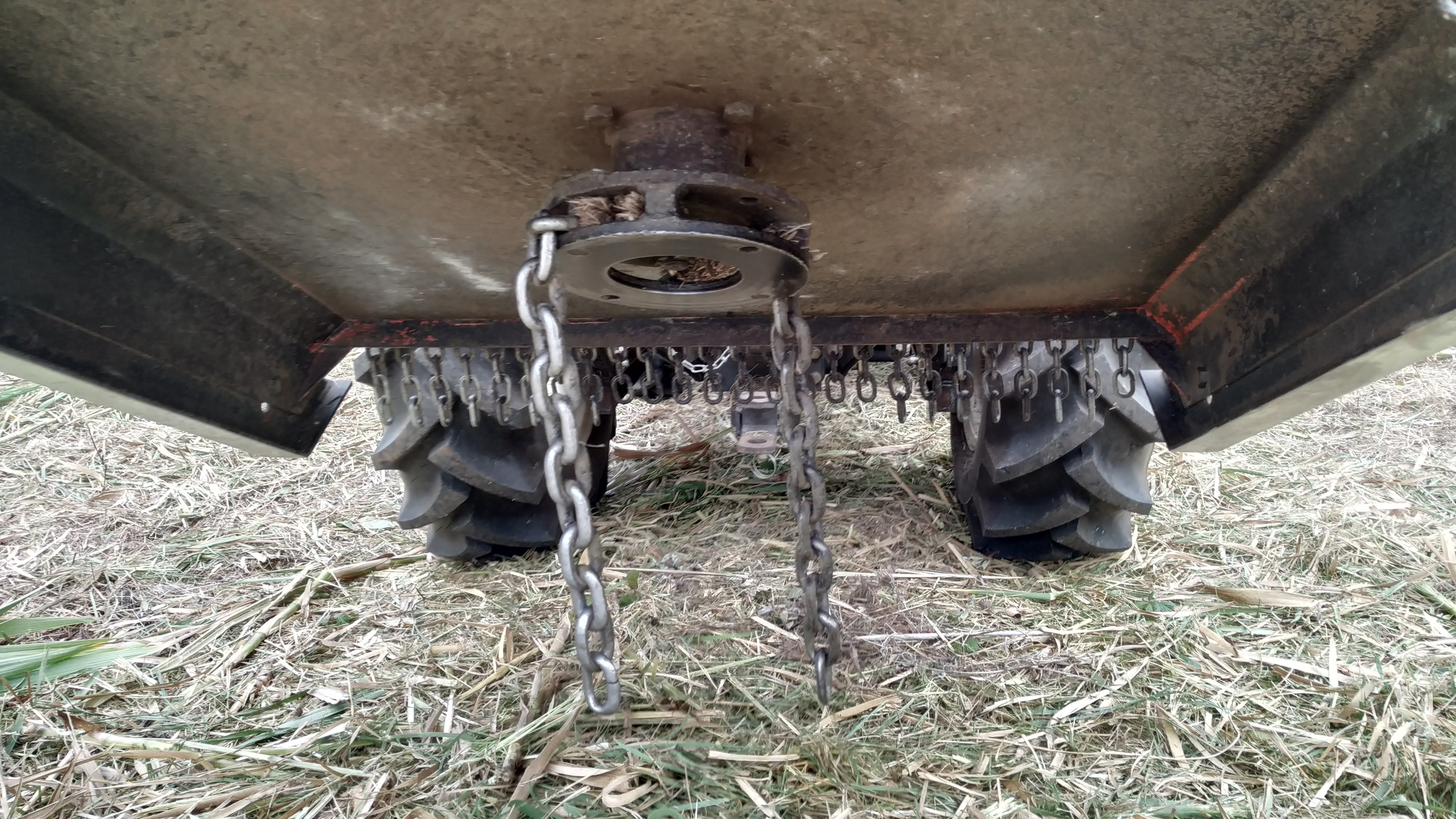

It's our style of mowers. 90% use chains instead of blades. This very good on rocky ground, stumps, heavy brush, thick brush, whatever. Blades will just get smashed on rocks, while chains just skip over it.
We also don't use a tail wheel because we back these things under tall bush, sometimes hitting trees, walls, big rocks and stuff that we can't see.
By using chains, it does requires more HP from the tractor. Specially in heavy and dense grass, is where it takes all the HP. A 4ft mower, like mine, is the size suited for a 35HP tractor, and it can bog down in heavy and dense grass. While a mower with blades, you could probably run a 5 or 6 ft.
On higher HP tractors, we will often run 4 chains instead of 2. Now, these things will not leave a great finish but we ain't cutting a lawn either so, doesn't matter that much.

These things are awesome and not really that expensive. A 4 ft mower like mine cost me €650 or $770. 4 ft is cutting width, outside dimension it's a little bit more.
These mowers have chains guards which helps tremendously reducing thrown debris. I actually lost a chain link (it was cracked and I did weld it for the job in hand) and it just fell off exactly where it broke. I managed to find both broken halves just on top of the mowed brush.
