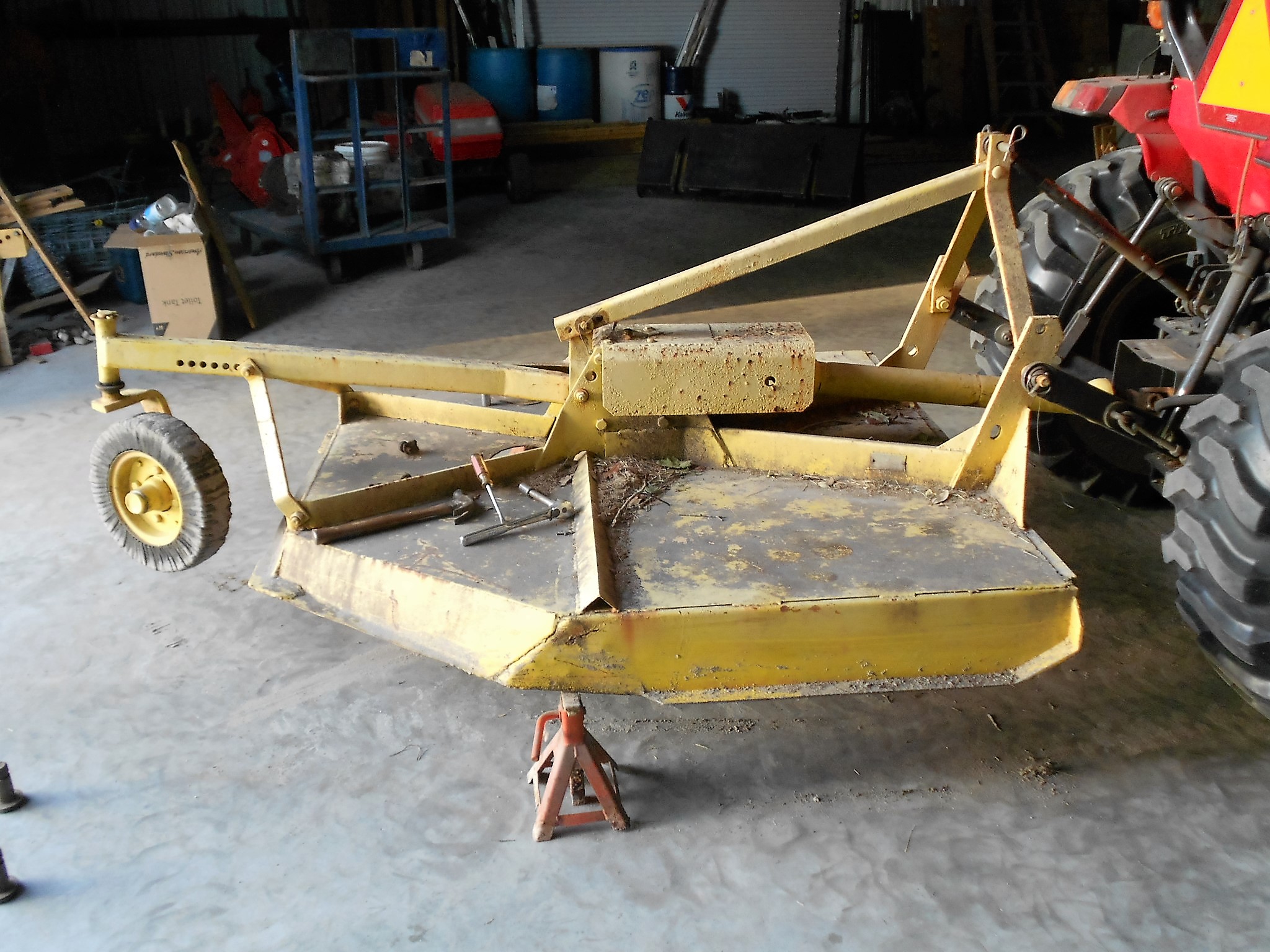

I have been shopping for new blades for my OLD Woods 5' Rotary Mower.
I bought it used, in poor condition over 20 years ago. I replaced the rusted deck and fabricated a new Stump Jumper. Now it needs new blades.
I found the blade part number and called local Woods Dealer was told it was out of stock and would take about 2 weeks to get.
I googled part number and found dealer in Pa. with them in stock and ordered them.
They said the blades will ship today and I should have them in 2 days!!
If you have the part number you should be able to get the right blades.

I got a pair of blades for my Woods Cadet at Tractor Supply. I belive they're intended for a Bush Hog and were too long for the Woods. I thought I'd have to use a cut off wheel to shorten them and was surprised to find that my metal cutting bandsaw went right through them. I hope to install them this week.

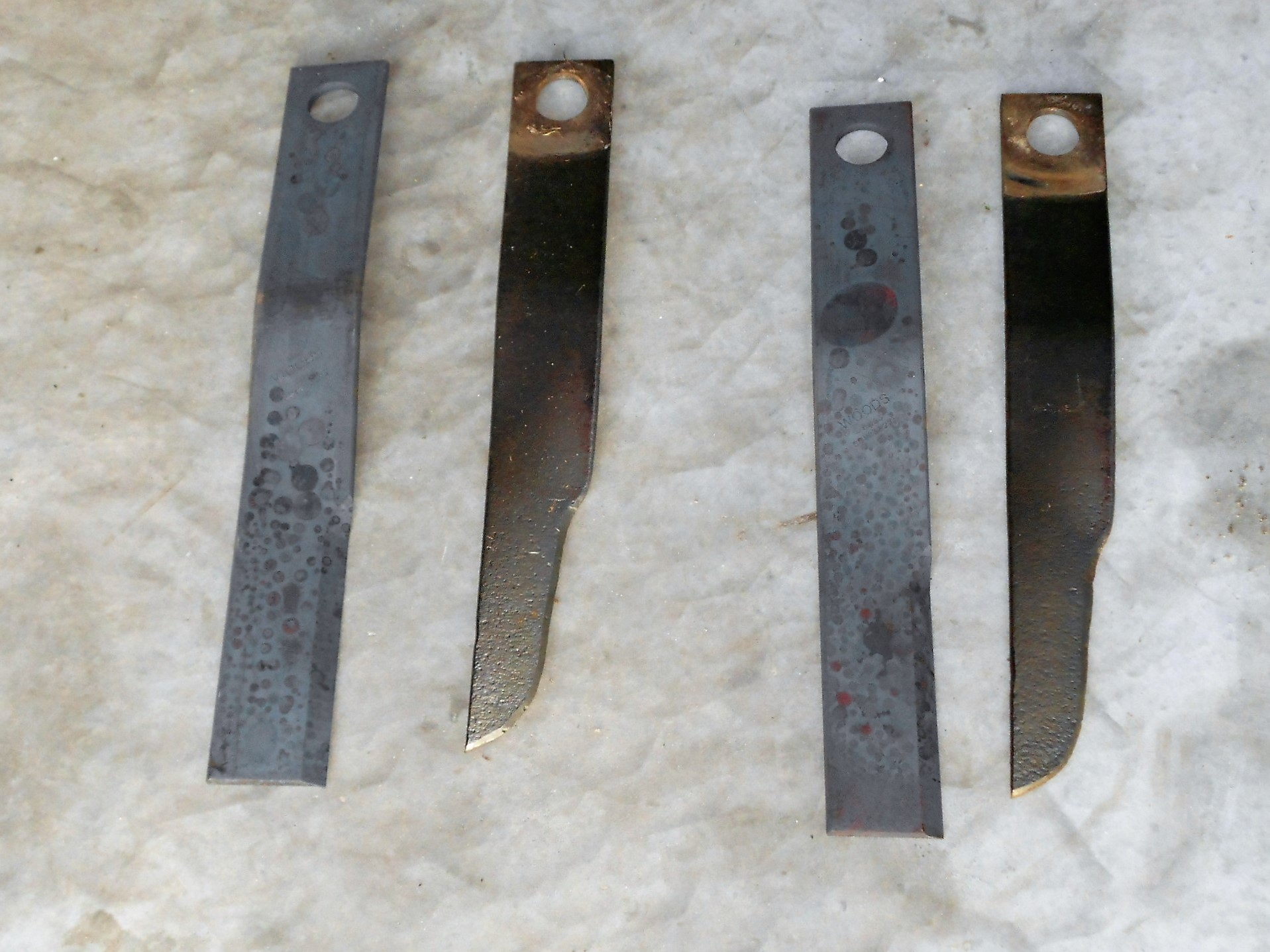

Here are pics of the old and new blades.
They probably would have lasted another 10 years! But I am not that guy! :)
It cuts like a Finnish Mower now.

Yea, you were due to change them

Are you sure you couldn't eke another 5 years out of them (Grin)?
You were overdue!

How hard are the blades? I have discovered that once the cutting edge gets rounded back they don't cut nearly as good as they did when the cutting edge was straight.
/ bush hog blade question #17
If you need another 3" of sharp edge, whip out the old 7" angle grinder and sharpen it back a few more inches.
