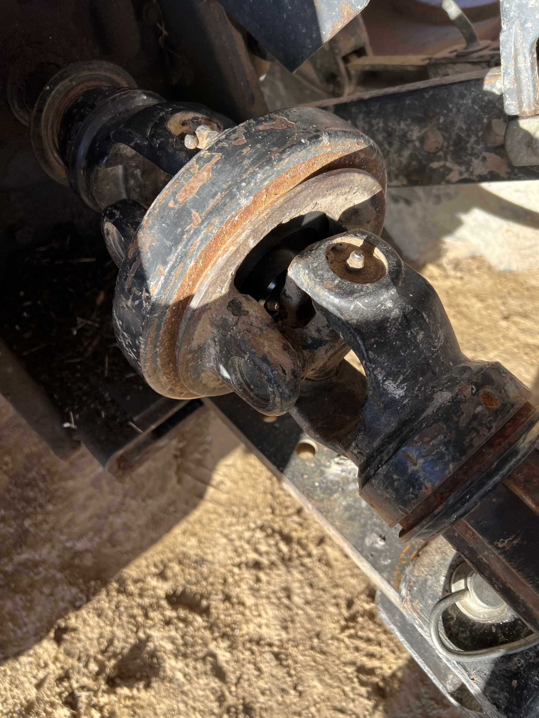

I have a lot of movement and visible damage in the wide angle double yoke, likely from getting stuck and damaging from angle. I haven't attempted to take apart yet, because I can't find any bearings or repair kits. The wide angle double yoke looks to be part #76357.

The cross kits are PN: 64663 anywhere from $46 to $125 depending on where you buy. Messicks has the pricier Bushhog cross, Amazon the cheaper. Most good bearing shops should be able to match.
Could also measure cap diameter and cross length to look up replacement. Measurements are metric. Cheaper route.

I’m probably misidentified it. Below is a picture
