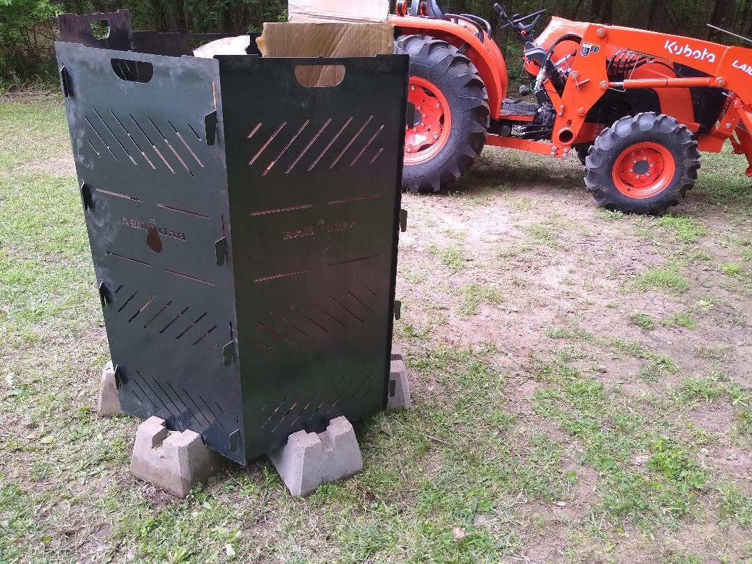

/ Burn Barrels #28
I tried the 55 gallon metal barrels to burn but they lasted about a year and I couldn't put big boxes in them without having to put labor in cutting them down.
Now I have the XXL size burn barrel made out of 11 gauge steel from Proud Pyro. It's expensive but can hold large items.
I had bought the 14 ga burn barrel from them but it only lasted 3 years before rusting through. My fault for not cleaning it out and the ash holding water after a rain.
Now I use the concrete patio deck blocks to raise the sides. I don't attach one of the sides and put the trash through that instead having to remove the heavy lid each time.
BEFORE (14 gauge steel)
AFTER (11 gauge steel on concrete blocks

/ Burn Barrels #32
