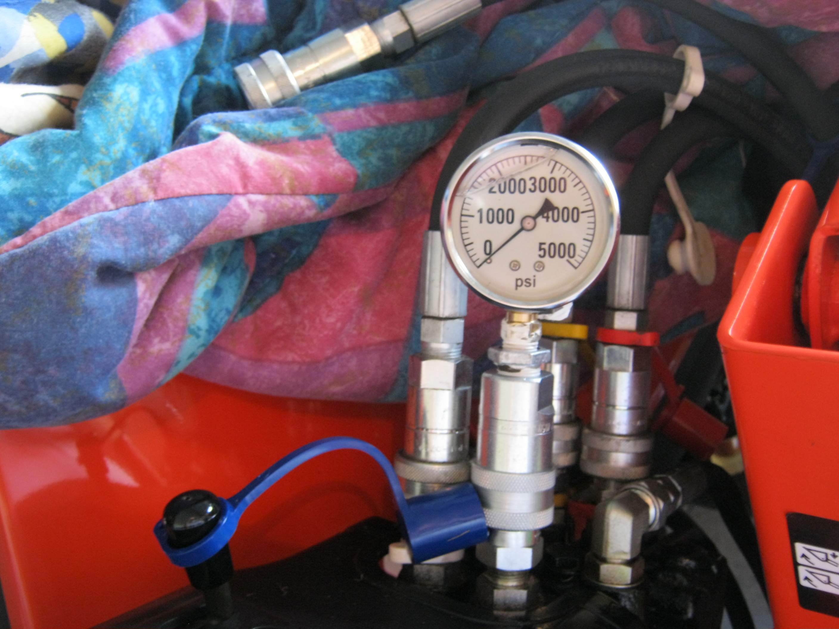

What is the size and type of quick connect fitting for a 5740 . I would like to check the pressure . thanks
   / Bump up lift capacity of L3400/LA463 Loader #84
bmiker - Are you asking about the quick connect fittings on the loader or the rear remote? On our L3830 the fittings in the two places are different. I used the rear remote fitting, and according to a parts book at NAPA, it is ISO type, which is larger than the ones on the loader. I didn't have to buy one, since the dealer provided two male connectors to go with the female connectors on the remote.

   / Bump up lift capacity of L3400/LA463 Loader #86
It seemed to on mine. I bumped up the main relief valve by about ~200psi and checking the pressure at the loader hookup, it showed the increase. If I'm correct that is past the point of the loader valve.
