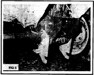

I did notice that your mounting brackets have a hole drilled through them for the rod the lower 3-pt arms mount on. This is one of the things I have been trying to figure out... if it is really necessary to remove those brackets every time. When I drop the hoe off I am going to take a hard look at this.
I guess you're talking about the hole right in the center of this picture?
Here's a shot near the end of the previously linked manual:
I don't see the hole there.
BTW did you get all the 3-pt parts along with your tractor?
I think so, but I've never removed the backhoe, so I'm not sure that nothing's missing.
If I understand you correctly... You remove the notched adapter plates in order to install the 3-pt lower links? That's a bummer. Are you thinking of installing the lower links outboard of the adapter plates?
Yep!
The real bummer is the way my tires are I have to pull one rear off in order to put the rod in/take it out for removing the 3pt.
Yes. Although I was looking at it this morning and with the space the plates take up plus the gap between the plates and the rear end part I would need a new rod for the 3pt.... and it might be too wide.
If you could leave the bh brackets and the 3pt rod in place it would really cut down on the effort to attach/drop the hoe. The bh brackets are pretty low but not any/much lower than the cross member for the loader. My place is all flat anyway ;)
