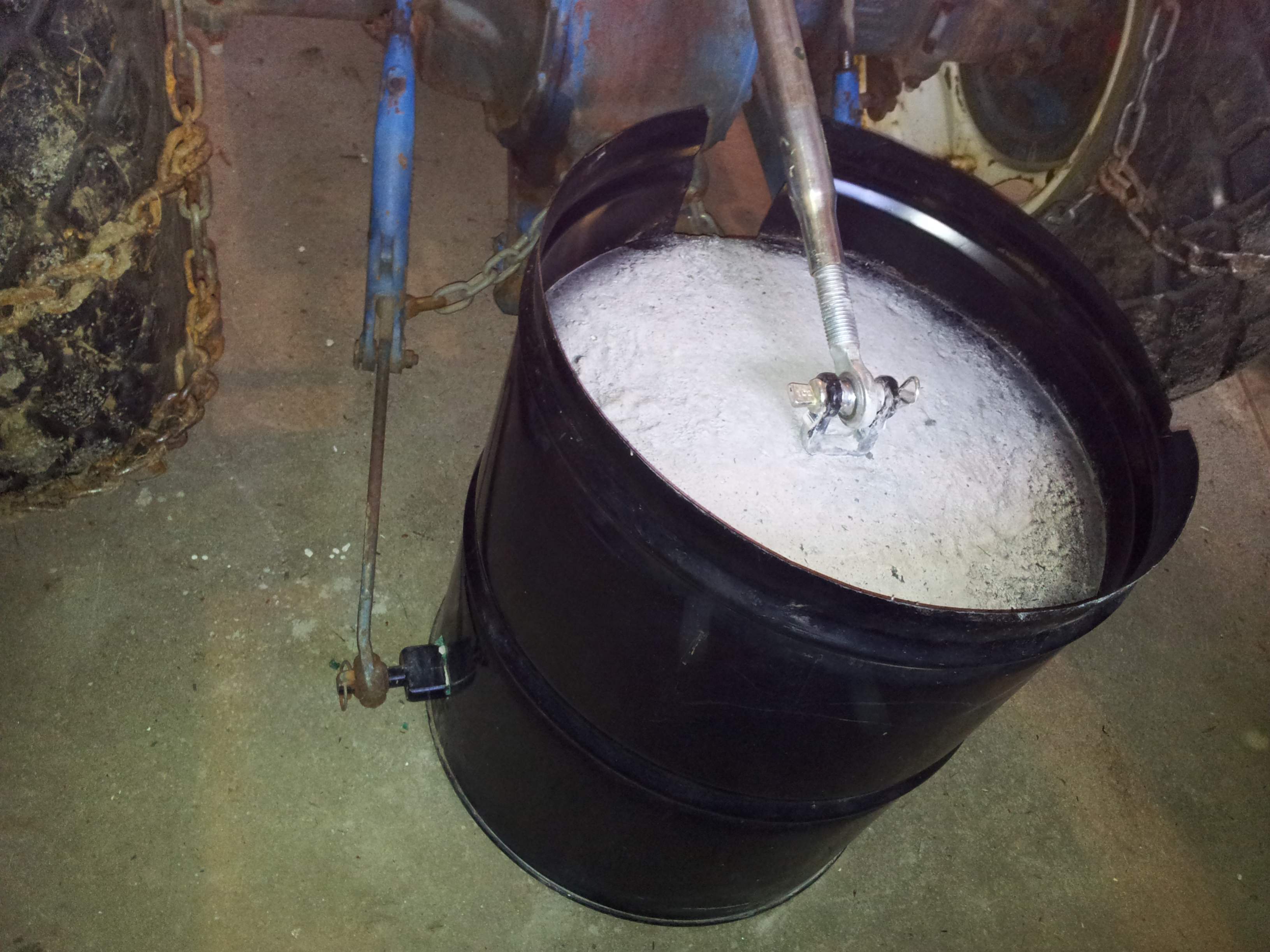

Having weight on the rear really helps my Ford 2000 plow snow.
you can get a steel barrel from Craigslist for $10, put a crossbar from Tractor Supply through it.
( Watch the height of the cross bar versus the height of you 3 point side links at rest, I got the cross bar a little too low)
I then put a chain from the cross bar to a chain hook from TSC that was wide enough for a top link.
and mixed up and added seven 80lb bags of cement
Watch the height of the toplink attachment for when it pivots off the ground, see pic
