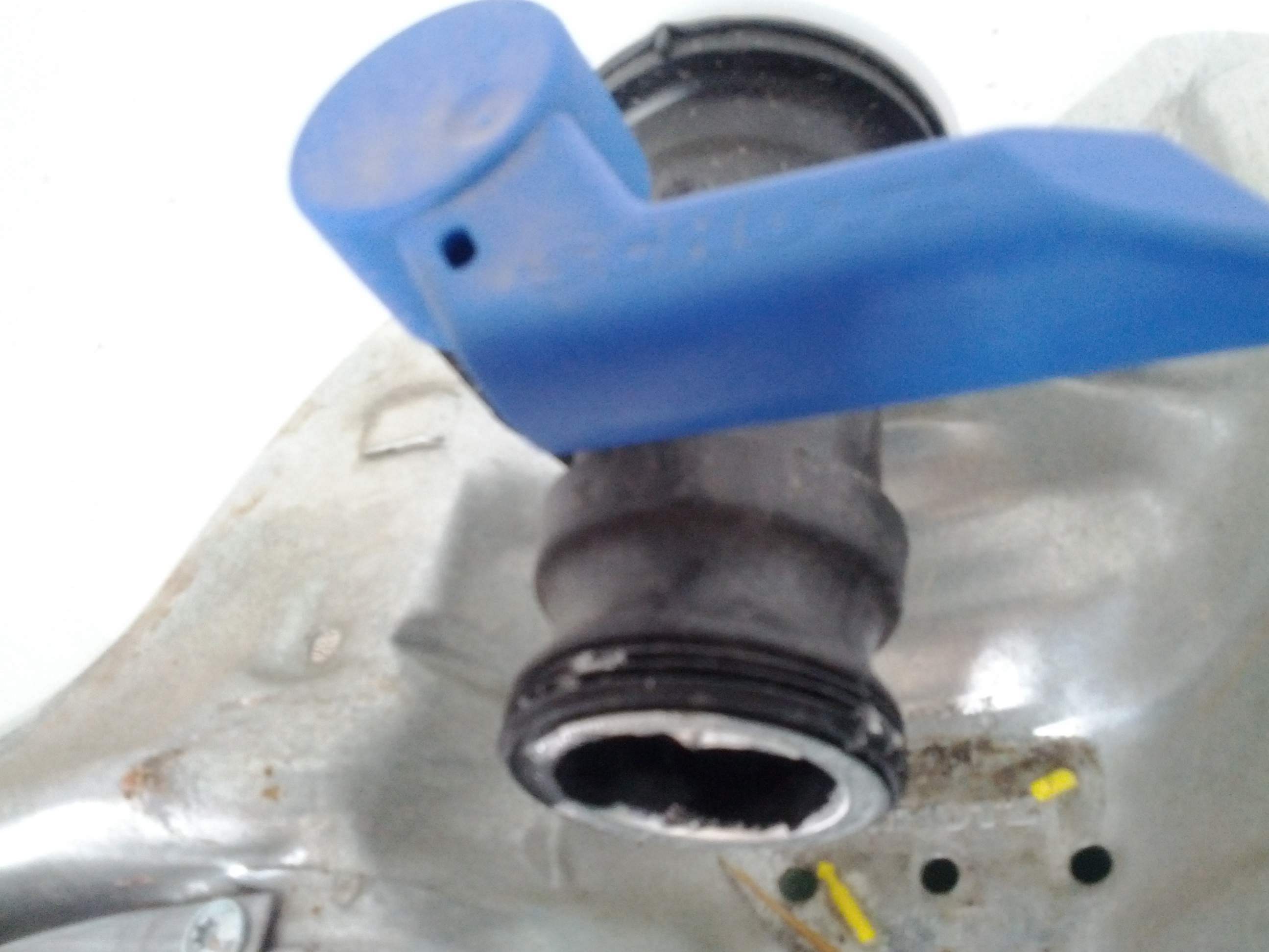

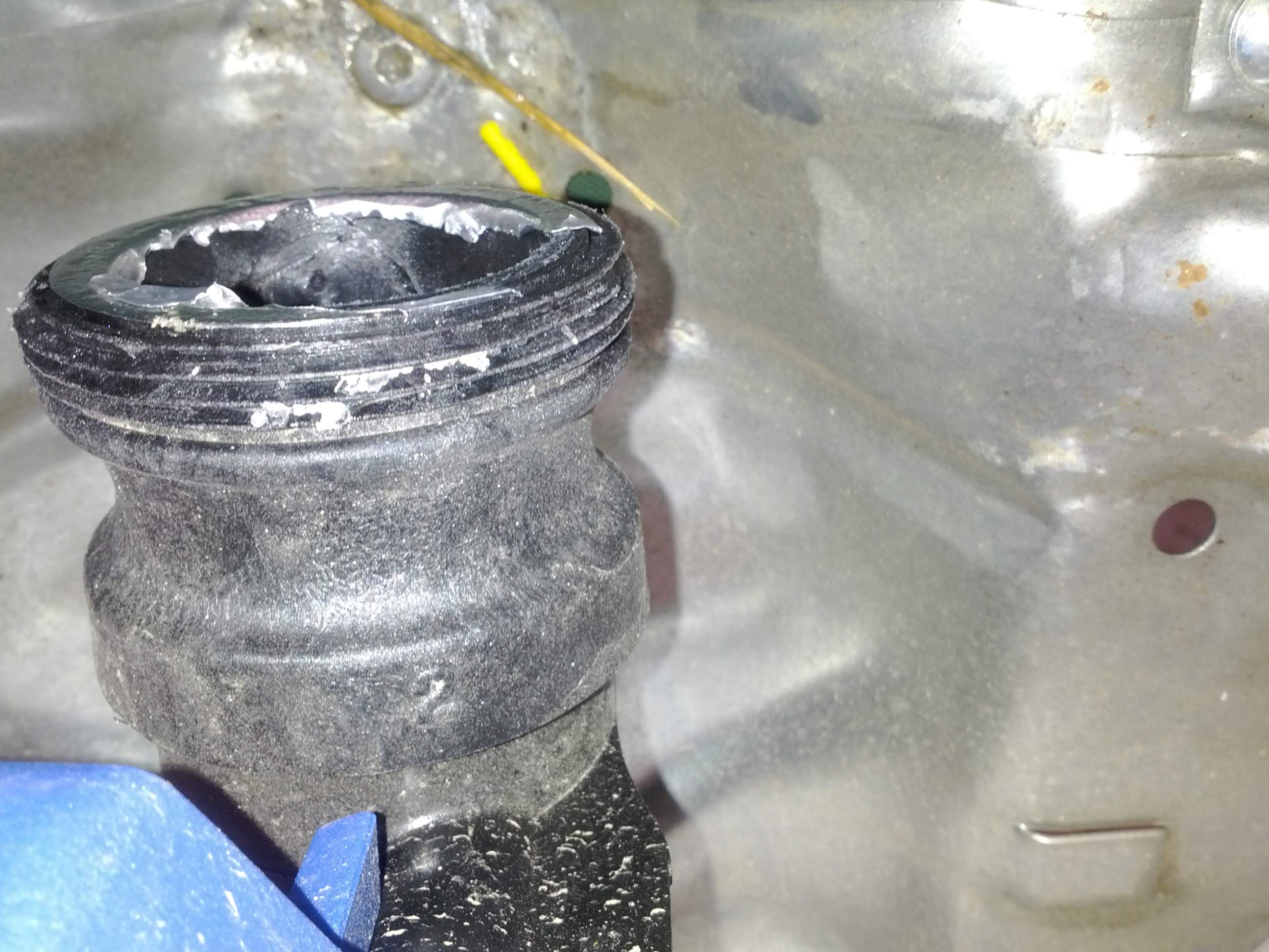

Hey guys one more question, I did some more snooping at the parts store and I looked at the cam locks. I think this maybe a 2 inch cam lock compatible valve. Here are some pictures.

Looks same as mine 2 inch cam lock works. The ones I got had some chemical they use in the treatment of water.

Seeing as these totes were for chemicals that may be the reason there is a different thread.
Might want to check chemical component suppliers to get a proper match.:)

I am going to hit TSC and pick up a 2" Female camlock to 2" NPT and my problem is fixed. 12 bucks at TSC, less than 20 bucks over all for a couple nice poly tanks. Thanks for everyones help.
