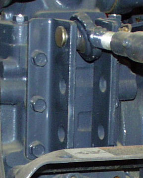

Harv,
Not sure if I'm the one Bird is refering to or not, but I did have a post a while back titled <A target="_blank" HREF=http://www.tractorbynet.com/cgi-bin/compact/showthreaded.pl?Cat=&Board=jdown&Number=78484&Search=true&Forum=All_Forums&Words=CVHoss&Match=Username&Searchpage=3&Limit=25&Old=allposts&Main=78484>Tree Stump--1, Draft Link--0</A>
Here's the <A target="_blank" HREF=http://www.kansascas.com/images/tractor/MVC-242F.jpg>photo</A> from it.
Hoss
