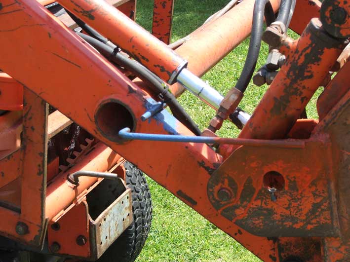

Heres mine. About as simple as it gets. When the two blue pieces line up, its level. When the loader is raised I can view it easily from my seat so i can level the bucket before I drop it to the ground. If the bucket is already on the ground I have to lean out the side to see it but its still much easier than trying to judge by viewing the bucket alone.
