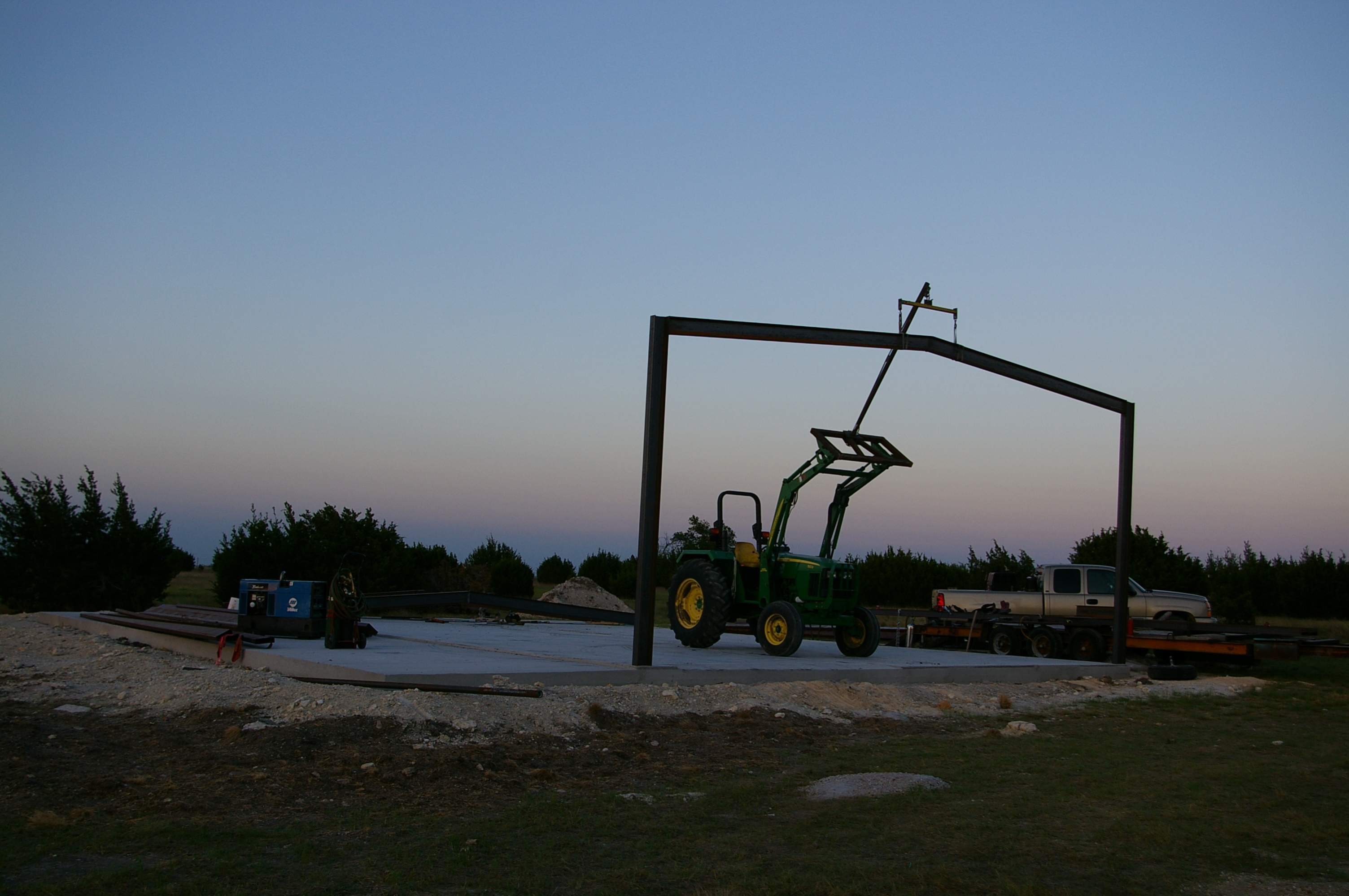

At 7 ft I would like to know what that tractor could lift? 400-500# ???
The boom looks to be a little longer than the distance from bucket arm pivot to bucket pin. Double the distance from pivot to load, half the load capacity. If that loader can lift 1000#, the boom limit will probably be close to 500#...

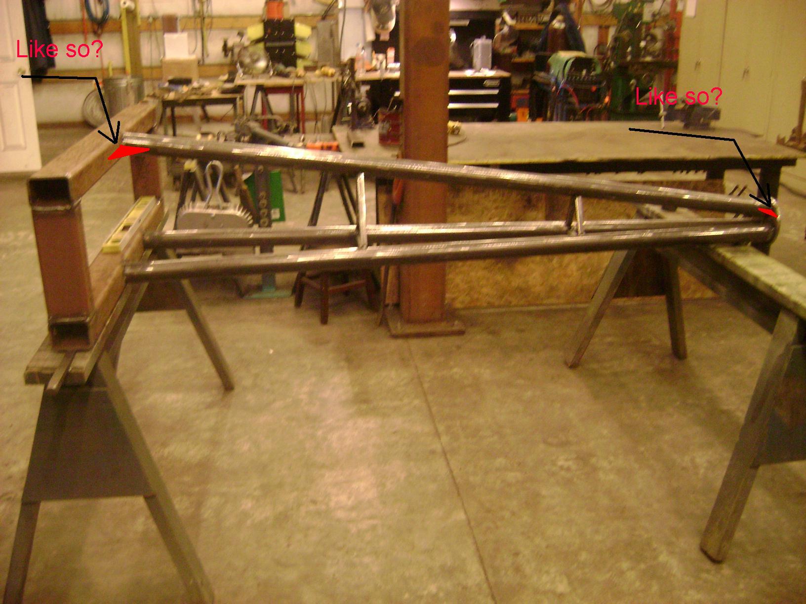

The weld volume was brought up on another tractor site. I'm fairly secure with my welding abilities, been welding for almost two whole weeks now;), but I added the gussets on the top cord to the box tube only, just to make sure. I don't have any pictures of the boom completed, and painted. Only plan on using it for the chain harrow, and maybe setting trusses if I build another small out building. The boom works fantastic with the chain harrow, I can push or drag it. Works great for dragging the chain harrow under tree limbs, to get real close to the trunk of the tree.
