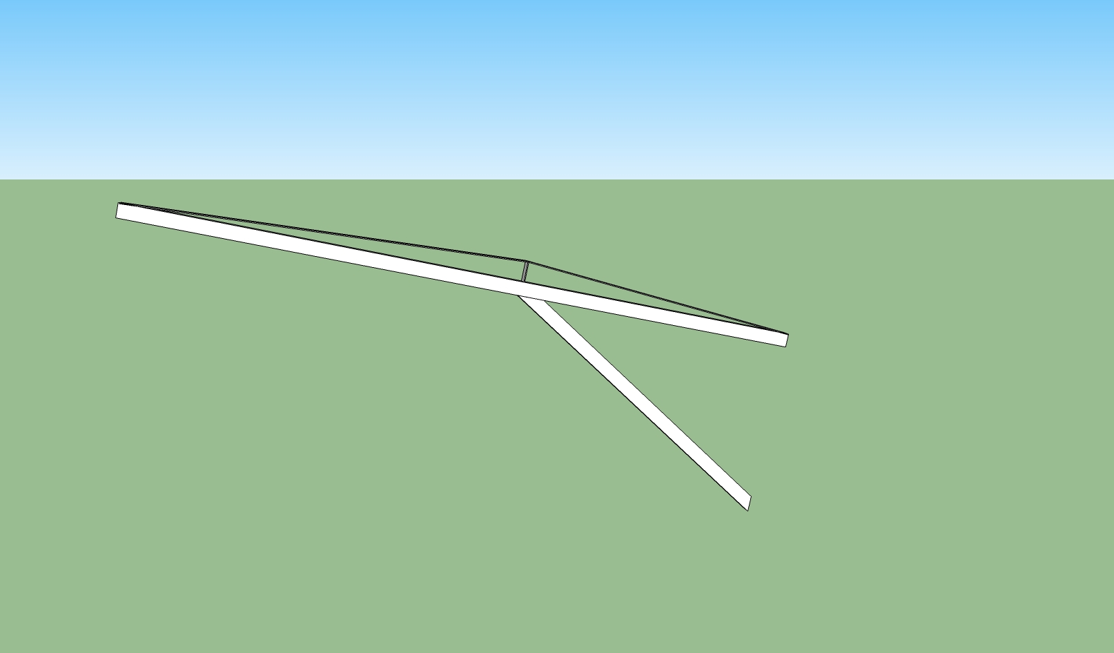

The beam is going to buckle where the brace from underneath meets the beam. This is where the opposing forces are all greatest. Putting the truss support directly above this point sandwiches that point so that the truss support above pushes down to help counter the force of the brace pushing up.
Exactly. If the upwards and downwards forces are on the lower support then there is less stress on the main beam. There are calculations available to figure the capacities with and without the supports but you would need to know how much force a given piece could take. Important thing to know is that it dramatically increases the capacity.
   / Built my boom pole today #22
By doing this aren't you adding more total forces to this area therefore making it the weak point ?
Correct that you are adding more total forces. Incorrect that you are making it the weak point. The purpose is to create opposing forces that cancel each other.
   / Built my boom pole today #24
How my thick head works is this. I am looking at the pole part let say 2x2x1/4" wall as being an undersized member for what he needs for the design. So he adds a truss to increase the stiffness and load carrying capacity to match that of a 2x4x1/4"wall pole. So regardless of which pole he uses the capacity would be the same and the failure point would be the same at the lower support leg.The only way to increase the load capacity would be to move the lower support leg to shorten the pole length not change the truss support leg location.
You are correct that no matter where the truss support is, the trussed beam is still stronger than the un-trussed beam. It's just going to be strongest if the support is directly over the leg. True that moving the leg out will create even more support than moving the truss support in, but that's due to other factors.
Take a look at the sketch that BCP posted (post #13). It's a good illustration of the principle. In that sketch the beam is able to bend without bending or breaking any other member of the structure. Imagine if the truss support were directly over the leg. The only way it could bend in that instance is for a weld to break or for some other member of the structure to stretch, bend or break.

But only when all the corners meet other corners. In my sketch, the support brace meets the side of a triangle, so the full benefit is lost.

I would put it a little differently. Tension and compression are similar for metals (concrete being different because it is markedly weaker in tension than compression). Shear stress failure is what it sounds like, the separation of material by opposing forces. Bending and shear stress are not exactlyl the same. Bending forces result in local tension, compression and shear stresses. Bending is bad because it results in very high stress components in a very localized area, leading to failure. A bending mode failure could fail from tension, compression or shear depending on the shape of the member and load application (although shear might be the best candidate).
The original design shown isn't optimum because of having the brace away from the top truss support, but it is still providing a lot of support because it is reducing the moment arm that creates the bending forces. All these designs look like they have a lot of margin for small tractor use.

The sides of the beam contain unseen small triangles between where the lower brace supports the beam and where the beam supports the truss king post. Assuming I'm seeing that the beam is square tubing, the tube is itself a small truss, with the top under tension, and the bottom under compression. For the tube to fail in that few inches of reach from the brace to the king post would be after the rear wheels of the tractor were in the sky. Be careful of your front drive axle's innards when you have a heavy load on the boom. They weren't made to handle those kinds of stresses (ask me how I know :().
The failure illustrated in the sketch would not happen unless the truss itself failed first, as either the king post failed under compression, or the top cord failed under tension, or both. Yes, I'd say the layout isn't optimal, but it's still way stronger than not being trussed.

Bruce, you are absolutely correct. That structure would fail right where the lower structural support meets the boom pole, by collapsing the side that triangle forms. As mentioned, it should be out under the base of the kingpost, which will keep the kingpost in compression so it can support the tension on the forward running guy and rearward backstay(kingpost truss, common in bridge and crane construction, as well as older aircraft wing design).
