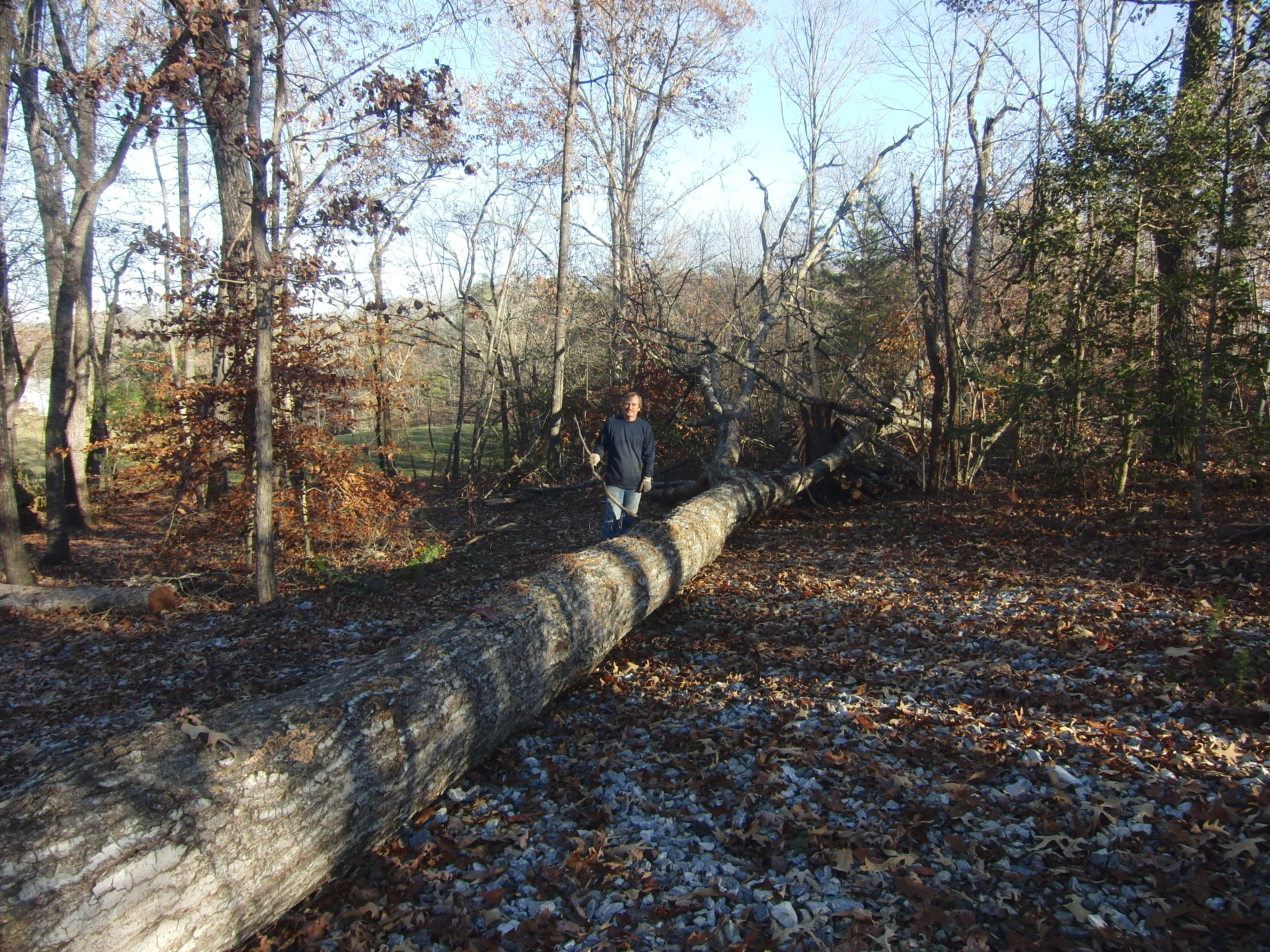

This is not typical but one that I had on my property that needed to be removed. 6 tree down.JPG
most will be smaller.

Shame to cut that into firewood...

This is not typical but one that I had on my property that needed to be removed. most will be smaller.
We had two high wind storms this Spring/Summer. I'm harvesting 19 large trees out of my timber. Mother Nature's way of "survival of the fittest".

That is a big tree, could get some nice planks out of that, but the background does not look like Florida to me, looks like North East, like my back yard, guess red oak grows everywhere.
