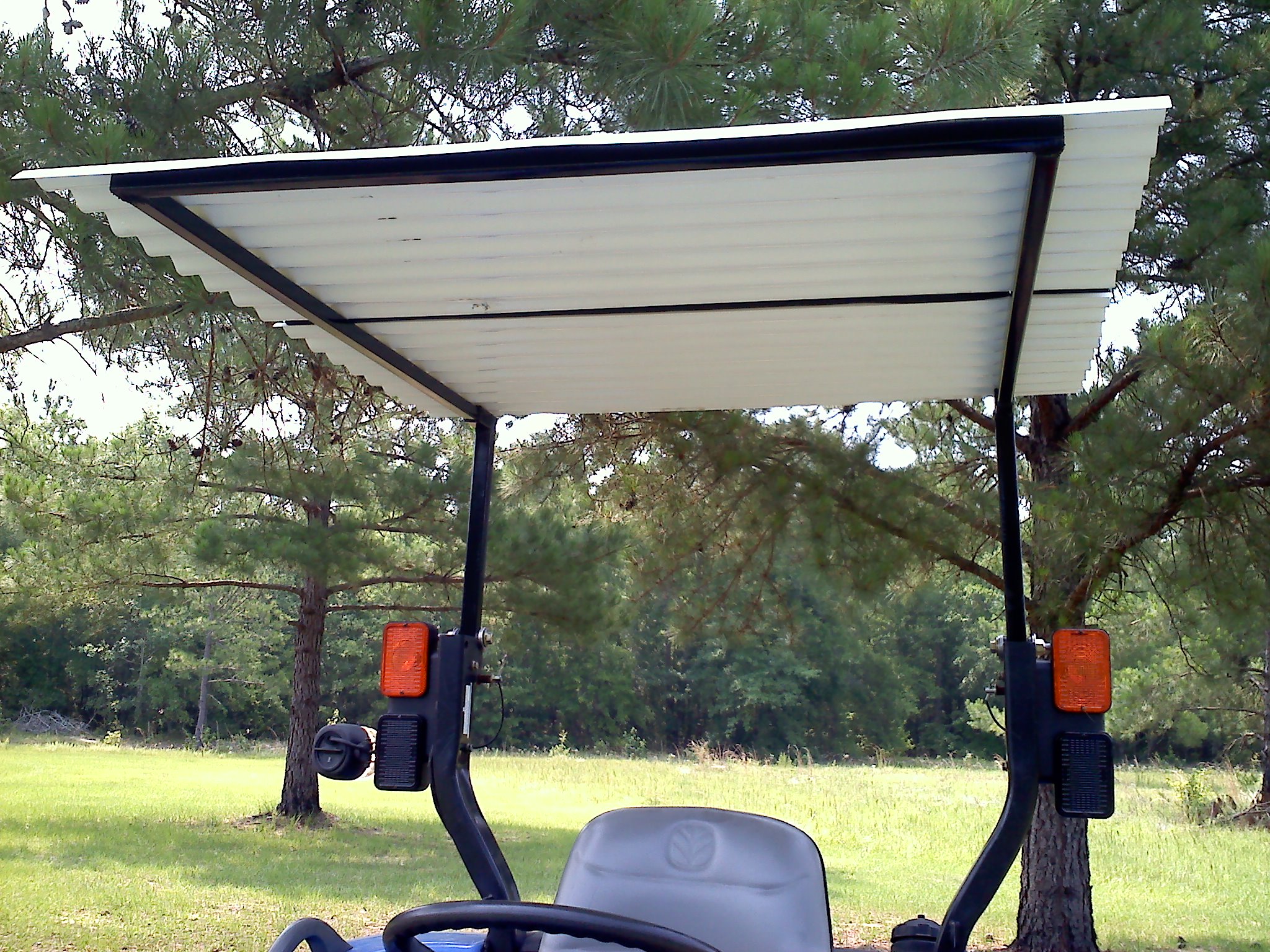

I always get razzed cause people say i over engineer stuff but now i feel right at home :).
looks breat. Being a newby myself, the one thing that comes to me is with that extra 250lbs hanging way up there i'd be extra aware of a rollover situation. It is now more top heavy than before.
/ Built a steel sunshade #22
Good point on that center-of-gravity idea. It's amazing how much even an empty loader bucket can be felt when it's raised up.

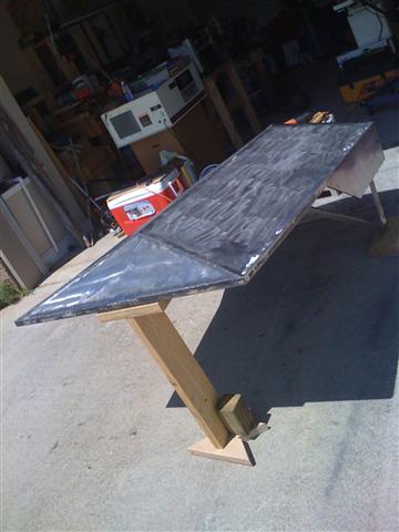

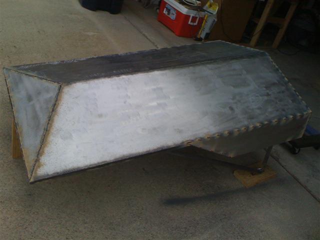

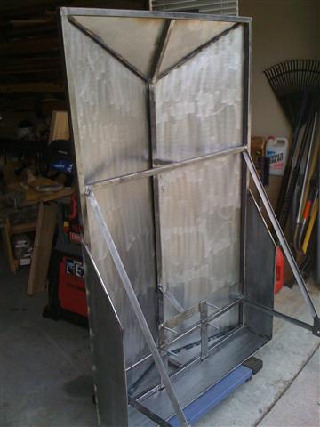

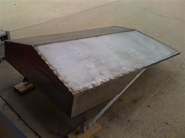

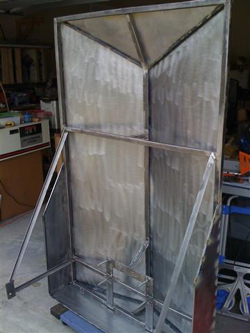

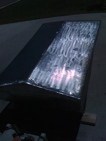

Better cuts would have made it easier but the frame wasn't welded perfect either so after a weld it would often shrink an angle due to the contracting weld metal and screw up measurements and angles. Possible fix for that might have been to tack weld everything together before completing all the welds. Not sure though as I am a welding noob... fill me in if you know. Ok, the pics:
View attachment 215273View attachment 215274View attachment 215275View attachment 215276View attachment 215277View attachment 215278
Clamp the crap out of it, tack weld it, and still clamp the crap out of it for the final welds. Welder's magnetic squares work well in positioning while you clamp the crap out of it; but not so well by themselves as the contracting metal as it cools is generally stronger than the magnet.

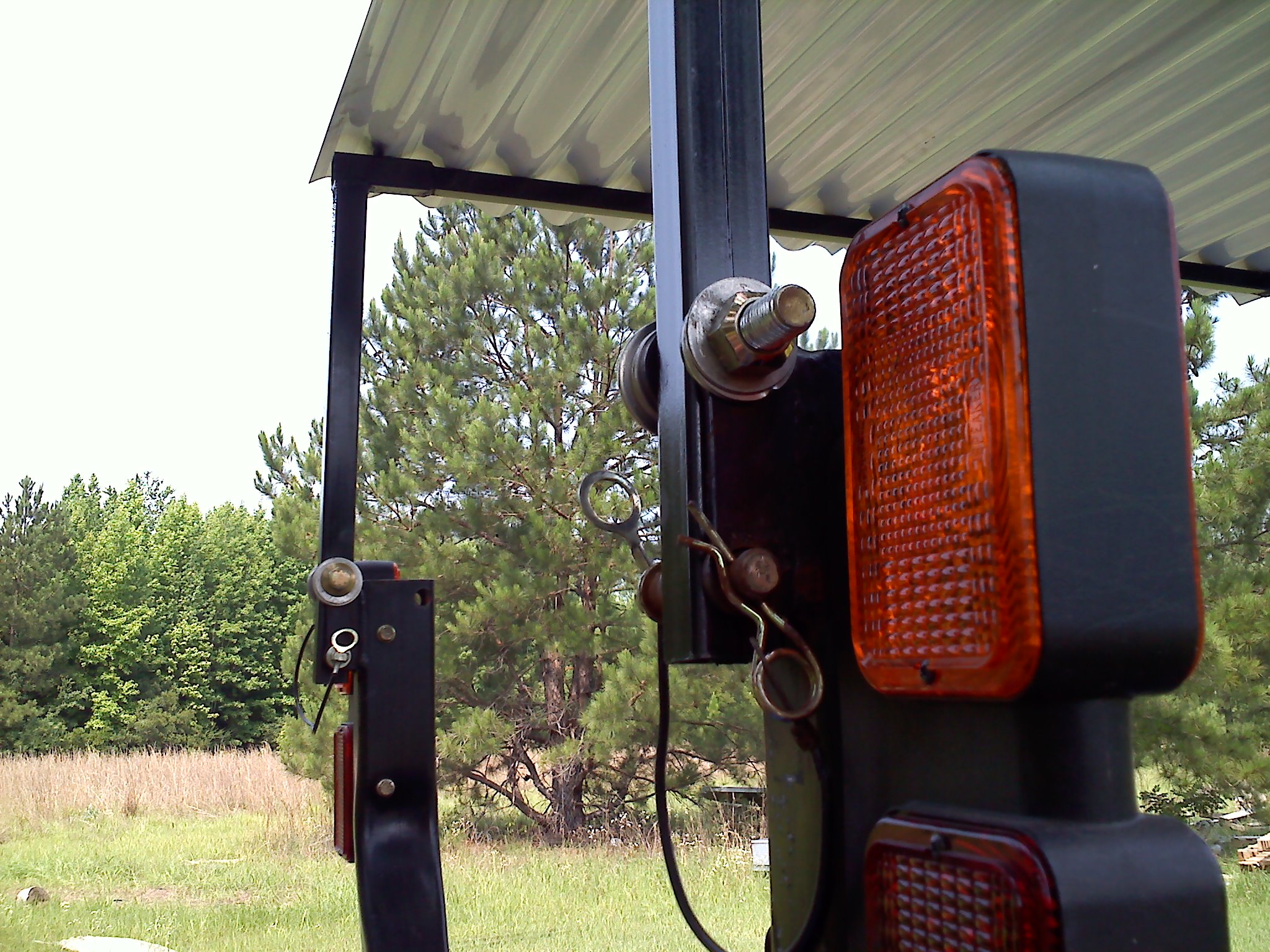

Kebo,
Thx for your comments. I needed extra long studs to get the pieces on and started. There is some extra that could be cut off but I think I'd rather leave it in case I want to bolt on any accessories. The studs are so far up and back that I'm not really concerned about it but I guess I could always come up with some saftey caps. Epoxy a nut into a ping pong ball half or something...

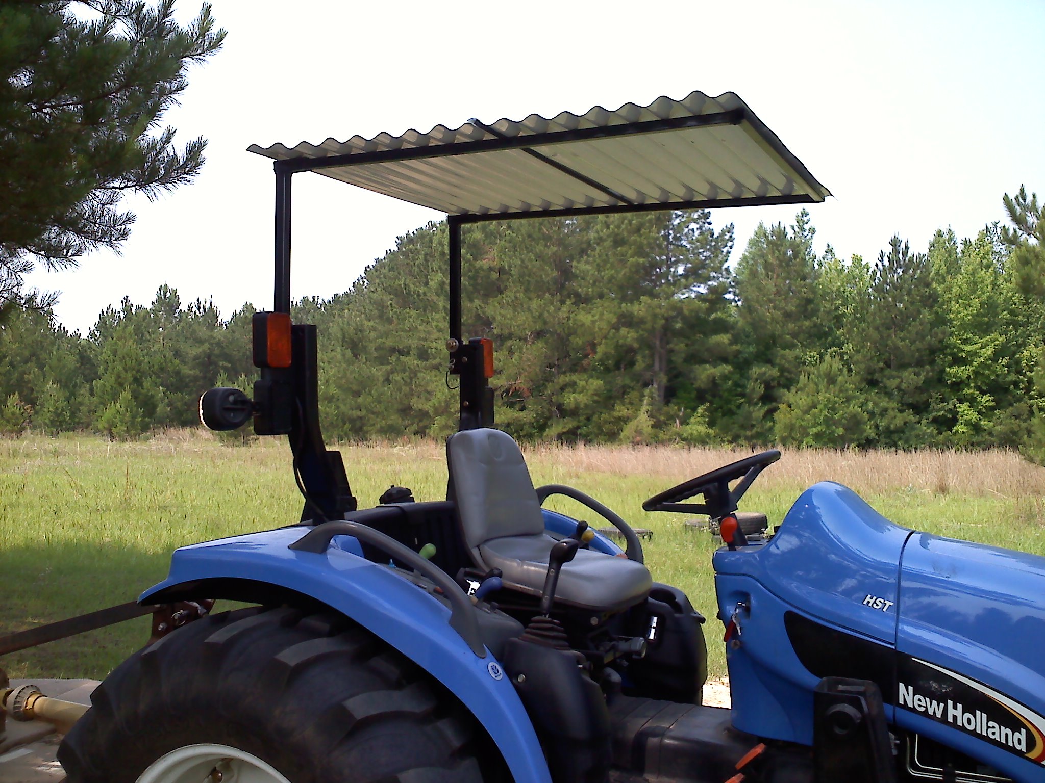

Yes, it is a little more weight up top but with the loader and filled tires my tractor is near 5500lbs so I don't think a 250lbs roof is going to affect it much. But I'm also not concerned because there isn't much slope on my property. Really only at creek banks and road sides and I don't plan on driving sideways along either. :D

MJN: Thanks! I sure gave it my best. The knee braces actually don't get in the way at all. They give me something to grab onto climbing in or out. I haven't done much work on my tractor lately but looking at the pics of your front supports, and you did an awsome job btw, gives me the idea to follow suit with not just the braces but put in some plexi glass to provide some wind and dust protection :D

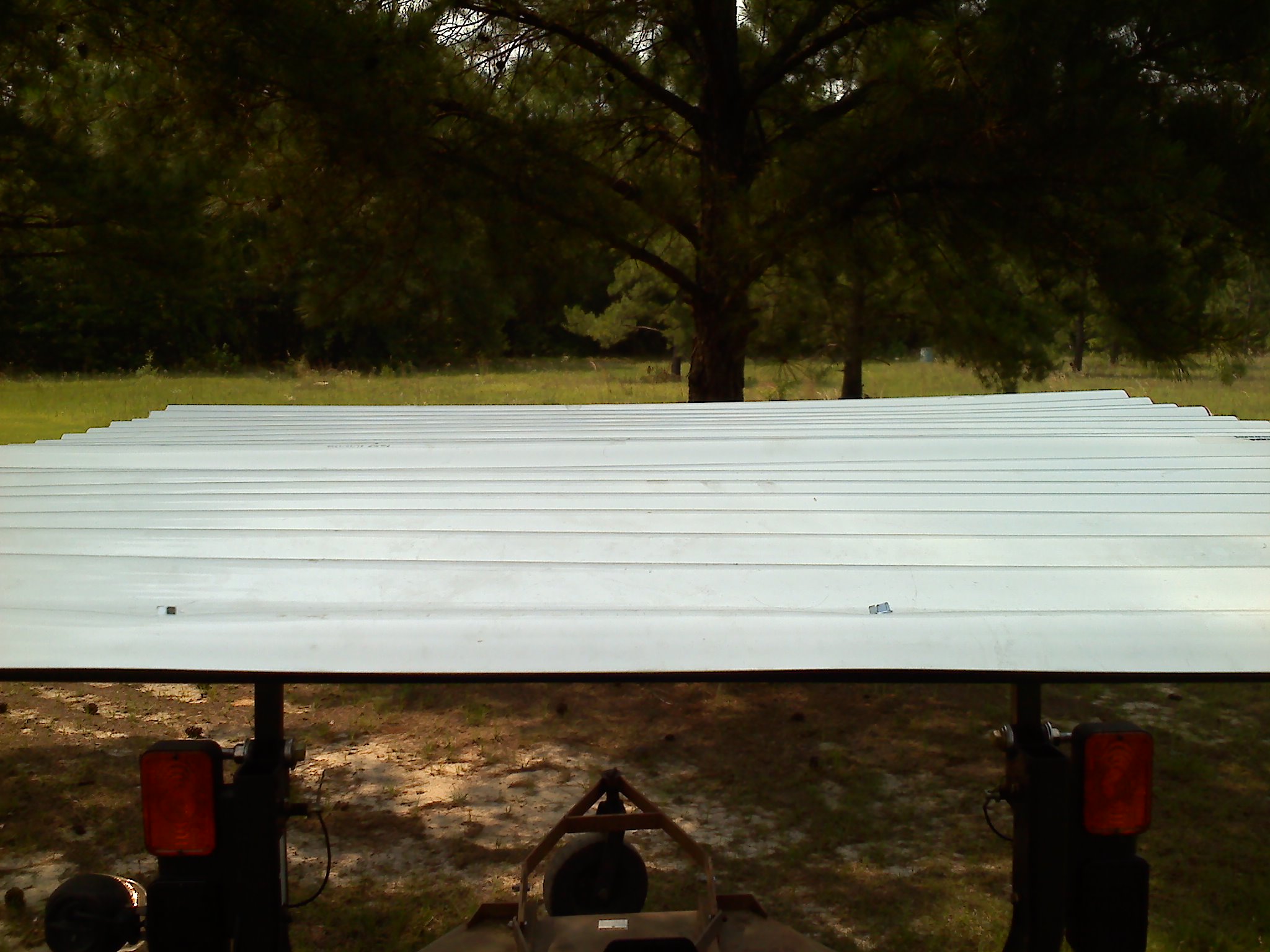

Looks kind of high in the pics, if its noon you should have plenty of protection. :D nice job though. if it rains golf balls you should be protected, looks to be well buildt.
#31
It is kinda high so I made it a little extra long and wide. Pretty much always have shade on my head but the legs do get some sun. Yup! I'm ready to go work when its hailing. Which never happens down here near the gulf coast but I'm ready if it does. Lol! Mostly built heavy to take a talking branch. : D
