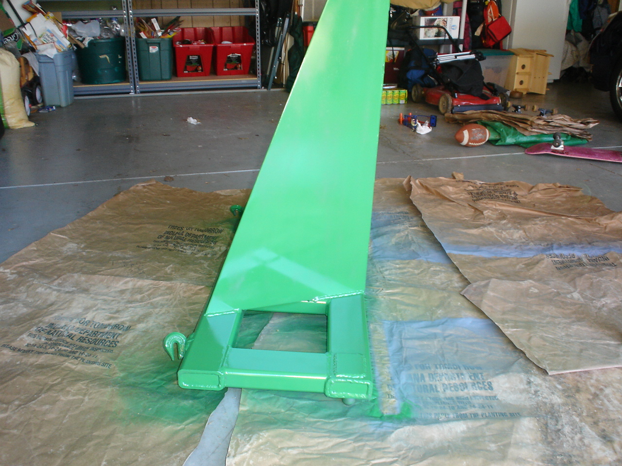

Getting it painted up with primer and JD green......
Champy in the first picture that looks like an undercover brand truck bedcover over against the wall. Is that what it is. How do you like it. I have had mine for almost two years now. When I traded trucks in July I just had them change it over from my trade in truck to my new one.
Yes its an Undercover brand and I really like it. Its strong, lightweight, and easy to remove. Comes with the hydraulic lifters and dual locks. If I could just keep my teenage boys from using it as their private viewing stand when we go places!

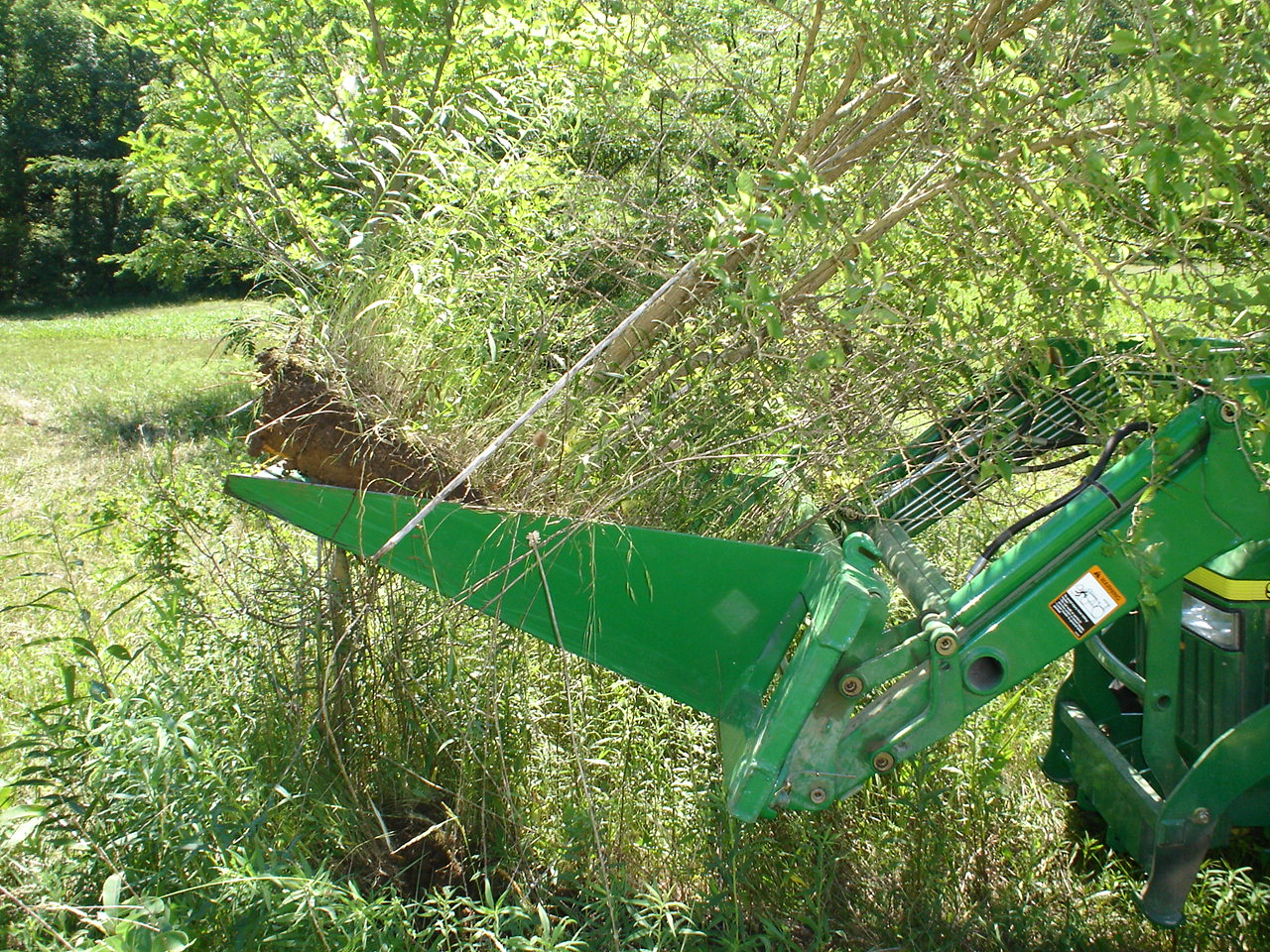

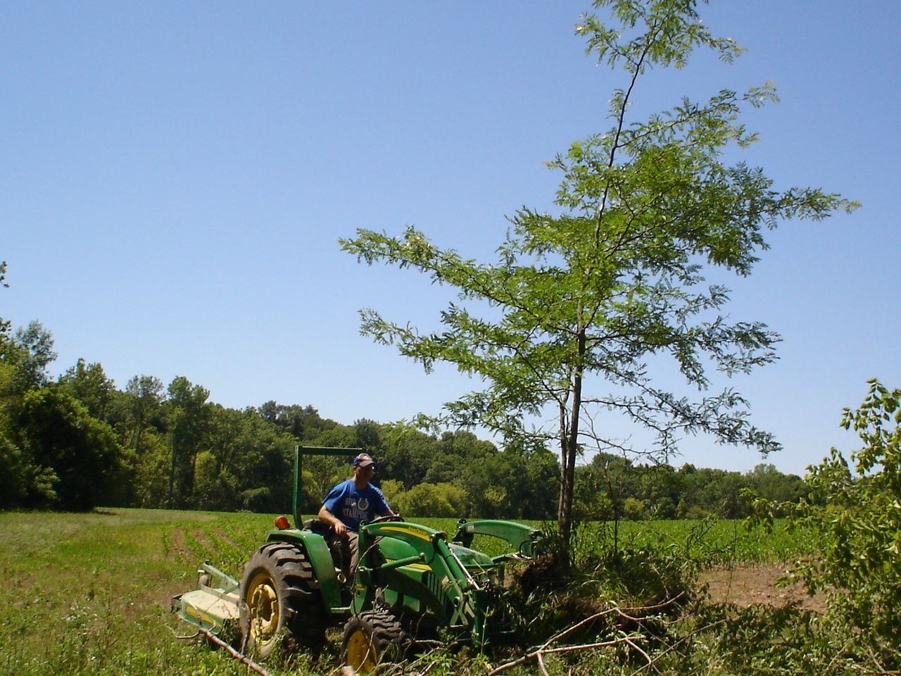

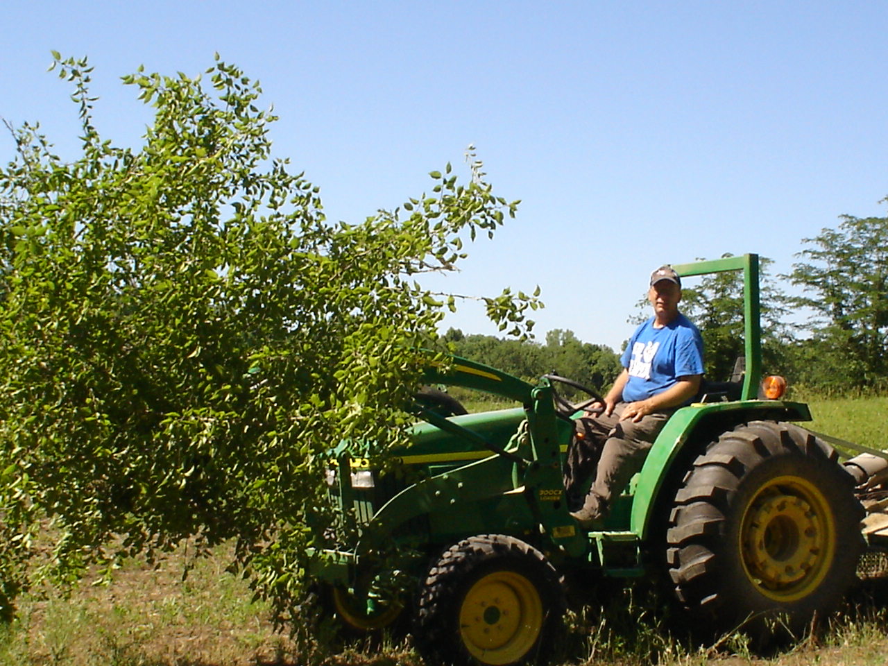

Just loading up some pictures of the bucket in action. My 14 yr old son and I spent the morning taking out about 15-20 Locust trees on our property. Yikes those things can really tear you up with very long thorns. The bucket worked great (once we got the push-lift-curl technique down), even with the very hard soil due to no rains lately.

Very nice! That thing seems to have worked out quite well. Its kind'a surprising how easily it looks to have moved some big trees. Good job on the design, and thanks for sharing. I've also printed off the design for future reference!

Daniel really likes driving the tractor; rototiller; cycles; my truck; etc.... He also took out a Locust tree in one pass and has been riding me about "taking me to school" on how to use the FEL............ it is really does make work more of a good time when he is with me....making memories.
FYI - thats him in the bucket on my avatar.....

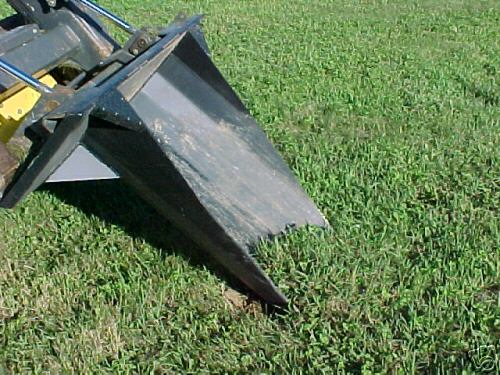

/ Built a Shrub Bucket #35

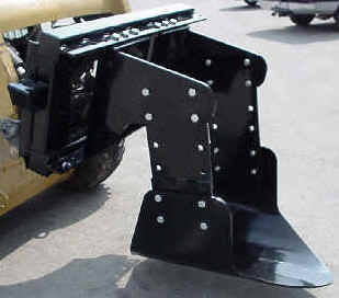

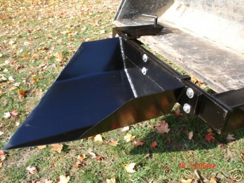

Here is the tree spade that Mr. Jimi built. This one is built out of 3/8 steel, and is 48 in long. I have used it and it works quite well. On building one of these, just cut down the size to fit your needs. The steel mill can cut it out for you, or use torch or plasma.

/ Built a Shrub Bucket #36
Thanks for the additional pics and Inofrmation JJ I appreciate it.
Others opinions/experience welcome.
/ Built a Shrub Bucket #37
On the first tree digger, the peple says it cuts roots better, the roots gets traped in the center rather than being pushed out of the way.

/ Built a Shrub Bucket #38
Thanks for the additional pics/info. J.J. I appreciate it !
