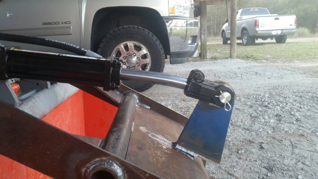

Well thanks for all the compliments but I'm afraid I have some bad news, I've already broken it. I was trying to grab a pile of brush and had the thumb half open and pinned it against a tree and rolled the bucket down at the same time and bent the rod and tore the mount off. I was a little worried about the welds on the mount tearing out being I used AR plate and I know how to fix that issue but there ain't no fixing a bent rod. Now I gotta decide if I'll cut my losses and buy a dedicated grapple or invest in a new cylinder to fix this.
/ Built a quick and dirty thumb. #25
The bend might be fixable. Can't tell from the pic.
There are operational lessons to be learned about using a Grapple. First and foremost is never apply more pressure to the cylinder and it's mounts than the hydraulics can apply. But you know that now. :)

I knew that before I just couldn't tell what the heck I was doing up there just raking around blindly. Plus I didn't know what the mounts could stand but I do now
Next attempt will have a nice fat repad between the AR and my mount, the cylinder is another issue however.

I'd run it bent till I got all the kinks with the grapple worked out. It can't get worse. Fix the weld and drive on. I wouldn't mind the weld being the weak point. Easy to fix a weld. More costly to replace a ram or other more serious damage.
When I was Jeeping we saw guys with expensive and strong hubs. They would break u-joints, axles or gears. I carried an extra couple cheap hubs-easy to change (don't even have to remove the tire) and cost very little. Same concept with sheer pins in some attachments.
Another option would be a relief valve on the hydraulics.

Had the same thought about the welding last night as I was settling down I think I'll just reweld it as is but maybe add a little preheat to the AR before I do. Here's the pics of the pin you wanted I took them then got sidetracked with broken stuff.

Reckon that tweak would press right out have seen crowd rods bent a lot more than that :eek:
Yeah I believe I can fix it easily enough at work. I'll take it and use the 300 ton press to straighten it and keep it as a spare or use it on a tree shear or something.

What Pete said. Extend the cylinder all the way and use a press. Protect the ram to prevent scratches and scrapes while in the press. Wood works best.
I wouldn't use it bent. Risk destroying the seals.

I think the consensus is "press out the bend in the rod, weld up the bracket, and go forth and sin no more!:D"
/ Built a quick and dirty thumb. #35
I agree with everyone here about having the rod pressed straight, welding it back together, and continuing on. But I think I might add a set of triangle shaped gussets to the front edge of the mount. Not only would it add extra support to hold it square, it could also act as a barrier/deflector of sorts to push it aside of various obstacles.
