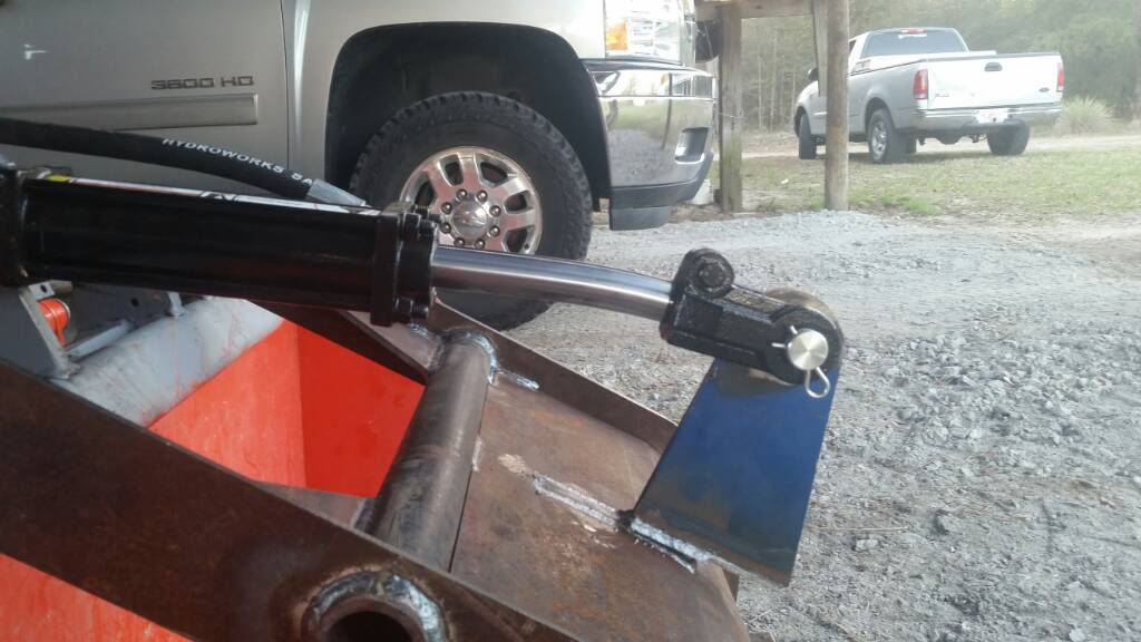

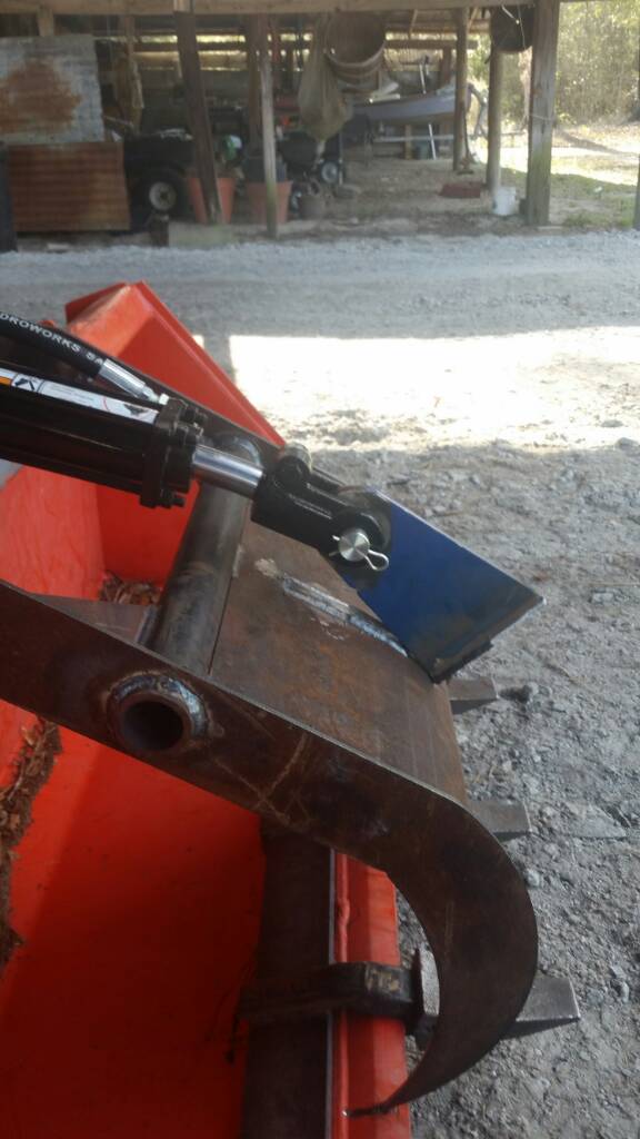

OK here's V2, dad and I talked and he felt the rod failed because the mount failed and vice versa so I welded it up proper this time. Besides the repad I also changed the open width to 36" instead of 42" and that alone made a world of difference in the smoothness of operation. The gussets are a good idea and I may add that at a later date.
Thanks for all the input guys I hope it works out better this time.

When you have the grapple in fully closed position, how much clearance was there between the bottom of the clevis on the rod end of the cylinder and the bracket on the grapple? Looking at your picture, it appears that there isn't much clearance there and if they touch that could have been what bent your rod.

Aaron, that's possible. Might also explain tearing the tab loose from the claw frame. I had it in my head that he exerted external forces on the claw beyond what the hydraulics could apply.
/ Built a quick and dirty thumb. #52
I doubt that's the case as the rod appears to have bent with the cylinder rod in the near retracted position. The rod would have bent further back toward the piston is it was nearly extended and the base casting hit the cylinder anchor. I'm pretending to be Sherlock Holmes here.:D

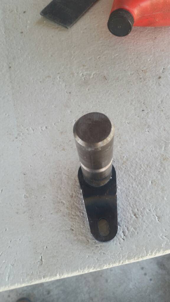

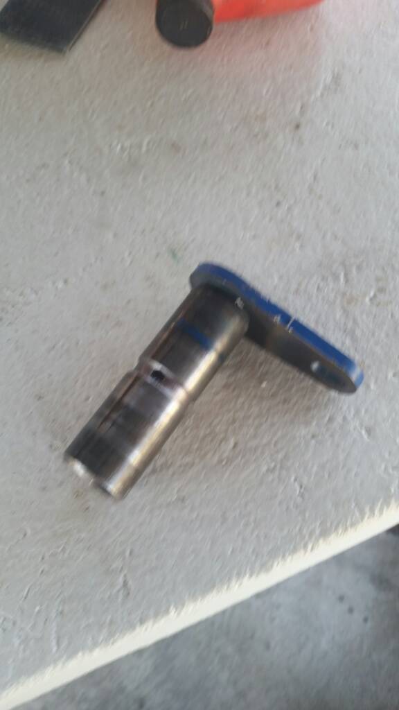

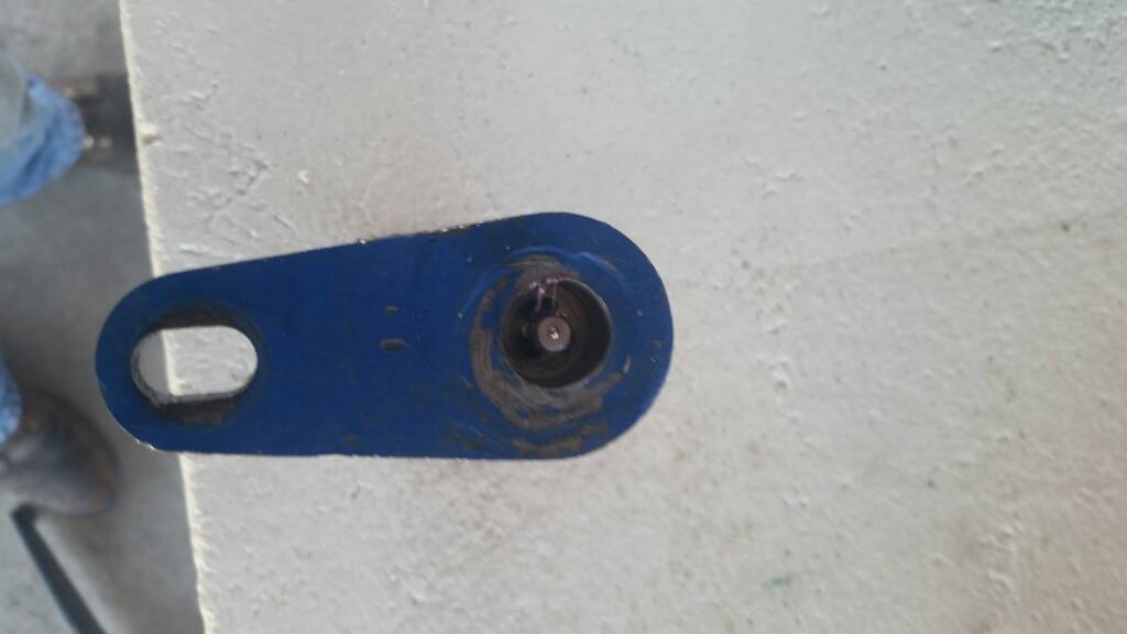

Well thanks for all the compliments but I'm afraid I have some bad news, I've already broken it. I was trying to grab a pile of brush and had the thumb half open and pinned it against a tree and rolled the bucket down at the same time and bent the rod and tore the mount off. I was a little worried about the welds on the mount tearing out being I used AR plate and I know how to fix that issue but there ain't no fixing a bent rod. Now I gotta decide if I'll cut my losses and buy a dedicated grapple or invest in a new cylinder to fix this.
I don't know what all the speculation is I said exactly what killed it in my earlier post...
