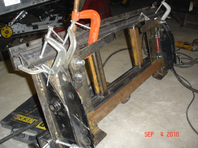

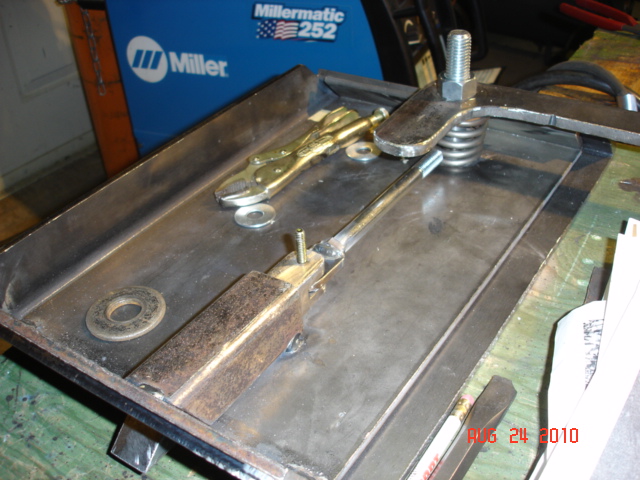

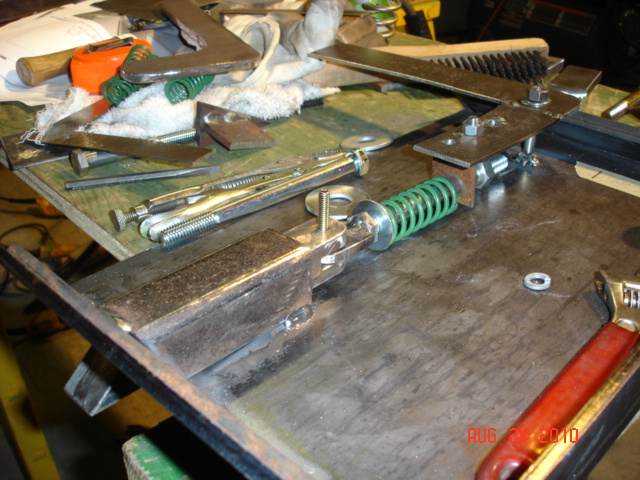

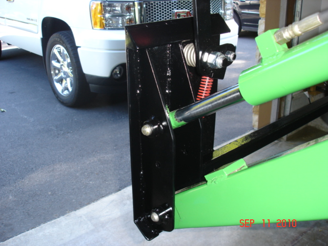

:confused:Trying to understand how the latch assembly works, copying the bobcat style. I don't know how to build it or how the spring keeps force on the latch pin. Any help or pictures would be great. I see lots of people making this style of latch.:confused:
/ Building SS Quick attach latch "HELP WANTED"

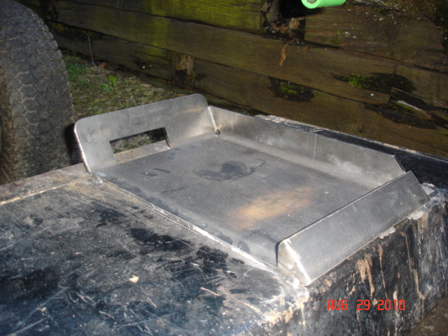

I was finally able to complete the quick attach for the bucket which I retro fitted and forks I built, THANK YOU Tractobynet and all others who I copied from. Now I hope it all holds together this was the first real project I welded of any value. I'll post a few pictures and maybe it might help someone else down the road. Forks came from ATV express with slide plates

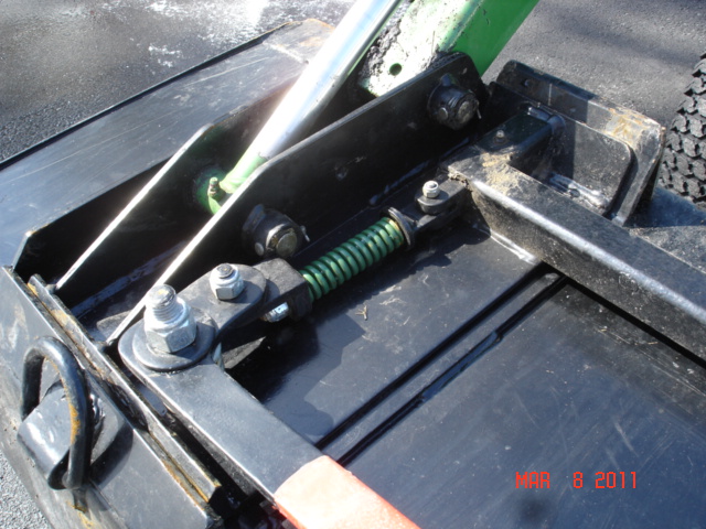

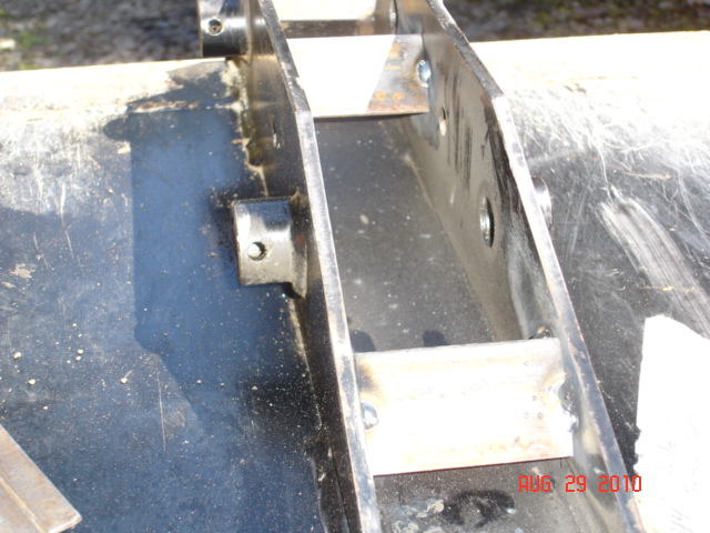

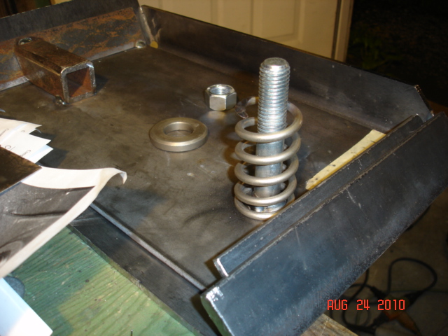

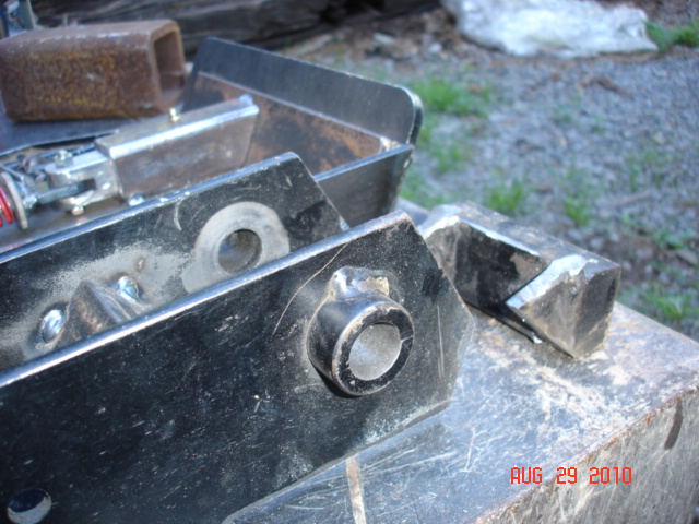

This was the part I had a hard time sorting out, and planing kinda hard just looking at pictures and figuring out dimentions.

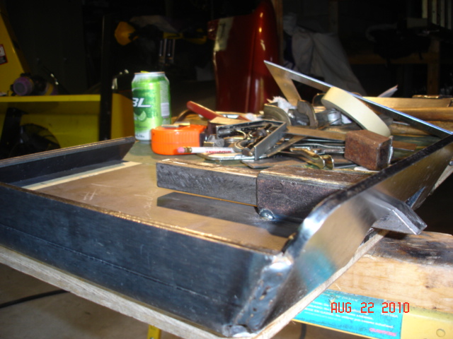

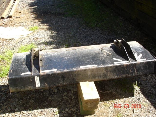

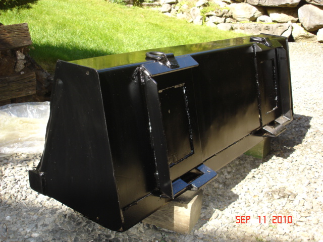

Some pictures of bucket, cut off tractor mounts I wanted to mount everything as close as possible, to save bucket power, it's a small tractor. The bucket mount plates where cut from a mount plate from ATV express, I thought I needed to start to shave some weight parts are starting to get heavy as pieced it together.

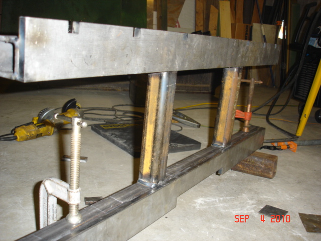

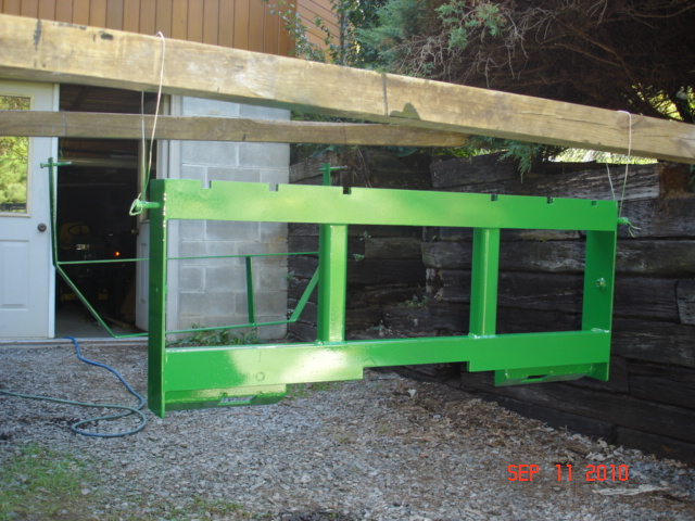

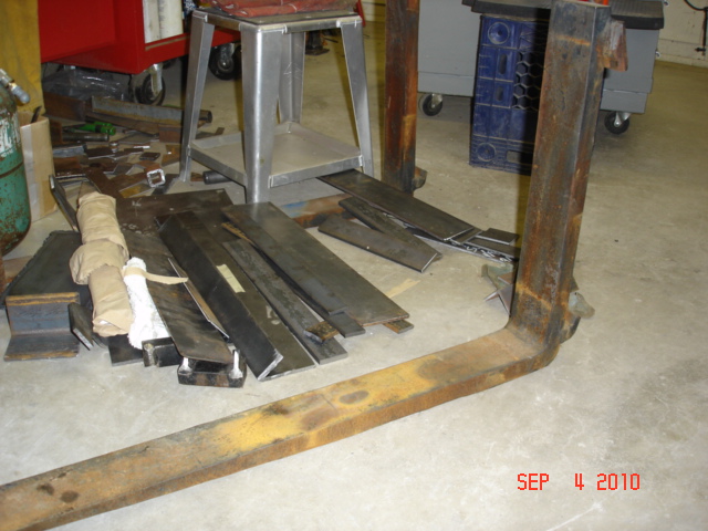

Making the fork frame so many differant variations to get ideas from

/ Building SS Quick attach latch "HELP WANTED" #10

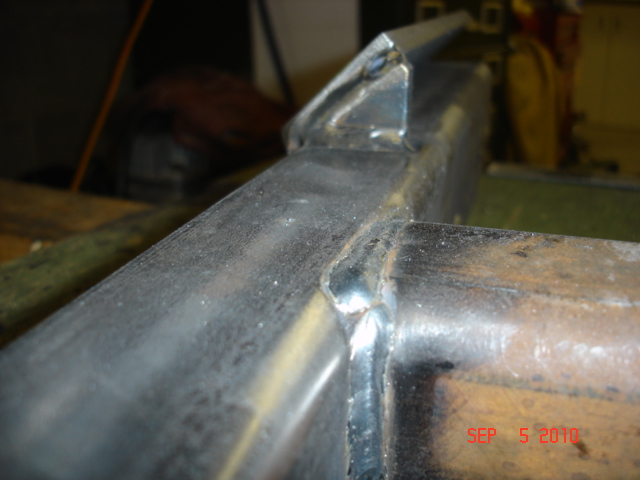

KTM010: In Post # 5, the last picture shows one side of the bucket side of the Q/A. Can I make one suggestion? I would run a piece of 1" strip, or angle iron vertically on the inside, similar to the way it is on the outside. I did a conversion on my tractor & bucket 3 years ago & just ran into a problem with the bracket on my bucket. The very top weld where the q/a first meets & curls into the bracket started to pull apart. I repaired the weld & reinforced both sides with a piece of angle iron on mine. Just a head's up.. It can be a weak spot.. Now to beef up the one on my snowplow.. I'm gonna need more orange paint!

Every time I see these SSQA, always think the lock pins are 180 out. :confused:
That orientation helps pull the attachment into place against the QA plate when you lock it down. However, on the one I built last year I am starting to have problems of the pins releasing when I back drag. Reversing the pins during construction would solve this problem. I am going to 'notch' mine so when they are closed the attachment plate is resting against a flat surface versus the angled portion of the pin. (if that makes any sense)

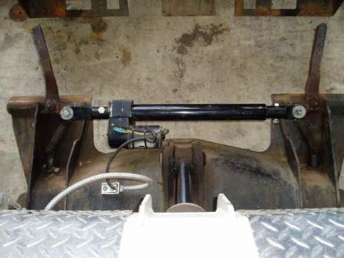

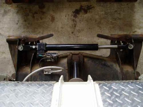

/ Building SS Quick attach latch "HELP WANTED" #13
Here is a hyd and an electric locking setup

/ Building SS Quick attach latch "HELP WANTED" #14
ohhh. i likes the hydraulic latching system........now i know what my next project is going to be.
/ Building SS Quick attach latch "HELP WANTED" #17
There is no doubt that a hydraulic coupler is nice but it is a real PIA if it freezes in the winter, you need to get creative to thaw the thing out and thats no fun in a driving snow and its 10 degrees outside.

:)Here some more pics to help plan your build with some measurements I used modifiy as needed, I wanted everything as tight as possible not to loose lifting strength and tried to keep the weight down due to size of the tractor.As you build mock everything up test then weld when all good, I had issues with bucket dumping major setback:mad: had to notch SSQA frame so boom would clear to get it to dump all the way. And then weld in some metal for a stop in the SSQA frame hard to see in the pics. Another issue with the forks was when building the fork frame I needed to add 2" to the frame so I added to the bottom:mad: mistake!! works but adding to the top would not have looked as nice but the bottom of the forks as you slide them in is even with the bottom of the frame now prone to damage, and when I remove them and go back to them the bottom of the frame is in the mud or grass, it works but would have been better extended on the top. All bad planning on my part because I had pieces cut to size and couldn't change without starting over. Overall very happy with the results:thumbsup: Sorry about the measurement picture thats the best I could do I don't know of a better way. Also spring tension started with lesser strength springs and pryed the forks off the SSQA frame taking a RR tie wall apart lots of pressure on them, also back blading lost the bucket, ordered stronger spings. Final Spring McMaster Carr # 9595K13 fits 1/2" rod or my bolt size and 4" lenght, load 331 lbs. rate 552 lbs/inch $10.55 ea.
