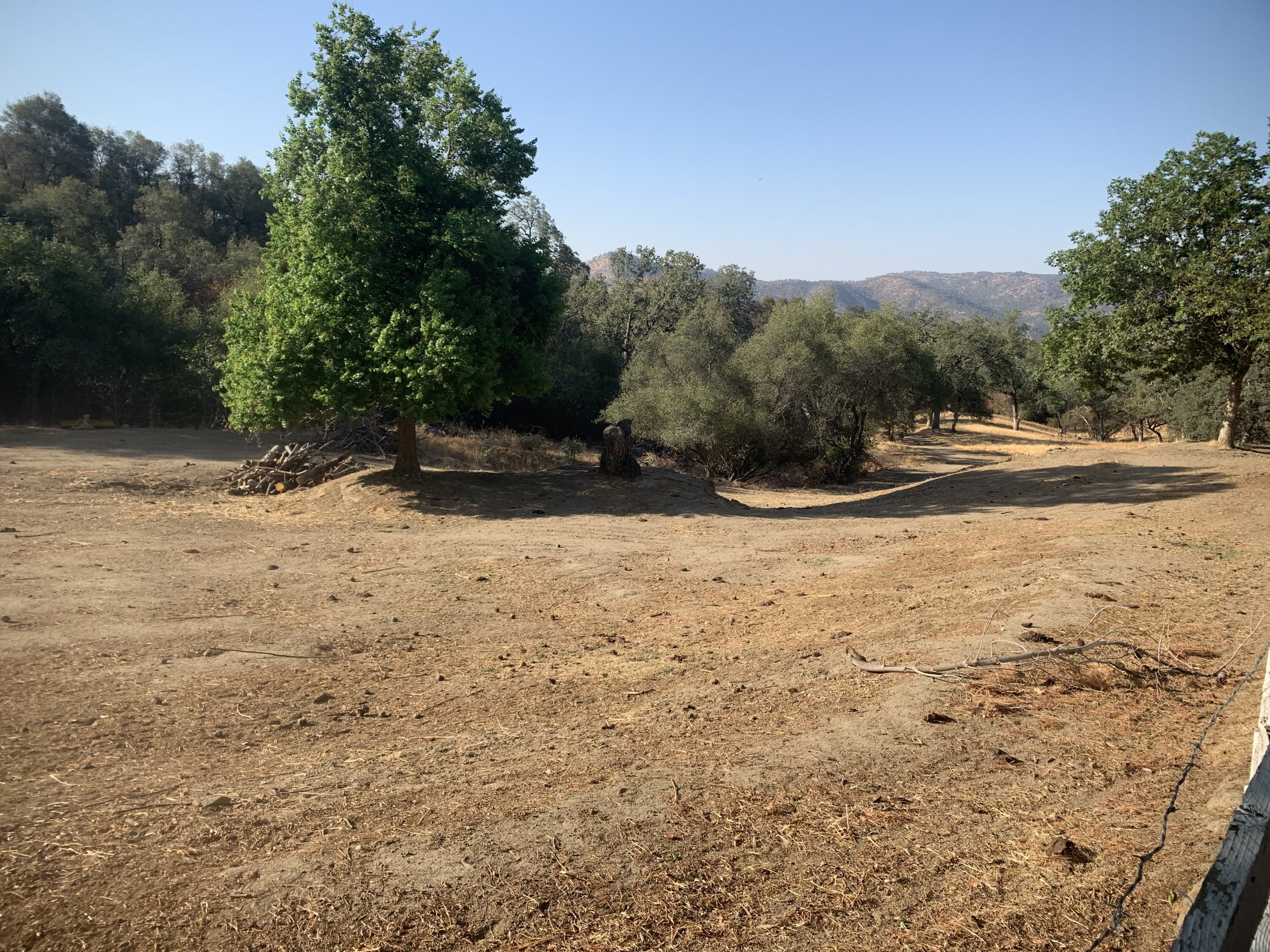

Ponytug, thanks for info. Actually, we have been planning the build for a couple of years and we have lived here for 36 years so are very familiar with just about every corner of the 90 acres. We have considered just about every aspect of the build over and over and so selected the site, the orientation of the pad on the hill, the orientation of the house on the pad, what trees to leave, what to take out, where everything needs to be (well, power lines, septic, propane, out buildings and more). A very important part of it all was selecting a plan with "view' windows and a deck/porch facing the mountain range and overlooking the valley like area where our home is located. Every plan we looked at had to have the ability to achieve that particular alignment.
There were other considerations - a CalFire compliant road to the site (with adequate turn around) and grade, location of a separate pavilion with a somewhat different view, a second access road, fencing and landscaping considerations (I drug huge boulders near the site using round poles - the Egyptian way), and we have planned for areas for a kennel and more. And, on earlier plans we did check out the view we would have from the kitchen - and wanted to size that window appropriately, but I don't think I rechecked that on the last plan we focused on - will do so.
I am comfortable we have considered most things - and know the alignment of it all - but was not sure how much clearance I should have on the front and back - it looks like I will have about 12 feet on each side after staking it today and remeasuring - that is with a depth east to west of 30 feet plus a 10-12 foot deck/porch. Now that I have thought about it a bit more, whatever plan we choose will be limited pretty much to the 30 + 12 width.
Again, my thanks for weighing in. It is a process for sure, but nice to work on it with my daughter - she is uber deserving.

On the positive side, the local fire department is 6 miles down the highway with no stops in between. When they were out a couple of years ago they said the way I had cleared things out around the perimeter of the main 'compound' made it totally defensible. And they told me my location and the slope of the hills behind us would also be a help with how the fire would run. Again - that was about the main house. We use cattle and goats as well in areas fenced around the outside - two weeks ago we put fencing for the goats around a huge additional area - and now I am extending that farther - had to stop when I could not get more fencing. And I scrape any other areas down to a moonscape. I will have to see what I could do on the hilltop. I am very fire-risk mitigation minded - thinking through what needs to be done every year when things begin to brown up. Last week the propane delivery guy commented how clean the hills had been grazed down, how little the fire risk was here, and mentioned that some places he goes to would go up instantly with tall grass right against the houses.
For their place, I bought two 3,000 gallon tanks with a hydrant plumbed per CalFire specs - so they can instantly connect to that - they require 2,500 gallons dedicated to fire fighting use. The way that the house sprinklers will be plumbed will be so that a booster pump on top of the well pad can be operated either by line-in power, or if that is out, by generator. The access road we cut (one of two) was to CalFire specs - with a required turn out and topside turnaround area - but the grade on one part is beyond 13% so will have to pave that section.

Again, Peter, thanks for the information - all very useful and welcome. We should be able to follow your advice re the roof and obstructions as it is a fairly simple design. I use goats where the tractor cannot safely go to create fire breaks, and basically scrape away the areas around the home area. Some years the cows and goats take it down enough - and early enough - that I don't have to do much of that - other years I jump on it and move the animals beyond where I scrape. Some pics of areas outside of home area I cleared this year.
