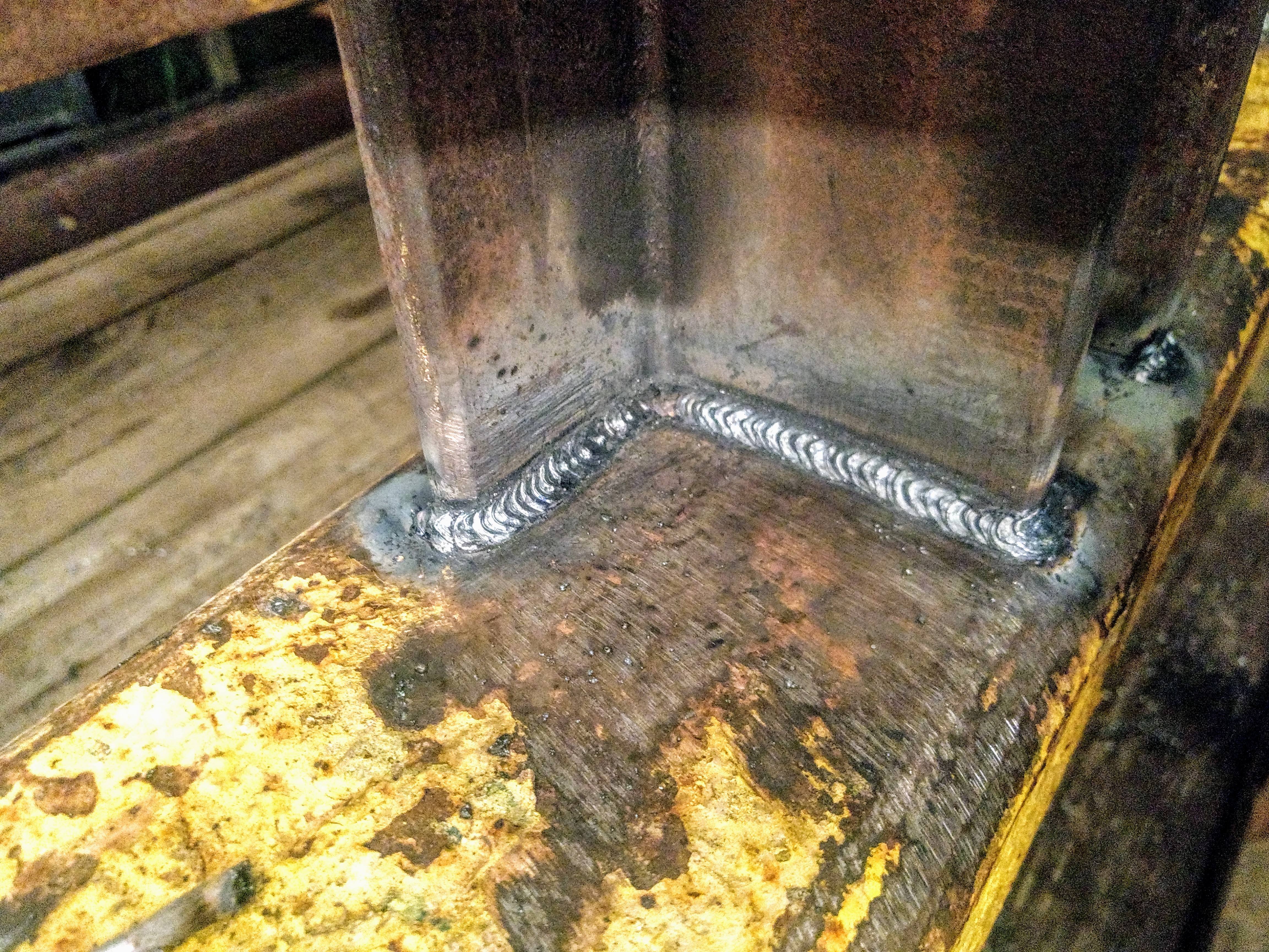

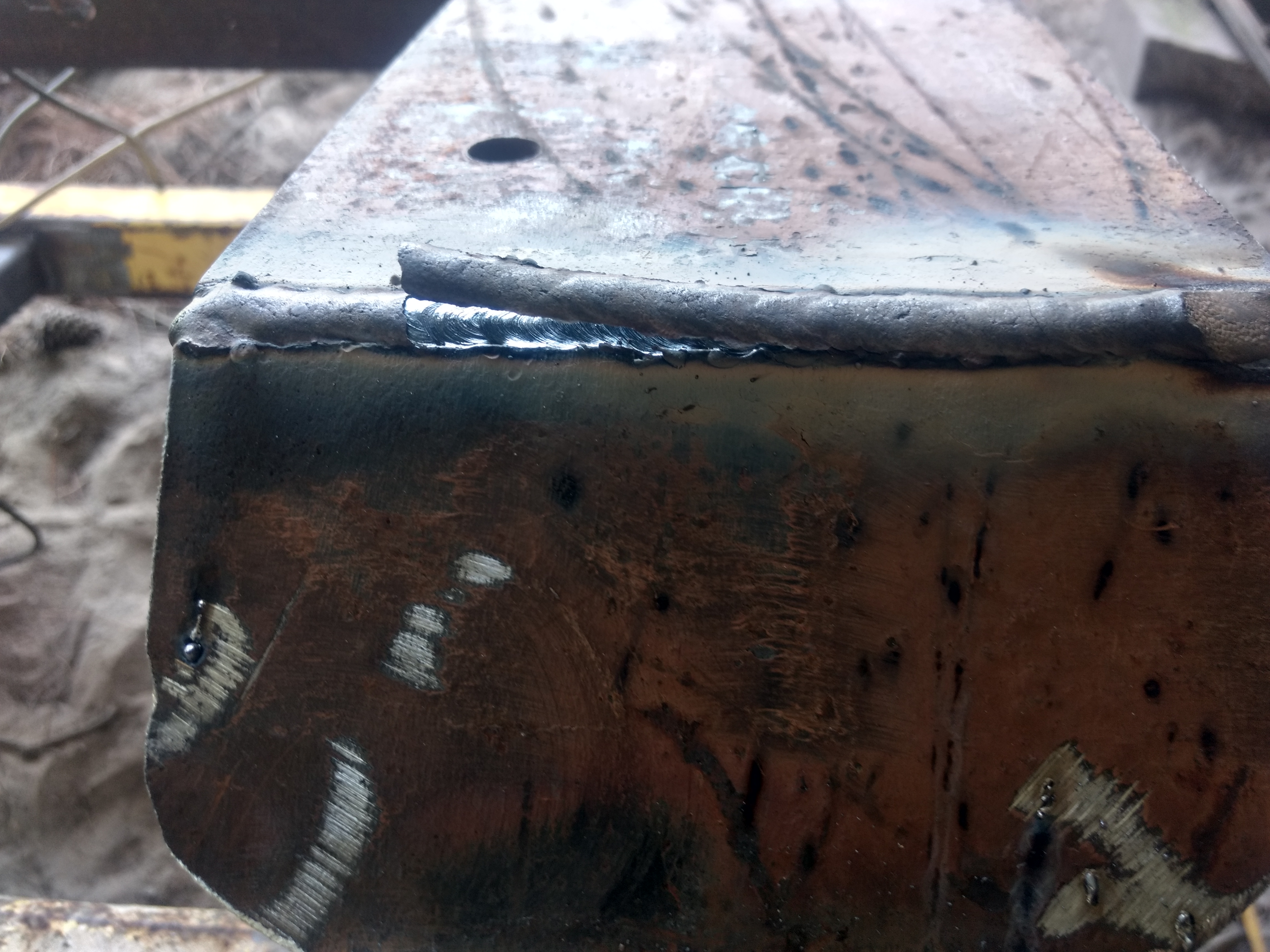

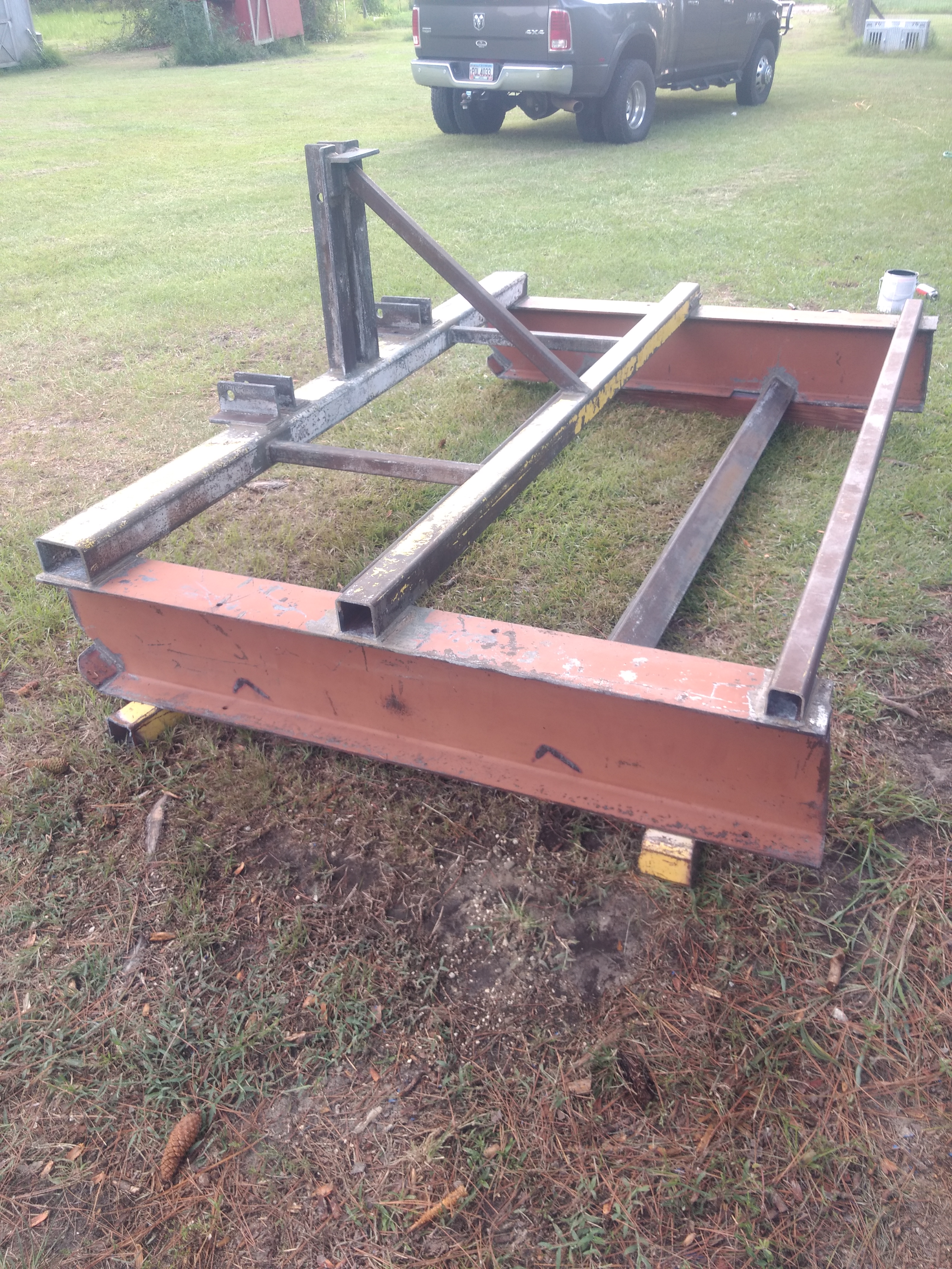

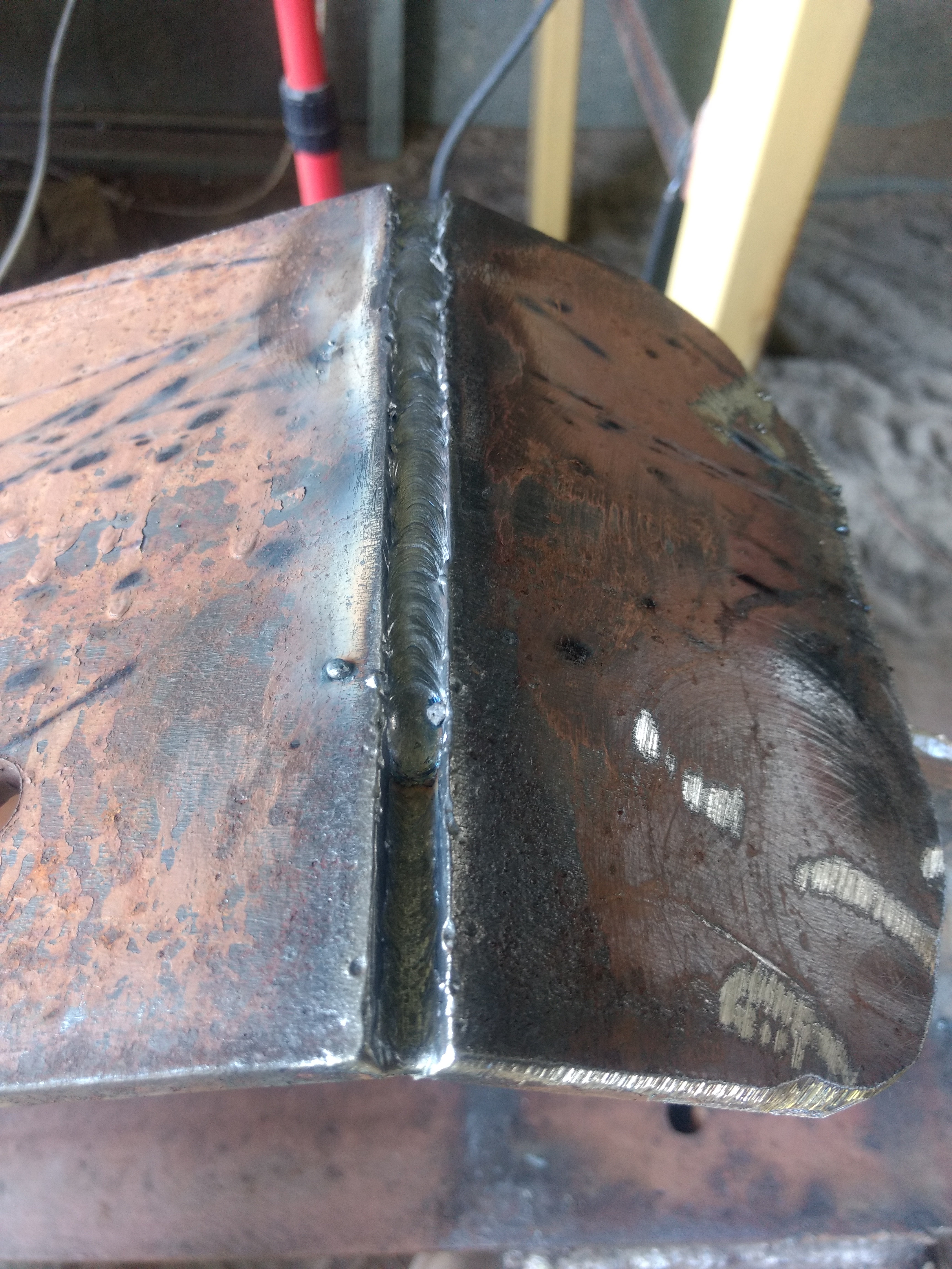

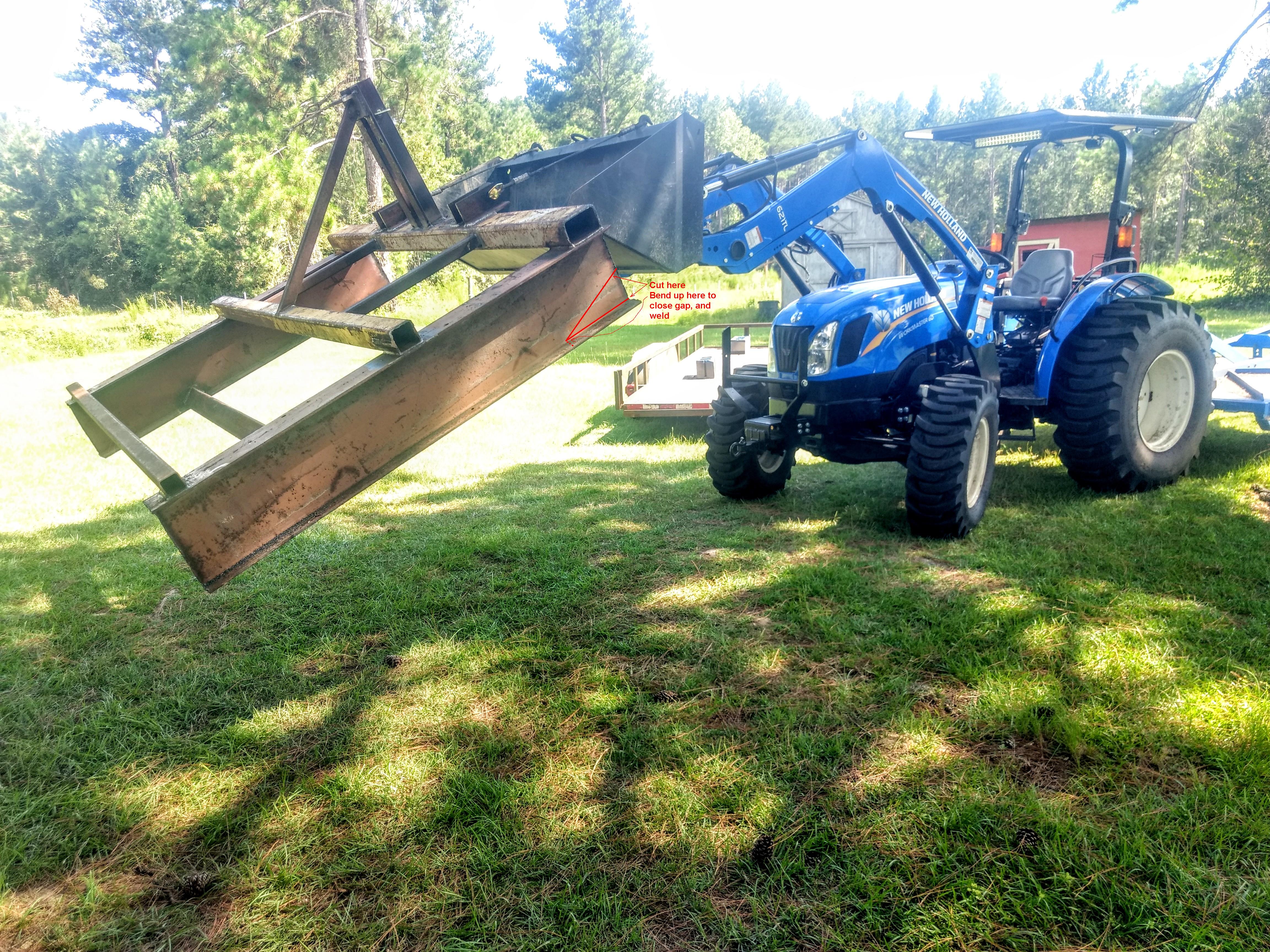

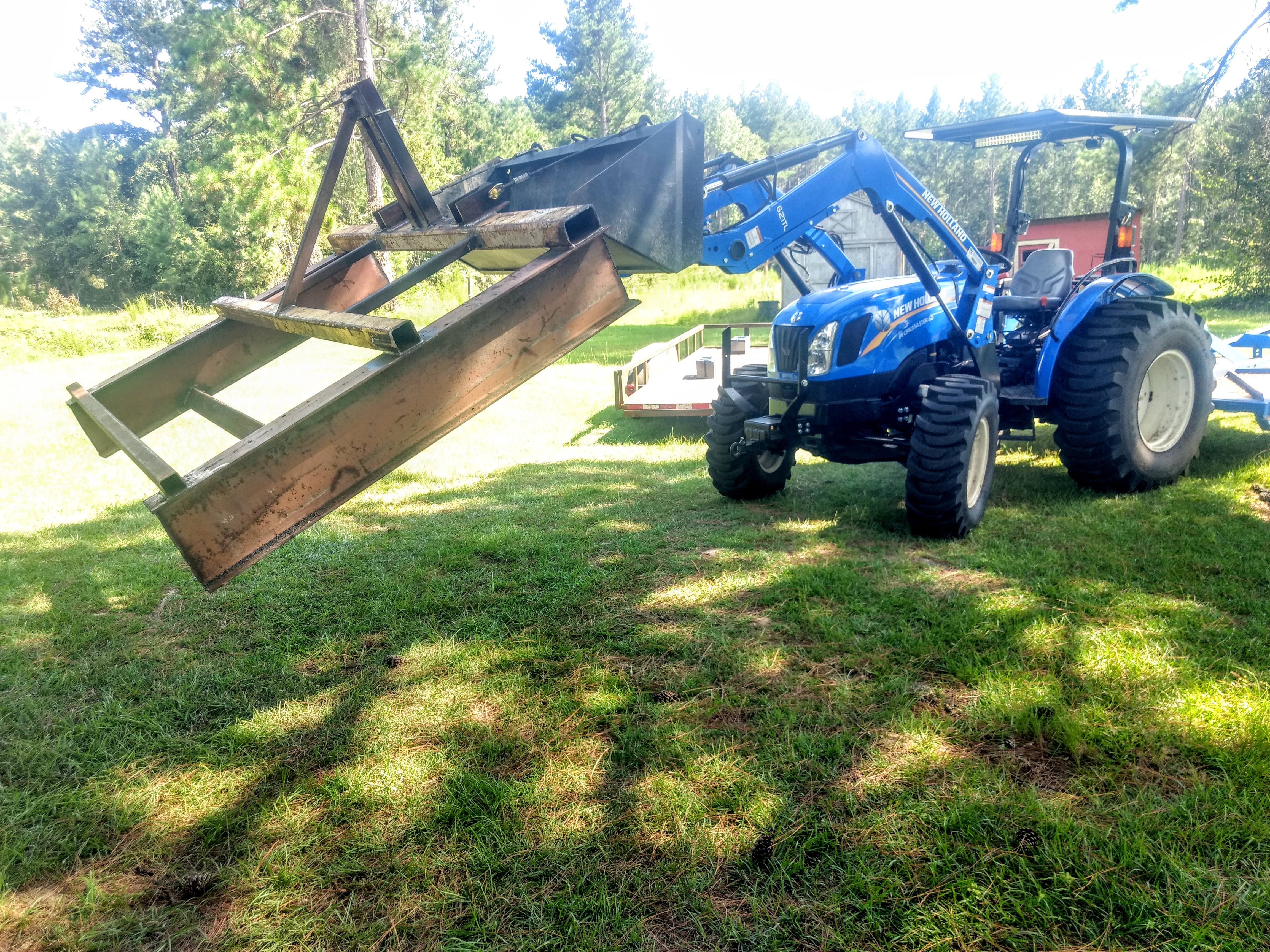

Skid is cut and angled up like a ski. Welding back in place now.
/ Building our land leveler
#42

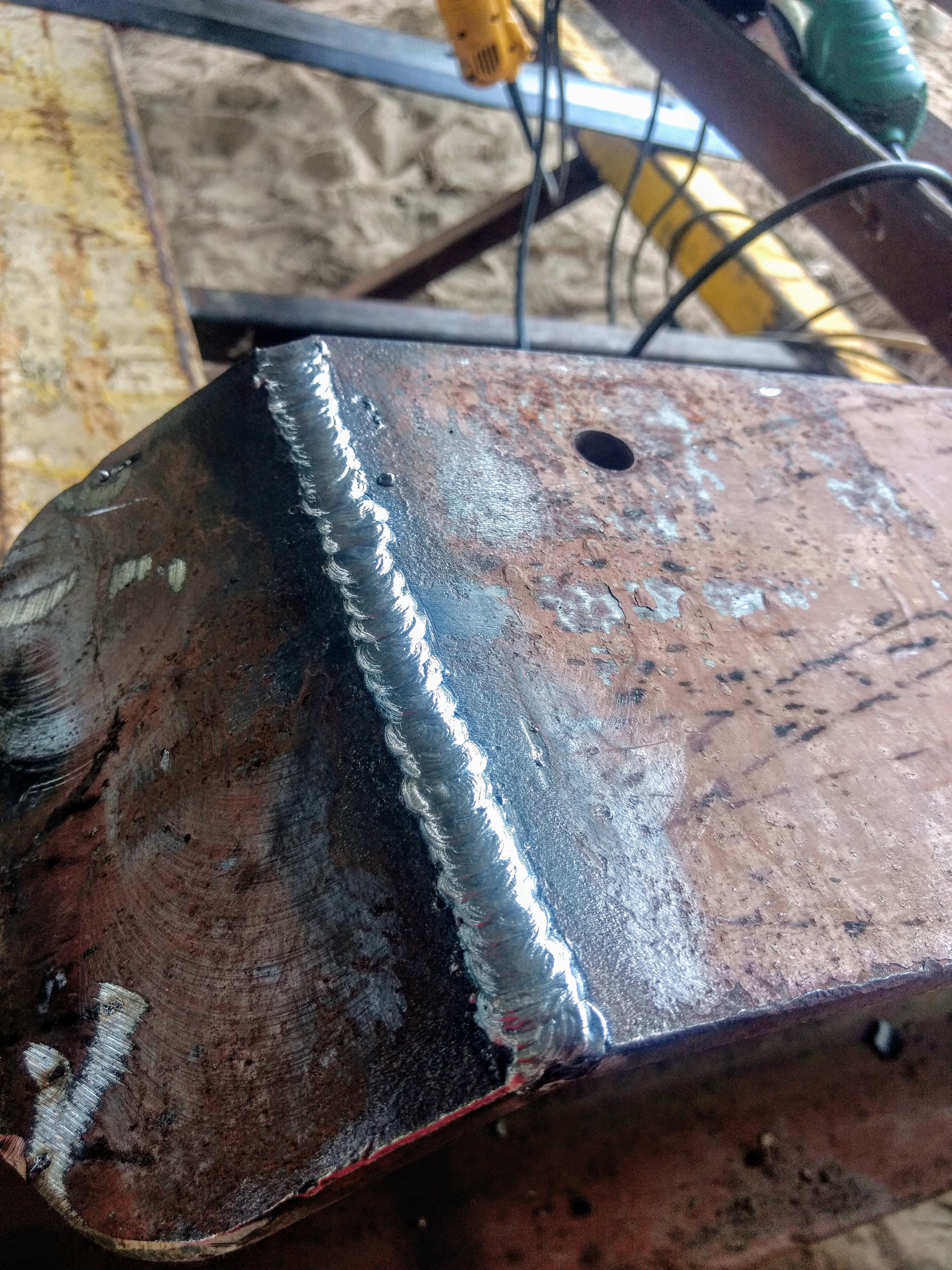

Something about this just make you smile after making a pass with 7018
#43
3 passes of 1/8" 7018 and a cap weaved with 3/32 7018. Skids are done.
#44

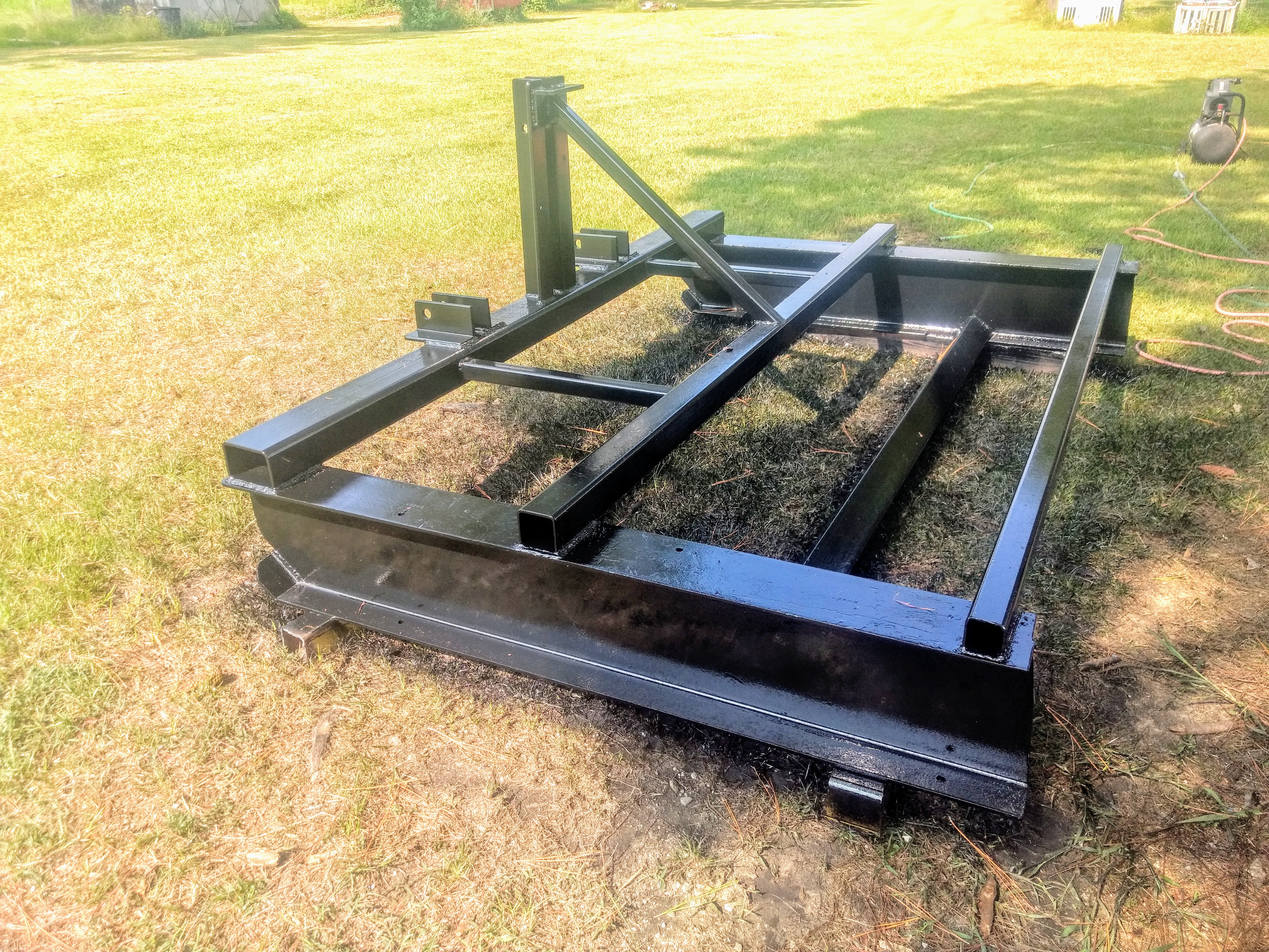

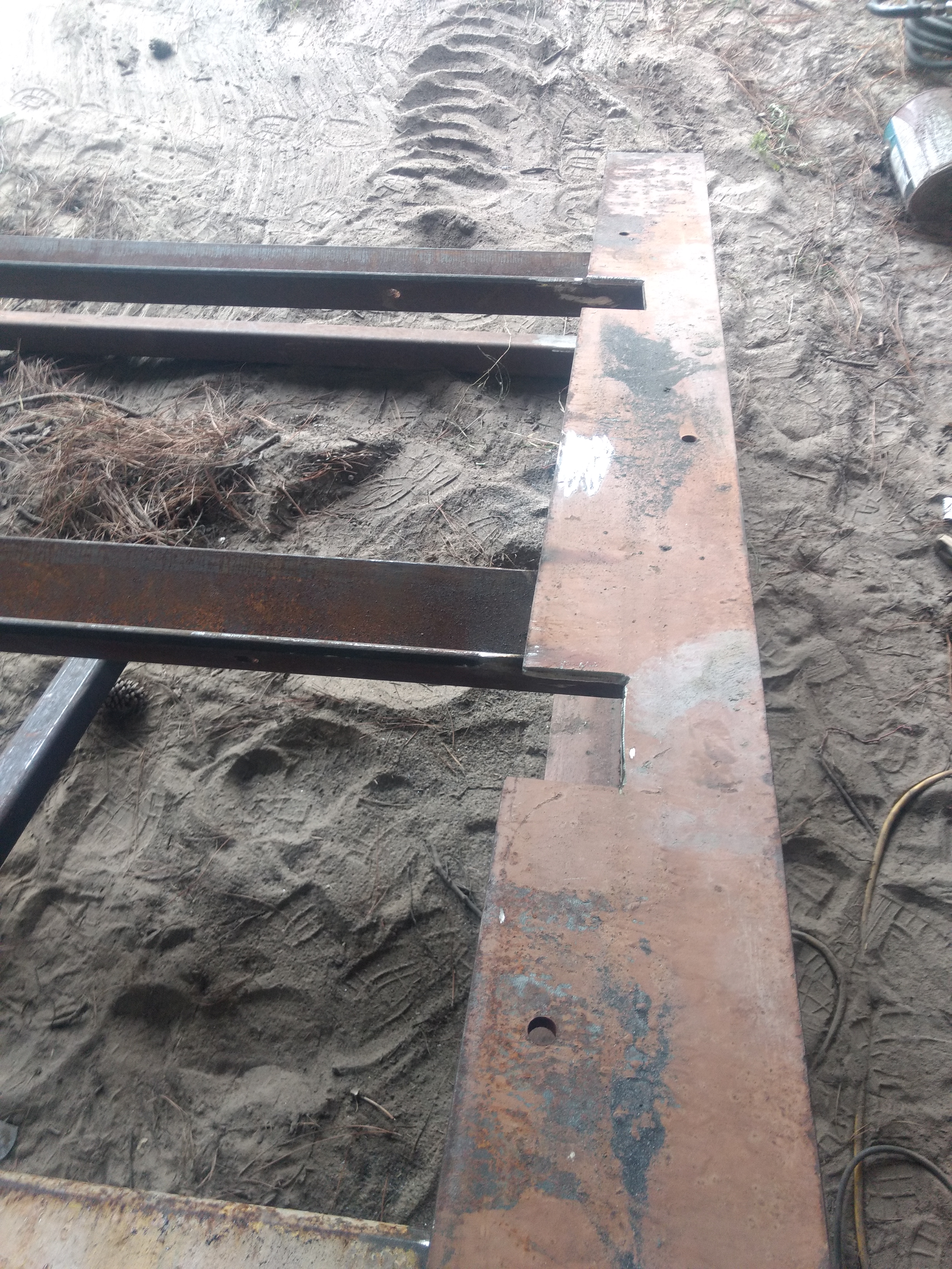

Holes drilled for my blades, decided to set them at 1/2" below skids. Rounded the sharp corners off, wire wheeled, now ready for a good bath in degreaser, ospho, & paint.
/ Building our land leveler #45
Good looking setup. Having that rear blade angled forward should help. It would be like me turning my scraper blade backwards on the final passes on my driveway.
I've been thinking of building a land plane myself. I'm wondering how well it would work to mount a roller on the back for compaction?
#46
Finally got a chance to put some paint on it. Going to let it cure about a week and put it to work.

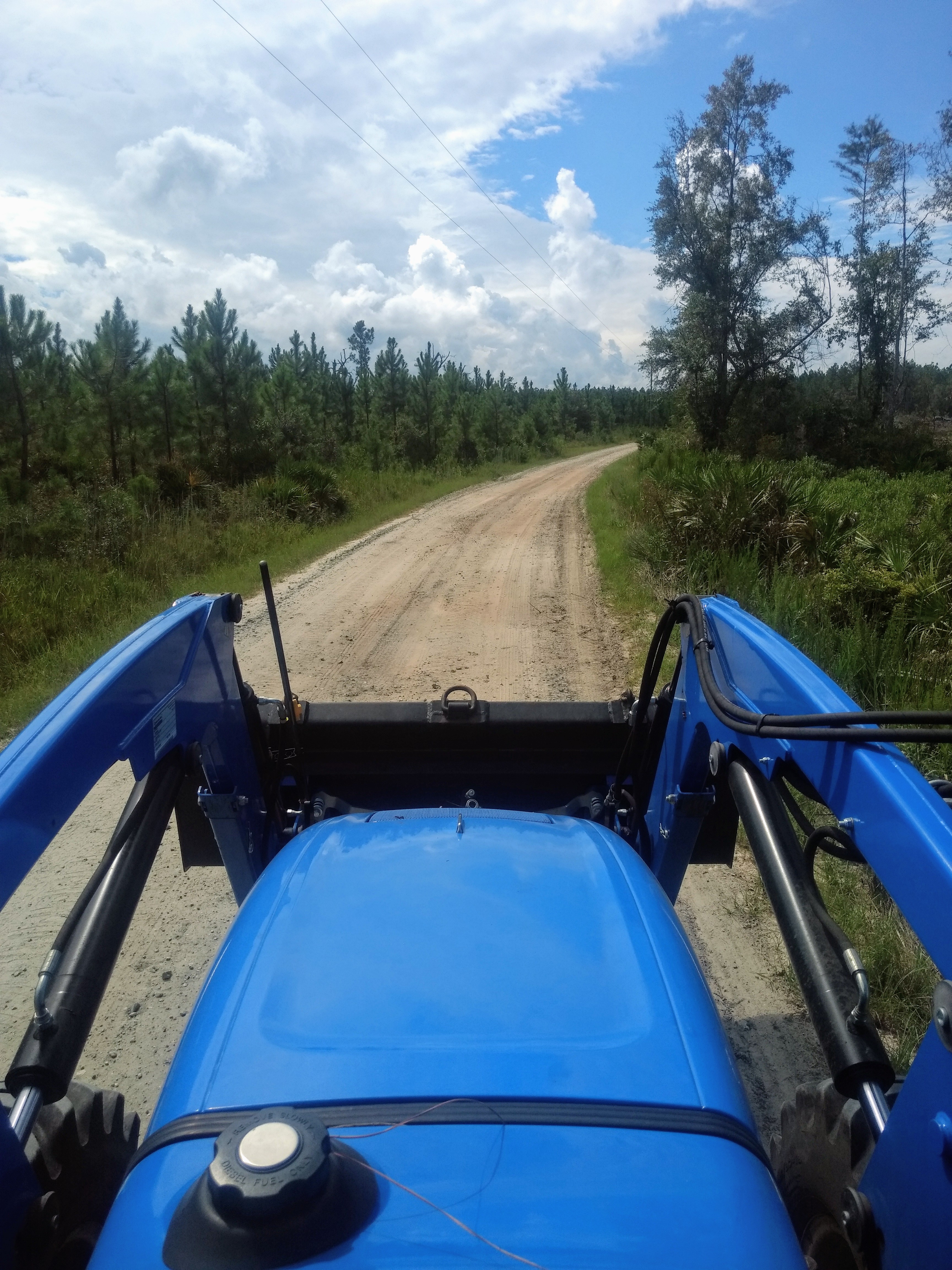

Final review after using it.
I graded 3 miles of older gravel road for a client of ours after logging his tract. We hauled just over 500 loads of wood out at roughly 85,000-90,000 lbs per load and packed most of the gravel down into the road. The final build is roughly 1,100 lbs and my blades are set to 1/2" below plane. I will say now that 1/2" was plenty, I was concerned that I needed more, but today removed all doubts. With my tractor weighing in at 8500-9000 lbs working weight without the implement it's borderline with the heavy plane at 8' cutting width when fully loaded. CADplans was right when he said it was the hardest his tractor has worked pulling his at similar weight, LoL!. On a fresh road in 4x4 after the plane loads up it knows it's there when loaded but keeps traction unless it hits a soft spot in the road then I would just bump up the float lever a tad and keep going. After aggravating the road top layer on my second or third pass I generally kept my hand close to the float function to bump it occasionally when the plane was loaded down. I will say I generally had no problem where the road was dryer, but when the dirt had alot of moisture is where I noticed the plane really loaded up and I had to bump the float. Overall, I'm very pleased with it and how it worked. The weight for it's size definitely makes it dig in and pull instead of hop any.
I built this much quicker than I planned to but now that it's done I'm very glad I did. I have 8 acres of new grounds I had cleared for our house to be built and pasture for the horses where it'll get it's next workout.
Oh, if anyone builds something similar in weight and size in the future, go with slightly taller sides. I would say 18" minimum. When it hits dirt with more moisture it doesn't flow near as well & even with plenty of clearance it still backs up towards the tractor and hits my top supports that are 12.5" from the blade slowing it from flowing over.

Before & After of one of the bad sections of road. I can see why you guys with gravel drives swear by these.

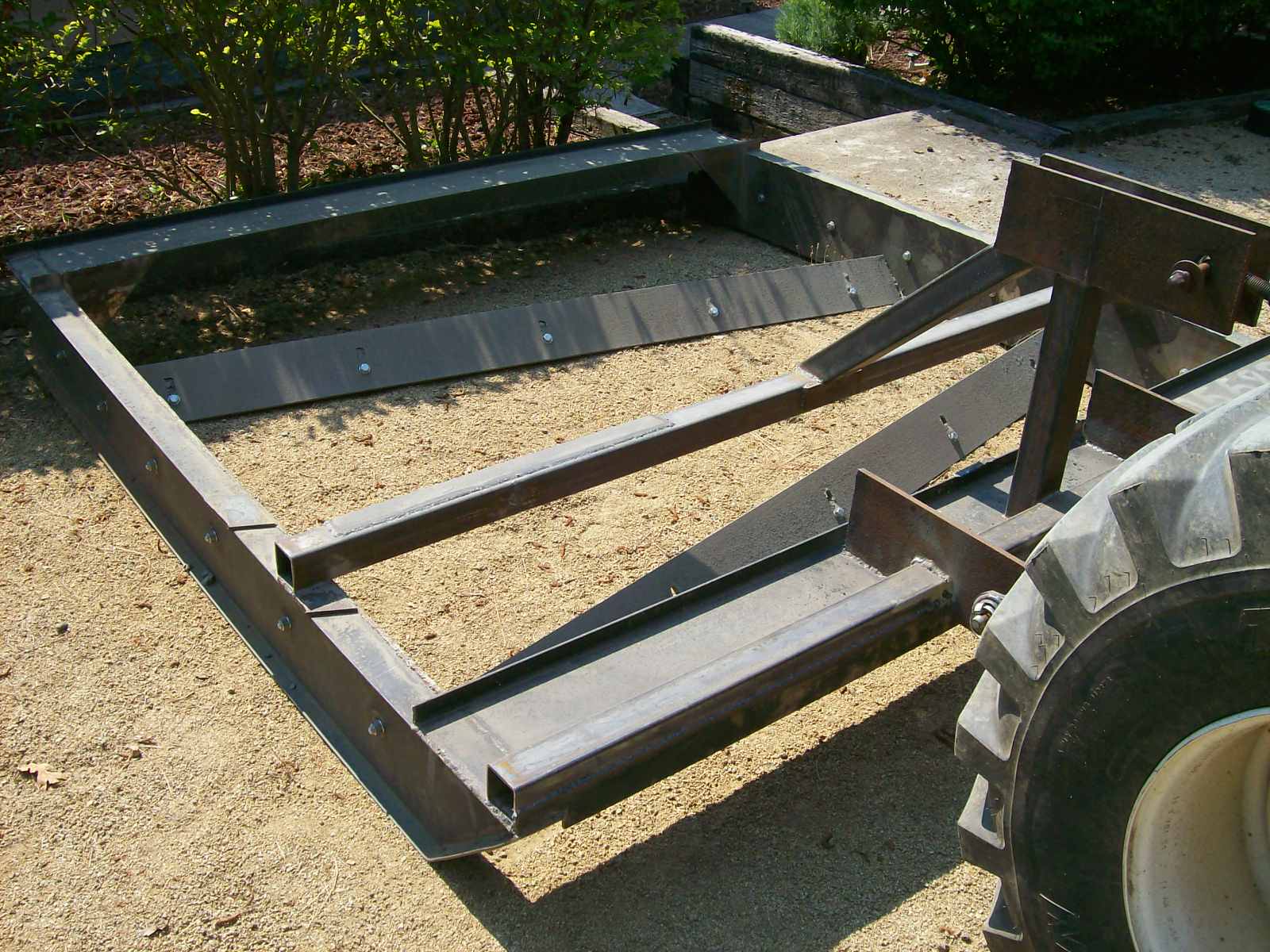

Fred H.
#52
I experimented with mine by welding on rebar pieces at 6" intervals on the front blade . Started with 1/2" rebar and even though it only stuck down past the blade by 1" if blade was even with bottom of leveler , the , what became obvious to me afterwards , amount of pressure applied to that rebar was substantial . :confused3: I eventually used a grinder and cut-off wheel to remove them as most had been bent into a " J " shape . I didn't see really any improvement in how it broke up any hard areas , thus gave up on the idea . I figured if I really needed to rip a area , I would just hook to my home made ripper I made and let it break a area up . Although only 6' wide rather than 7' , it has 8 16" ripper shanks that work pretty good .
Yours looks awesome . Never got around to painting mine . Great work :thumbsup:
Fred H.
I have enough 1/2" metal left I thought about welding ripper brackets to the back of the front 4"x6" brace. But with how it pulled up gravel from this hard packed road i don't think I'll worry with it now. Probably the worst it will see. But I will say it might would come in handy in places with alot of grass growing, it did try to clog up the material from flowing a few times.
About the paint, appreciate it. If I didn't do it now I never would. Lol
