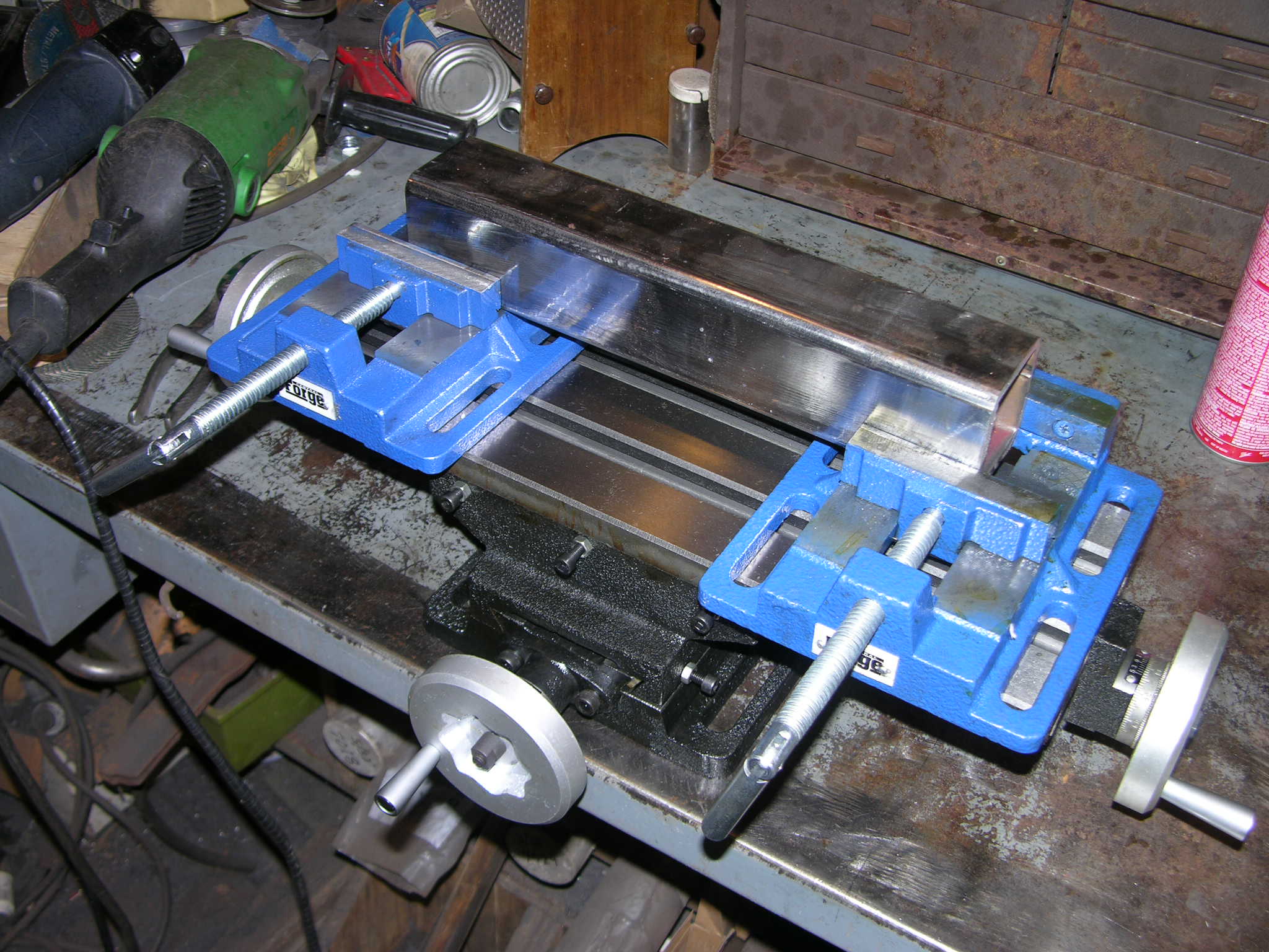

That's probably gonna work out better for you; if you haven't used a mag drill before, the cutters do NOT like to be "babied", it'll destroy 'em a LOT faster than pushing 'em a bit - Lube and a noticeable "bogging" of the motor is where they work best, no "hunt and peck" if you don't wanna buy new cutters sooner than necessary...
I've used my mag drill even more than I ever thought I would; so much so that my "drilling station" has evolved into one with 3 vises and a dedicated "table" that's 3/4" thick (mag drills REALLY like thick metal to grab onto so they won't break loose during drilling)
Here's a pic of my setup - the two small drill press vises are mounted on a grizzly x-y table, and the right side has the drill table with ANOTHER vise that opens to about 8"; the added table (gray part) REPLACES the fixed vise jaw. this lets me drill a 1-1/2" hole in a 2" square piece of steel if I need to, and the X-Y table lets me drill a series of holes (like jack stands) that're all exactly the same distance apart. Both axis lead screws are 10 TPI, so if I want holes on 1" centers I just "drill, 10 cranks, drill" - the other pics are of some "leg adjusters" I made for a 24' square roof over one of my containers - they let me compensate for uneven ground and keep the roof slope I want... Steve

Appreciate the advice, I have the drill now and hope to have some spare time to drill my holes tomorrow.
Oh, very nice set up! I can see a Mag drill in my future for sure and a set up like this would be very nice. I may have to save your design :)

Let me know if you decide to; I've several more pics, as well as part #'s and painfully long descriptions if you want 'em :laughing: ... Steve

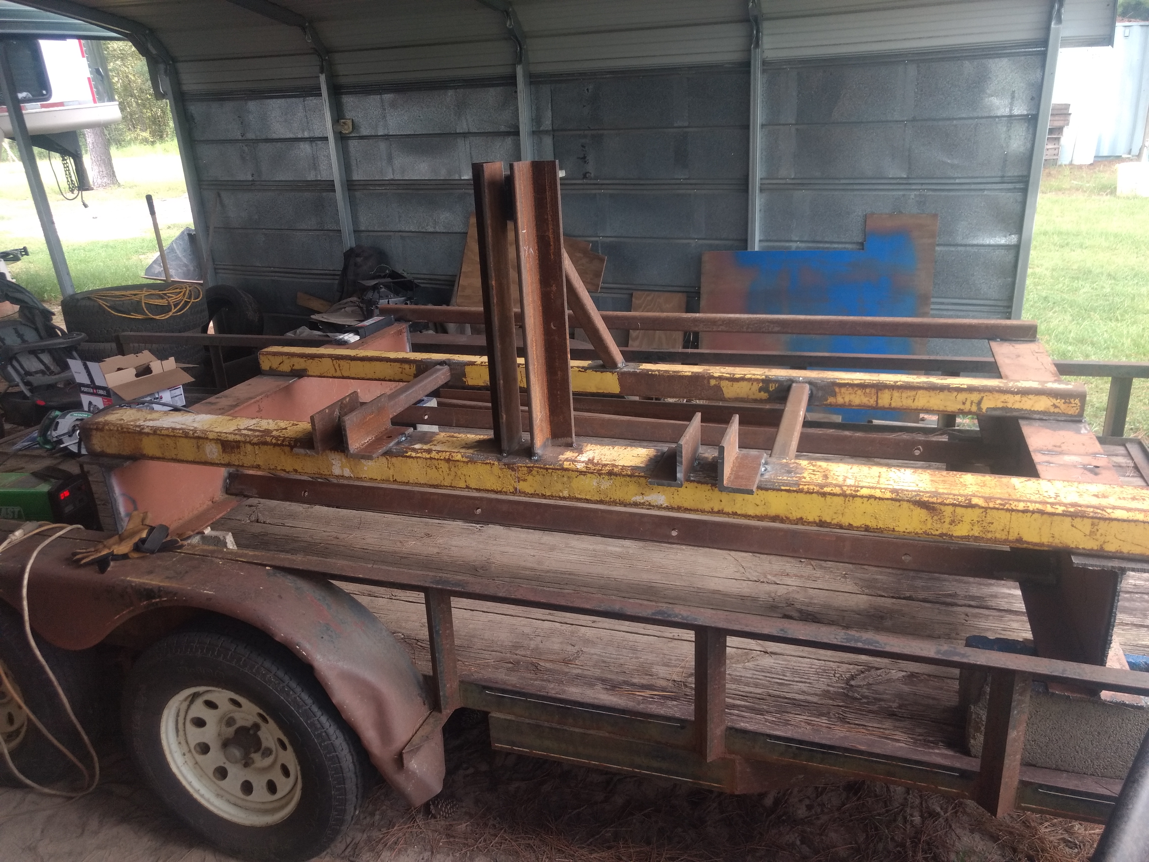

Welding the 3pt hook up brackets in. Running a root pass with some 5/32 6011
/ Building our land leveler
#29
Another of my top link post. I'll run some 7018 over these.

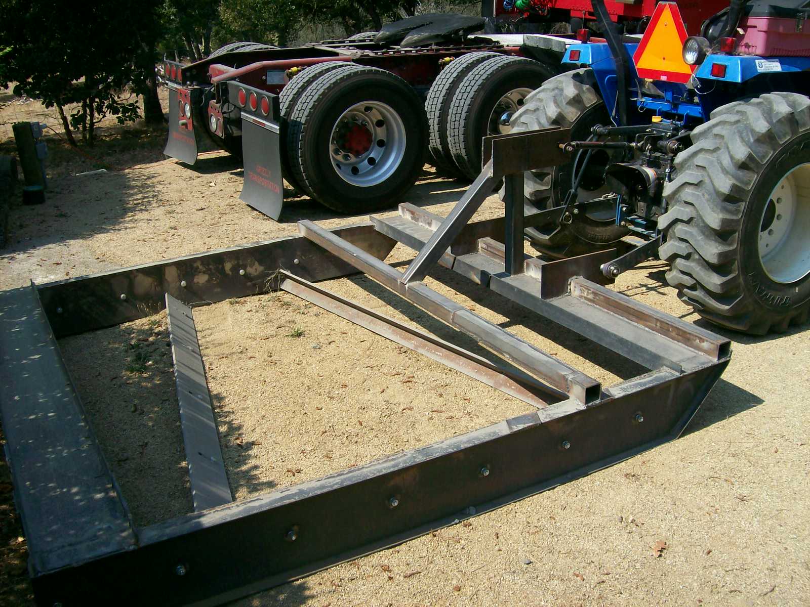

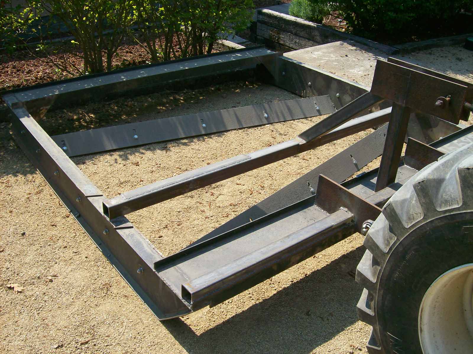

Couple of pictures of one I built a few years ago . Blades are just 1/2" flat steel by 6" wide . The blades have slots were they are bolted to the angle steel for mounting . I can raise one side up above the steel runner by at least 1/2" while at the same time drop the opposite side down by 1" or more , ( Never really measured it or have I set it that way , just when I have loosened all the bolts , I have noticed how much adjustment potential there is ) .
Use it to grade the 3/4" - 1.5" shale on our 800' of driveway .half the driveway is flat , then the remaining half goes up to a maximum of 14% . It works since it keeps the wash boarding down to a minimum , at least until everyone from my better half to son to neighbors fly up and down it for weeks and the wash boarding starts again . :confused2:
Actually thinking of removing the blade from the back angle , cutting the angle off and re-welding it on so the blade will have a forward tilt rather than the current back tilt . Thinking that maybe the first blade will level , then the back blade will level and compress shale back down . Well at least that is the plan anyway :thumbsup:
Pull it behind a TC30 and as you can see it is wider than the tractor . 7' wide by 8' + long . Blade height will influence how well a tractor of a given size will pull it . If I had 12" blades , Ugh , not sure my TC 30 would handle it .

Had to unload it and flip it to get a few structural welds I couldn't get to comfortably underneath.

View attachment 567359 View attachment 567360
Looks like You are getting there :thumbsup:
Fred H.

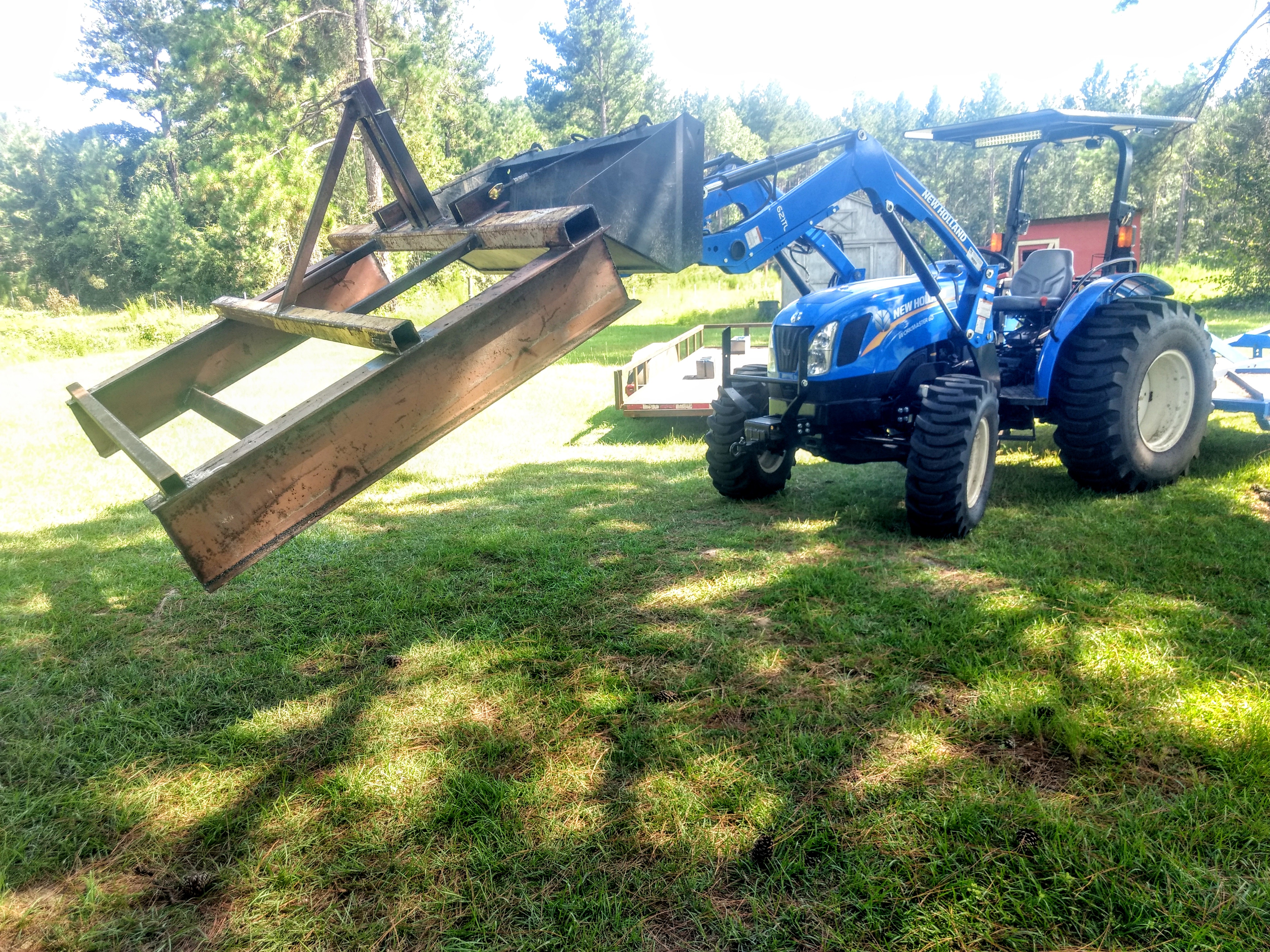

Made the cut out slots in the skids to bolt the blades in. I called it quits for the day. All welding is finished though!

Usually I only need 1/2" on one side then it tapers to 0" on other side . Back blade is then set just the opposite . The lead edge of each blade is set deep , then tapers up to other side . For me , the idea is to move rock one way , then back the other way . Now does it actually work that way ? Don't know for sure , based upon the rock build up at each blade , seems to , but in the end , the driveway is level without wash boarding .:thumbsup:

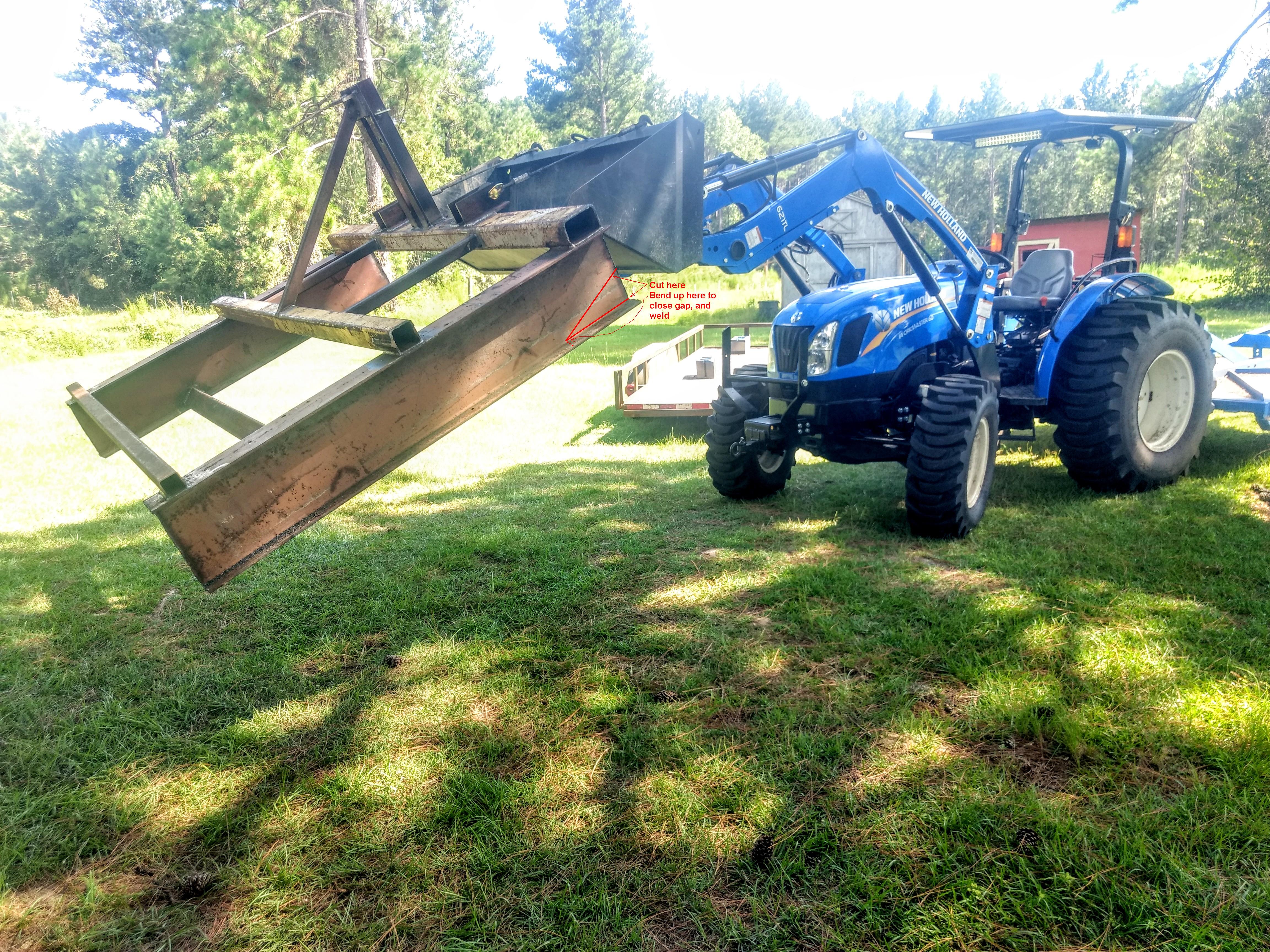

Are you gonna slice a "pie wedge" out of the runners and bend them up, then re-weld? ... Steve
#40
Kinda like this... View attachment 567473
Yes sir, that's the last thing I have left before prepping for paint. So I guess I'm not done welding yet.
