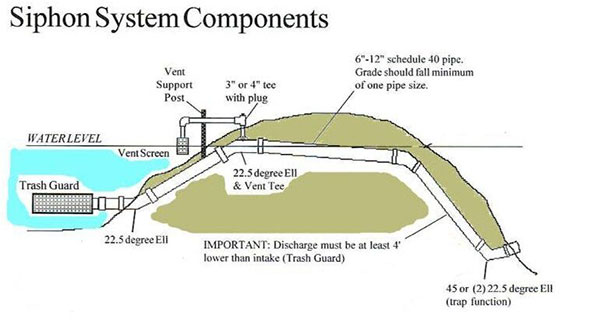

/ Building Lake Corona #439
If you setup your syphon pipe like this it will automatically start draining.
