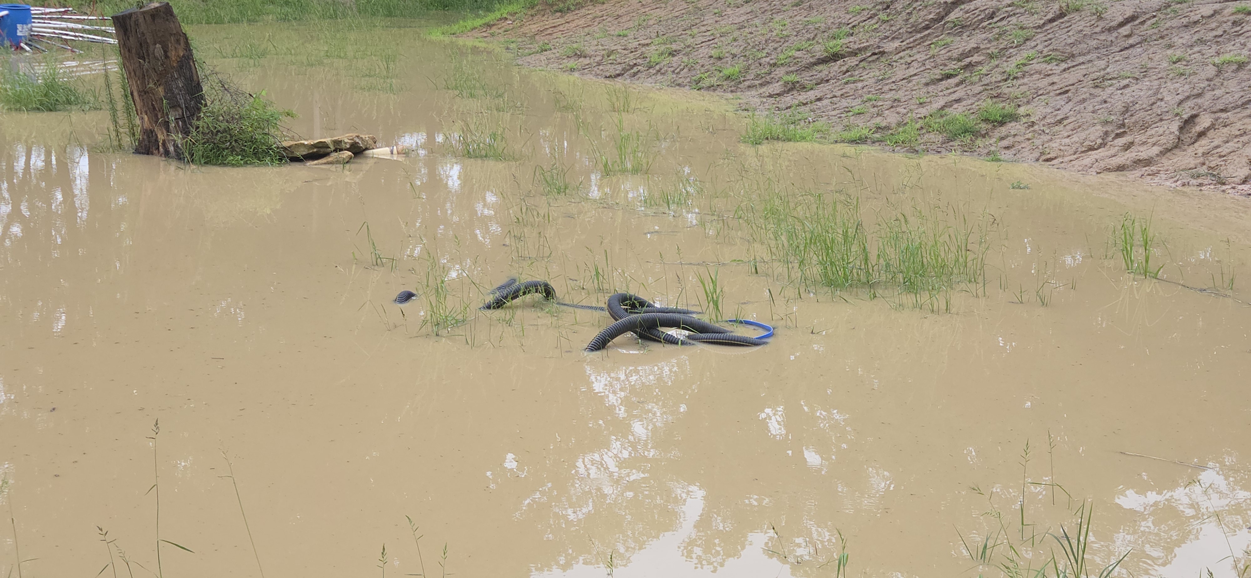

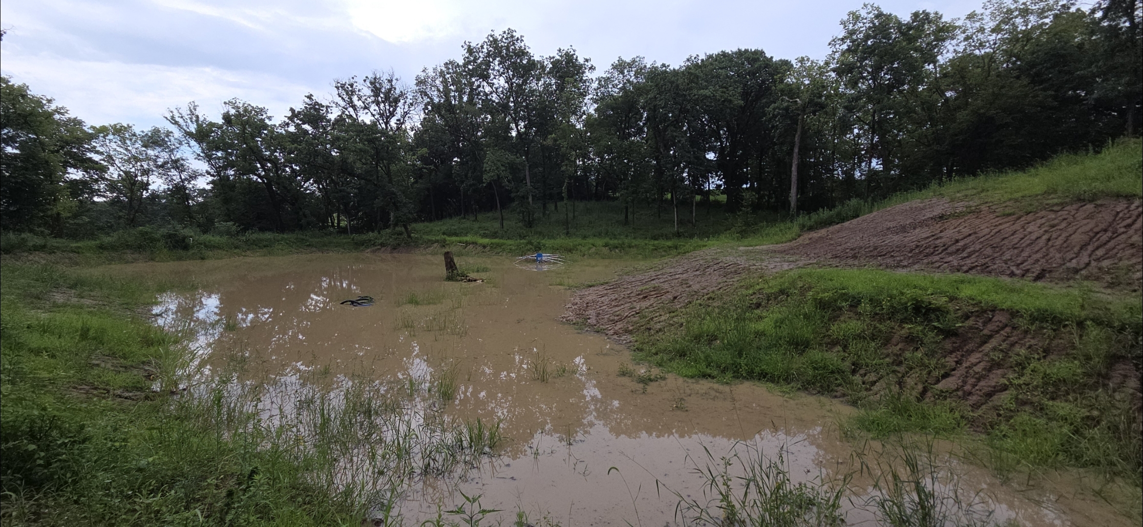

2 more inches of rain today and came down fast. Gained 9-1/2" on this one. What Dodge Man called my blue shop vacs (fish structure) is almost covered now. 4 ft to go.
   / Building Lake Corona #1,344
How many more inches do you need to be full?

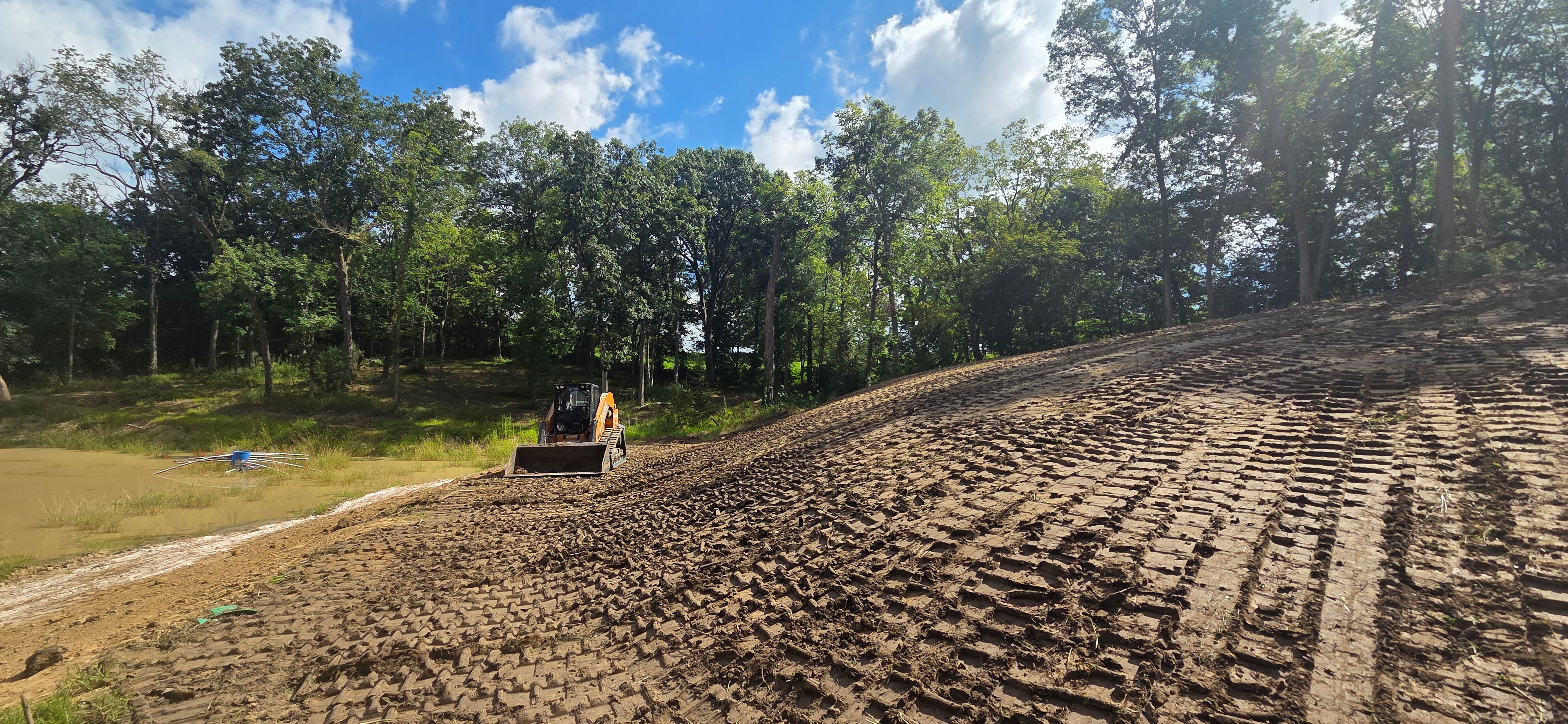

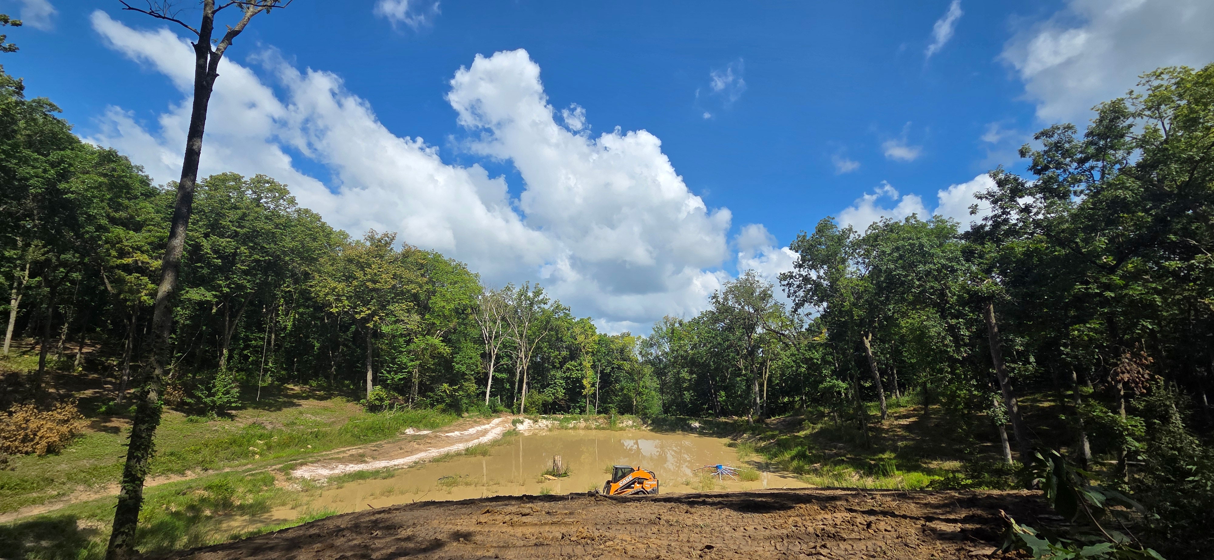

Things have dried up here so no more water progress to report. I did finally get around to spreading my pile of top soil over the hillside that I moved the clay from. Going to seed and hopefully get some cover established to prevent erosion as much as possible. Water loss is still looking good. Averaging 1/8" per day on these hot 90 degree + days. That loss is on the low end of what calcs are showing for expected evaporation loss.
   / Building Lake Corona #1,348
You probably have some benefit from being surrounded by trees that reduce wind speed across the pond, slowing evaporation.
