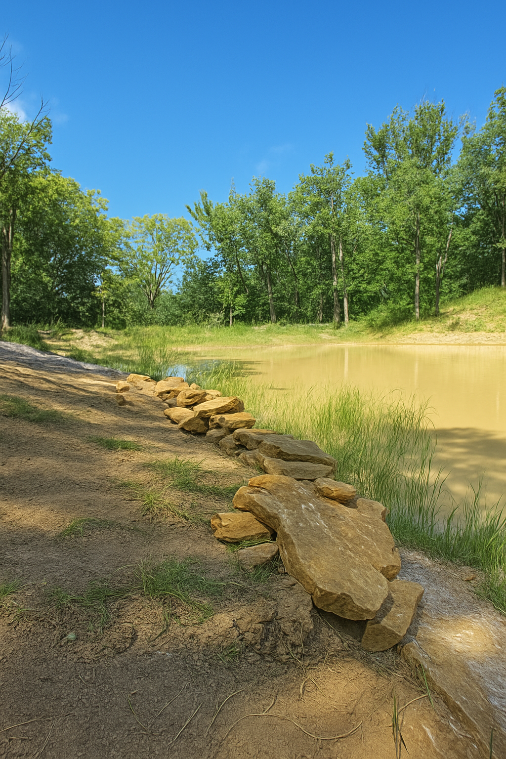

Started working a bit yesterday piling some rocks along the waters edge in a few places for some additions fish structure. These all came from digging out the pond bottom on the redo work. Should put these at about 4 ft of depth when full.

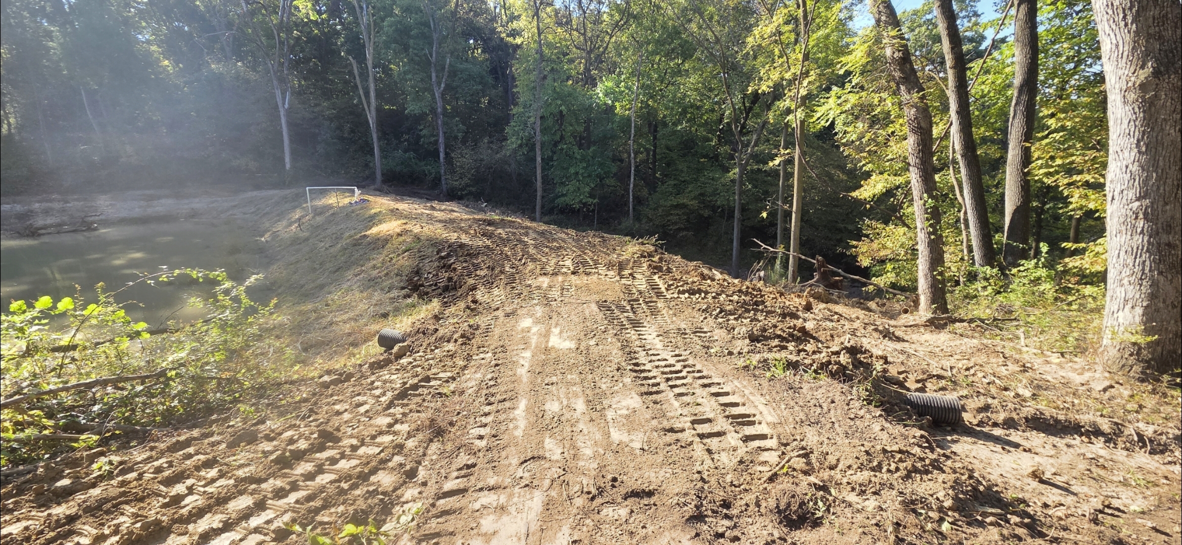

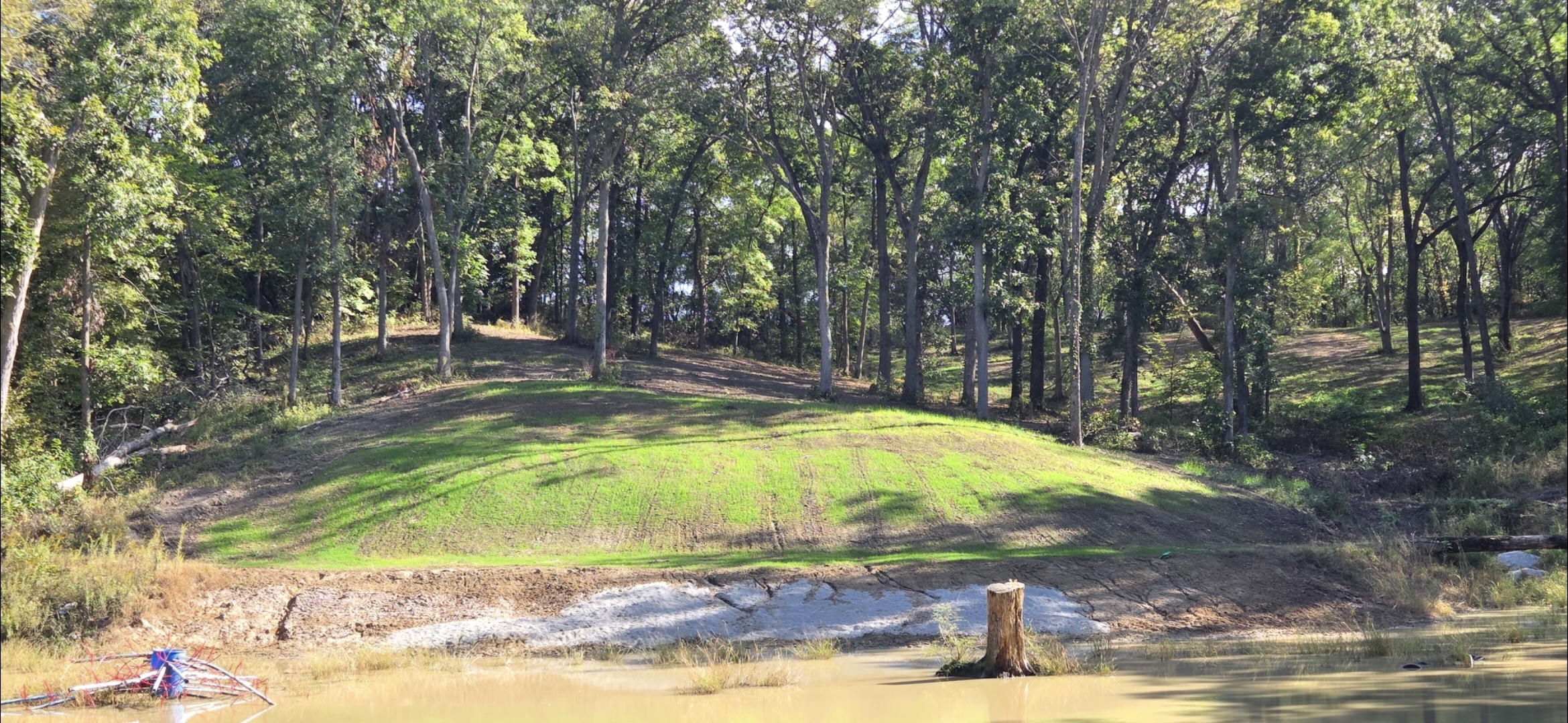

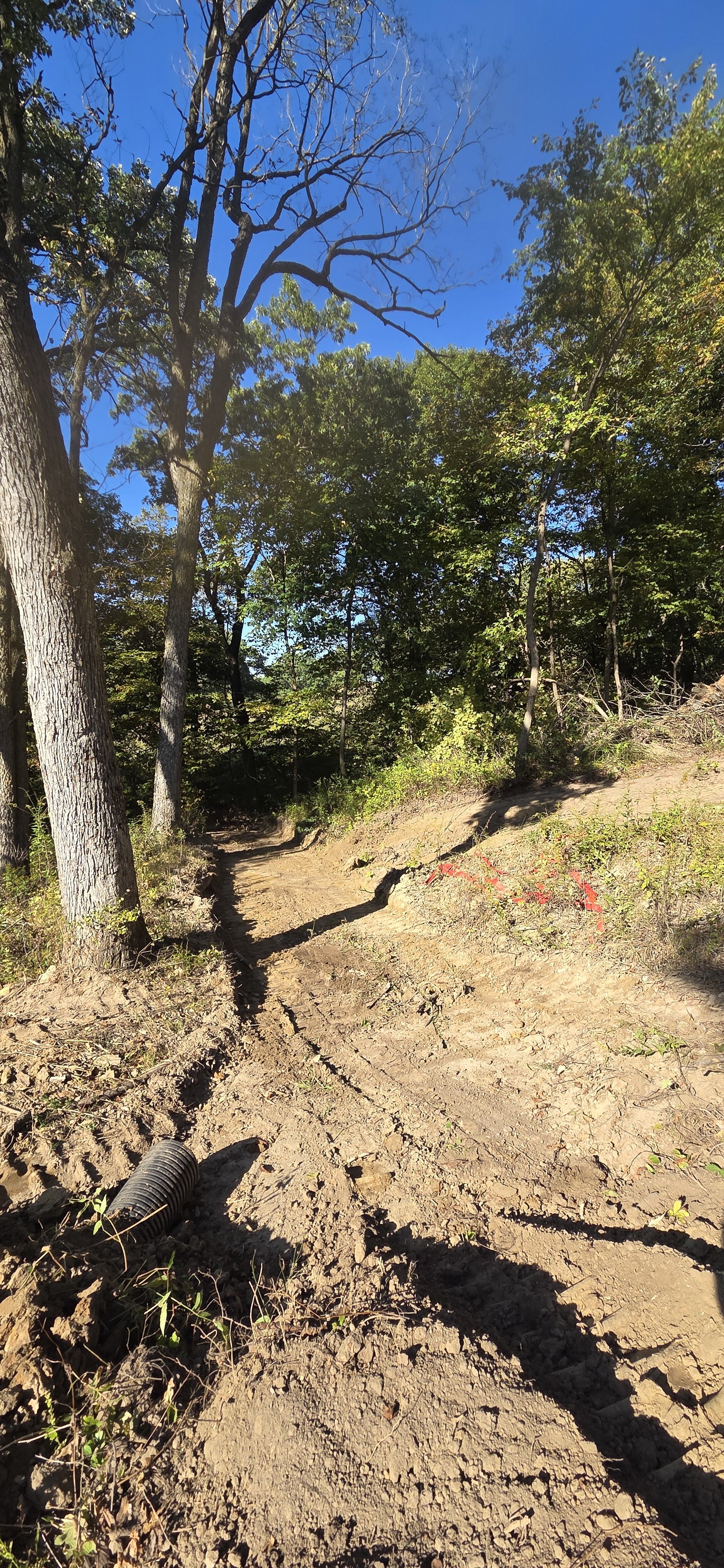

Our drought here continues. A drought declaration for the state was issued last month. Since July 31st we have had a total of 3/4" of rain. Most of that coming last week. Despite that I've been able to get some grass established on the hillside I pulled the clay from. Saving and spreading the top soil helped a bunch.
I've also spread some gravel in the 2 to 4 foot range of some of the banks for spawn beds. Today I laid a piece of 8" drain tile I've had laying around as a 2nd overflow and cut a channel for it so if it's ever used it will flow around and not down the dam. I'll be surprised if it's ever used much if at all.
Took a measurement today I have exactly 4 ft to go for the pond to be full. That means it's about 9 ft at the dam and anywhere from 3ft to 5ft around the rest of the pond. I'm only down about 5" from end of July when the rain stopped. Will update next spring/summer on any additional progress.
