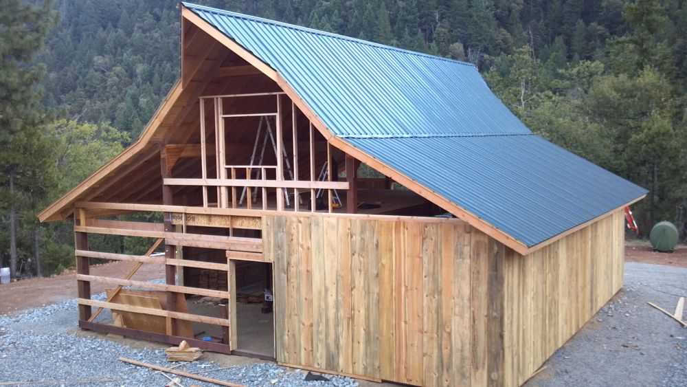

Here's how the barn stands today: I almost finished framing the north wall in the loft area. Yesterday, I bought some salvaged antique windows with divided lights. I'll use 2 of them for casement windows in the opening in the wall. (Sorry, didn't think to take a pic of them yet.) Before anyone complains about the lack of a header of the window framing -- 2x6 girts have to go on the outside of the framing before the vertical siding planks, so I'll just use a girts above the window that will act as a header.

FredH, you live only a few miles from me. If you ever want to come up and see the project, feel free. Thanks for the interesting anecdote about the barn house.
