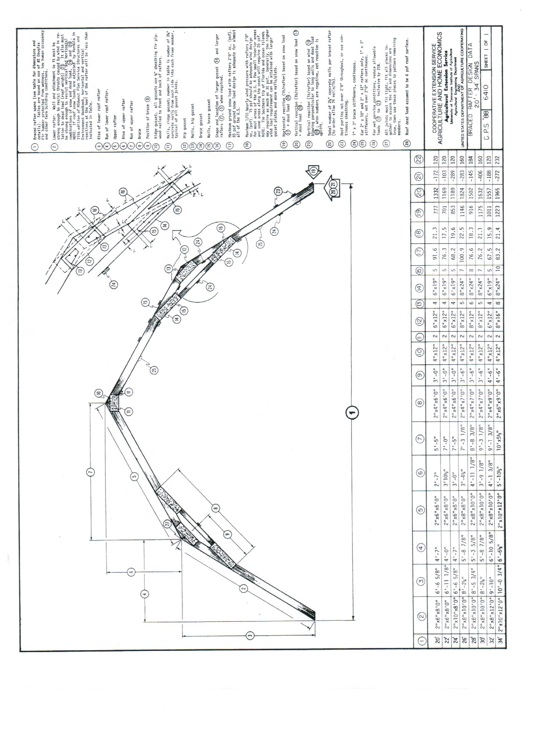

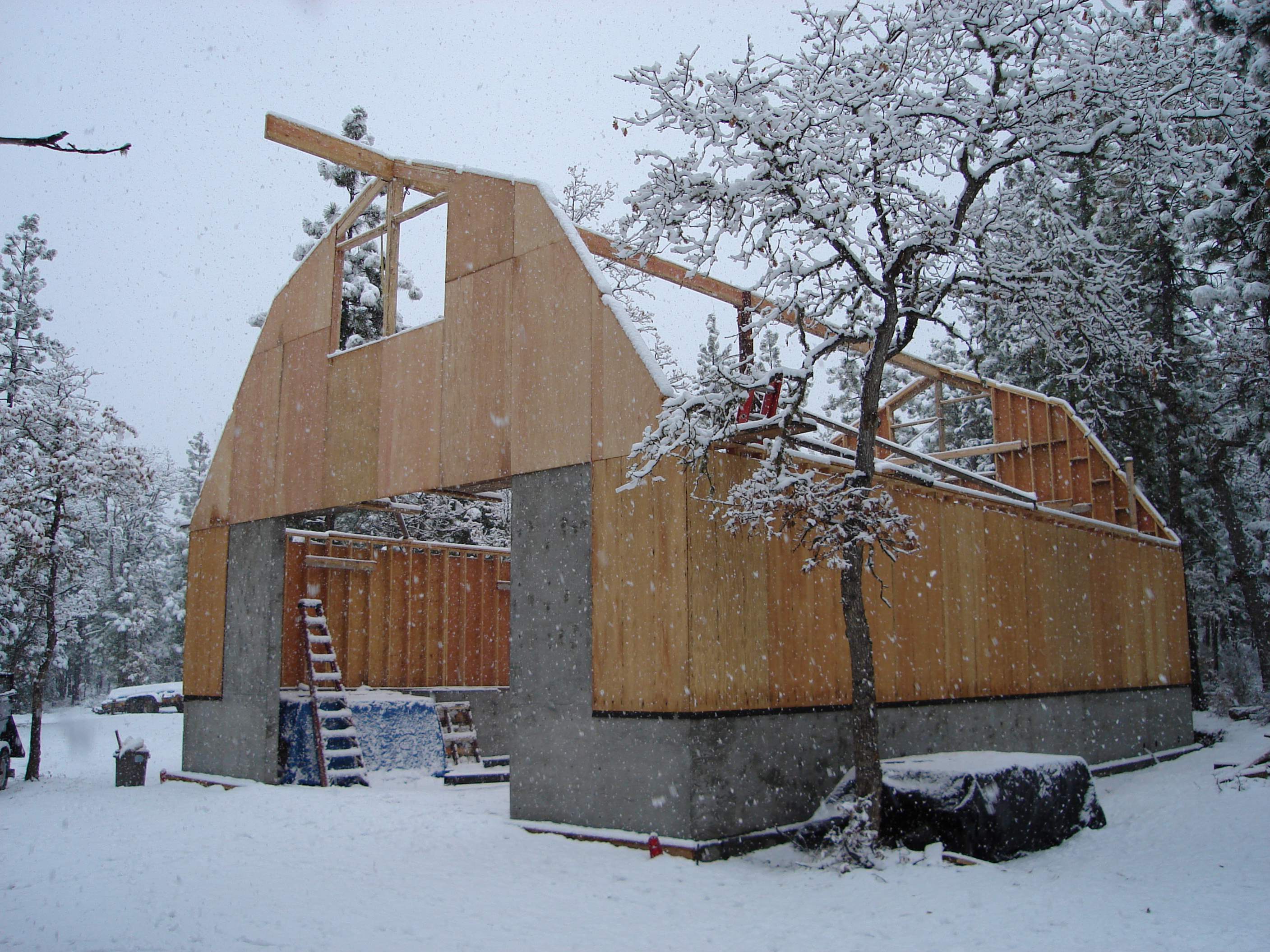

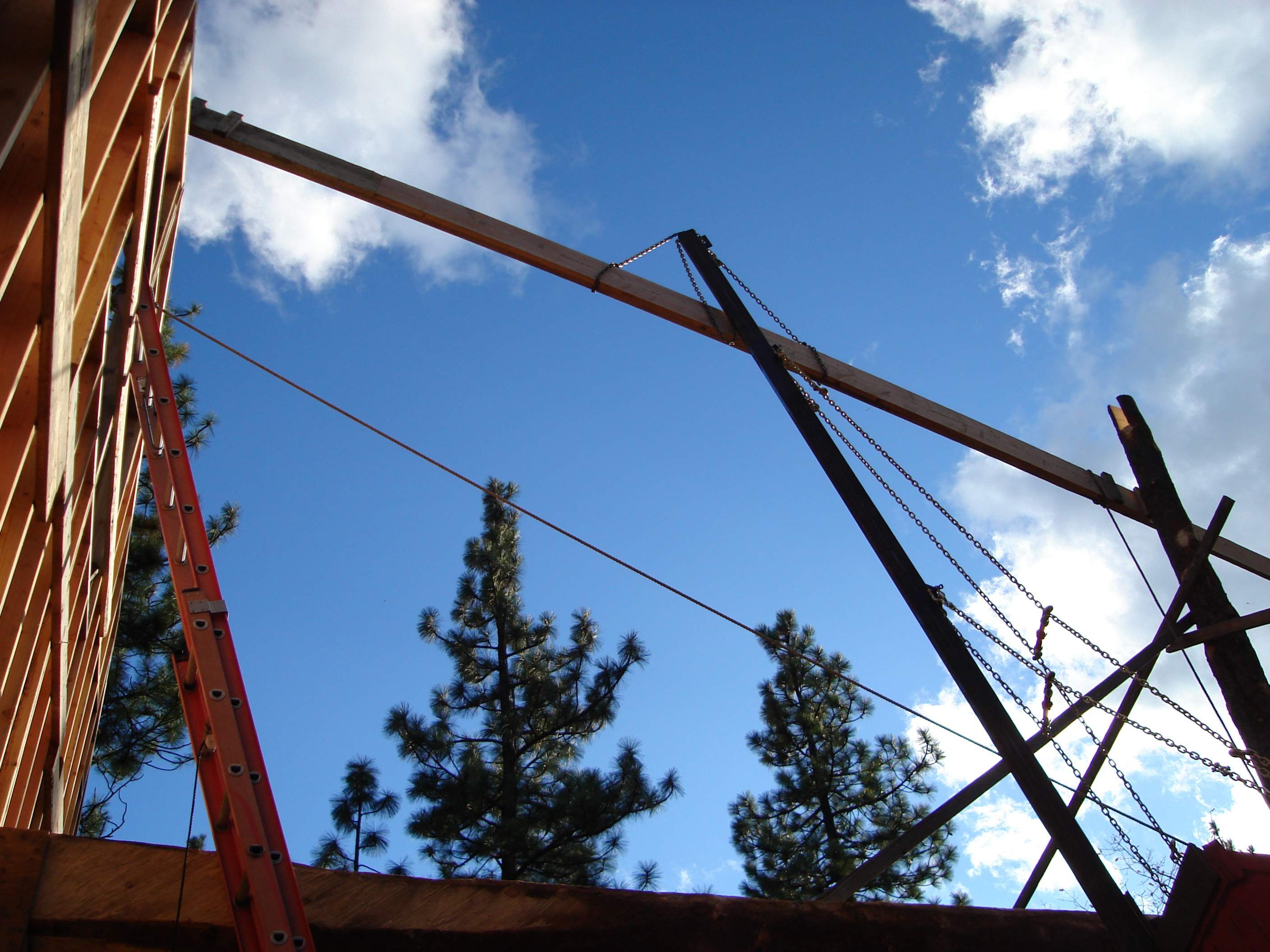

Schweizer, Im just north of you, south central Washington. I made my own trusses using a handy chart I got from some university extension. 001.jpg

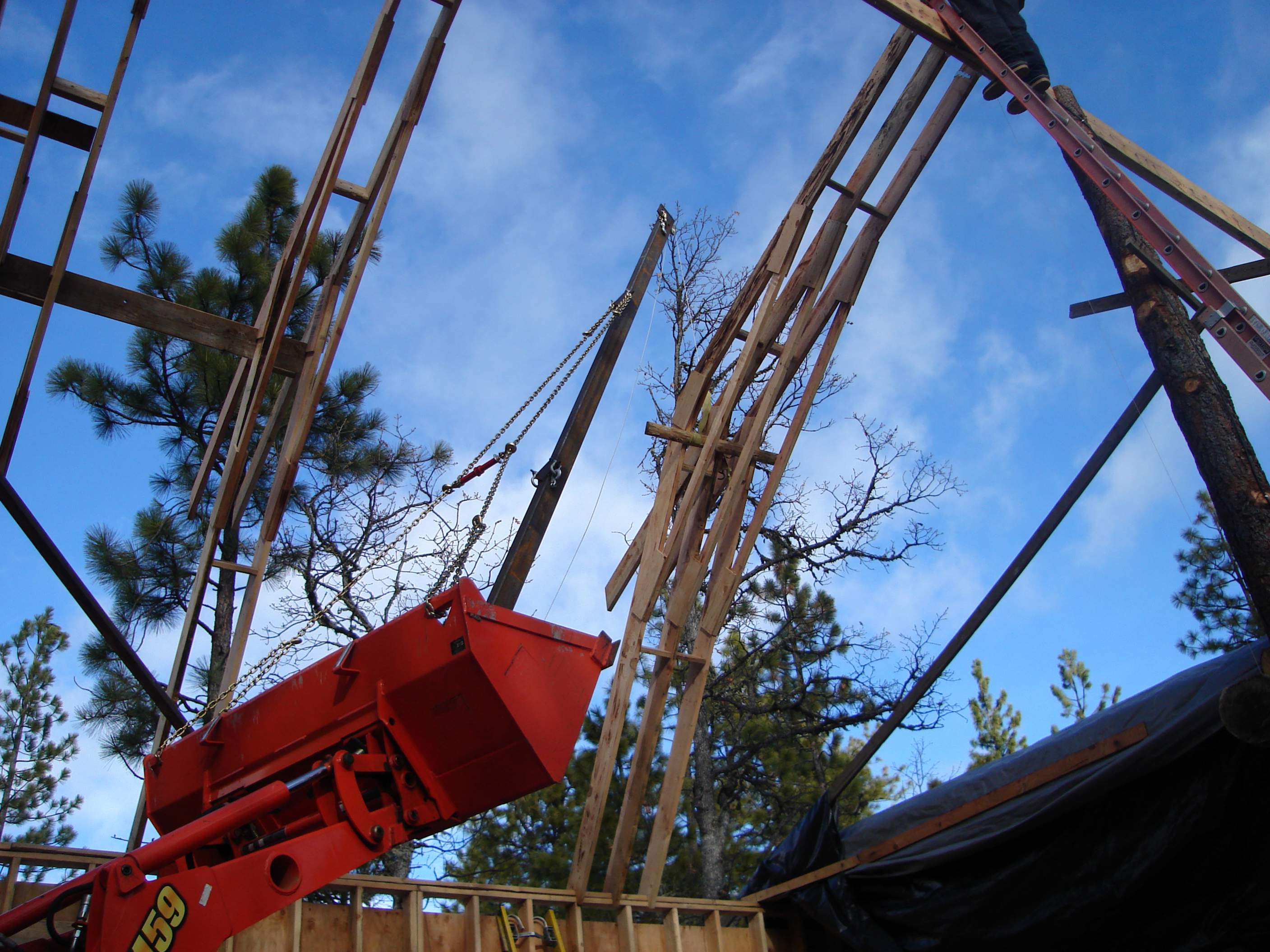

My ridge beam is two sistered 2x12s, runs the entire length, and is only supported at a center post and the gables. Its total length is 60 feet but only spans 24 feet. I lifted it in two parts that overlapped. It was one of the most intense parts of the entire project.

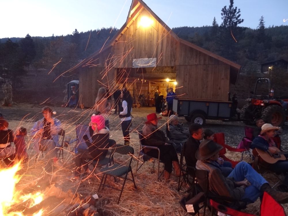

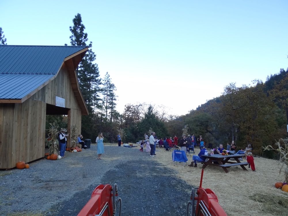

Well, the goal was to have the barn done enough to have a harvest party / barn party this fall, and it happened on Sunday, Nov 4! Wife and women from church did lots of decorating. Food theme was favorite soup/stew. Lots of desserts too, + spiced apple cider, cocoa, etc. Bonfire. Hayrides. It was a blast! Man, my broken foot was sore at the end -- I paid for it all the next week. (Bones are healing fine, it's the partially torn tendon that's still giving me trouble.
Bluegrass music around the campfire
Barn builder, Caesar/Anthony, and wife Cleopatra

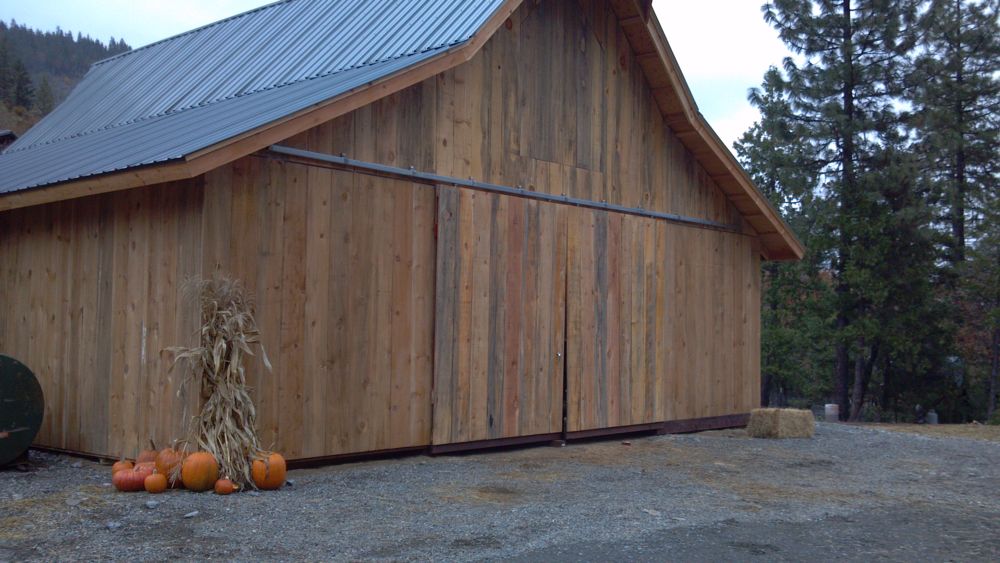

And this pic is from today -- I've been building doors and putting up box rail track for the front doors.
