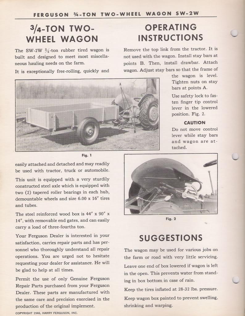

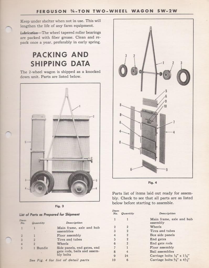

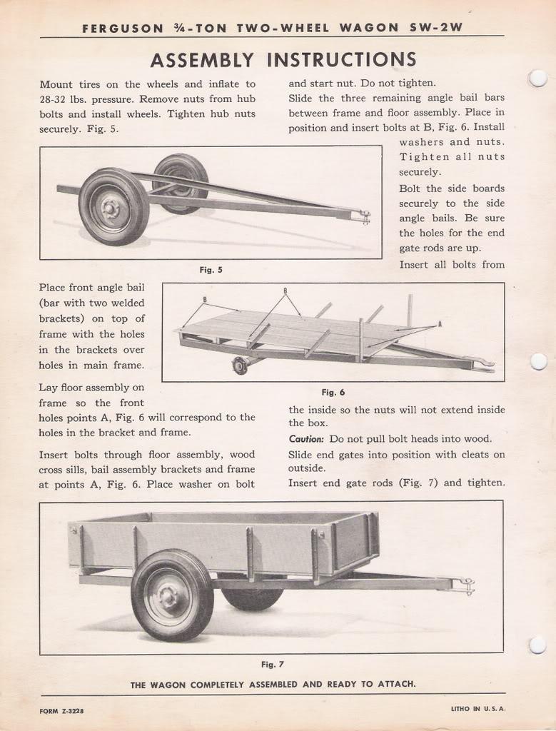

Awhile ago I found this old ad for a Ferguson 3/4 ton two-wheel farm wagon online. Looks about like what I need and very simple to build. (ad attached at bottom)
Mine will have a 45" x 97" x 14" bed (pressure treated), a frame and cross members made of 3" 4.1# channel, and a 3500lb axle. Tires will be 215/75R15s until I can get some 16" wheels for a set of 7.50-16 tires I have. It will have a pin hitch and no lights. While it won't necessarily be street 'legal' it will be highway towable and it might be used on the road between farms and such. Primary uses will be hauling firewood, fence posts, ear corn, square bales, two 4x4 round bales, and other misc stuff around the farm.

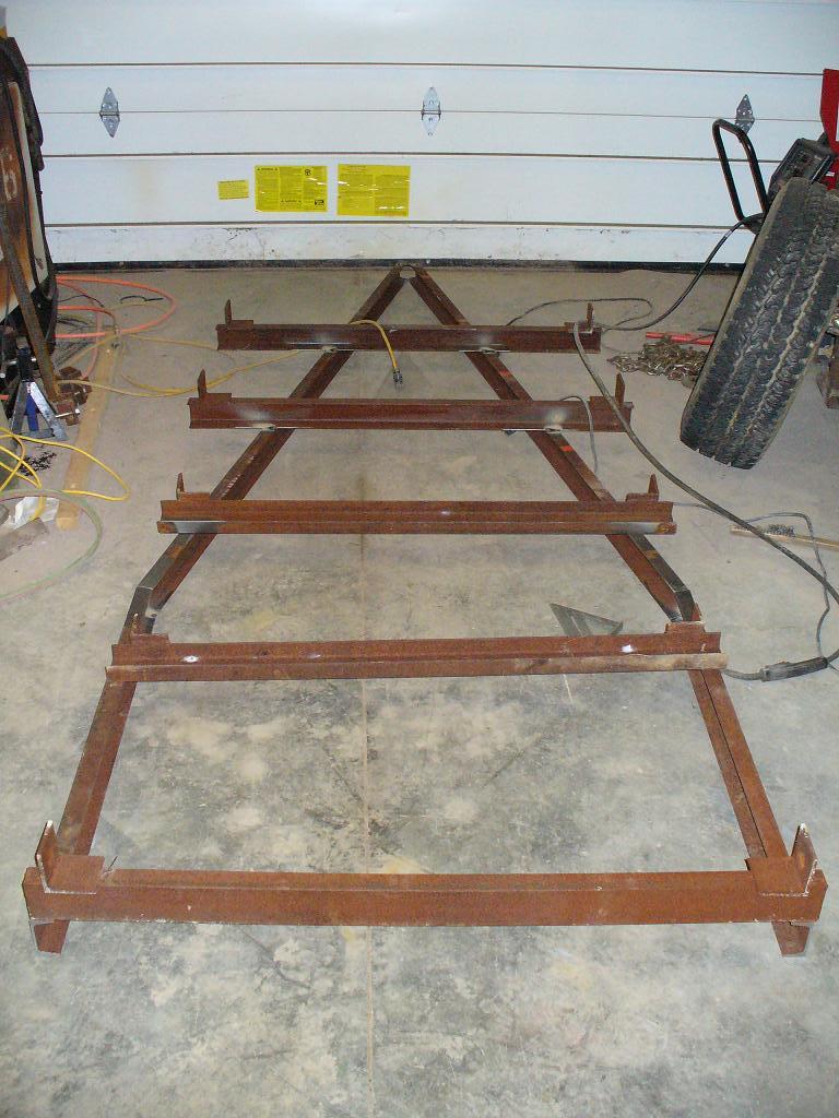

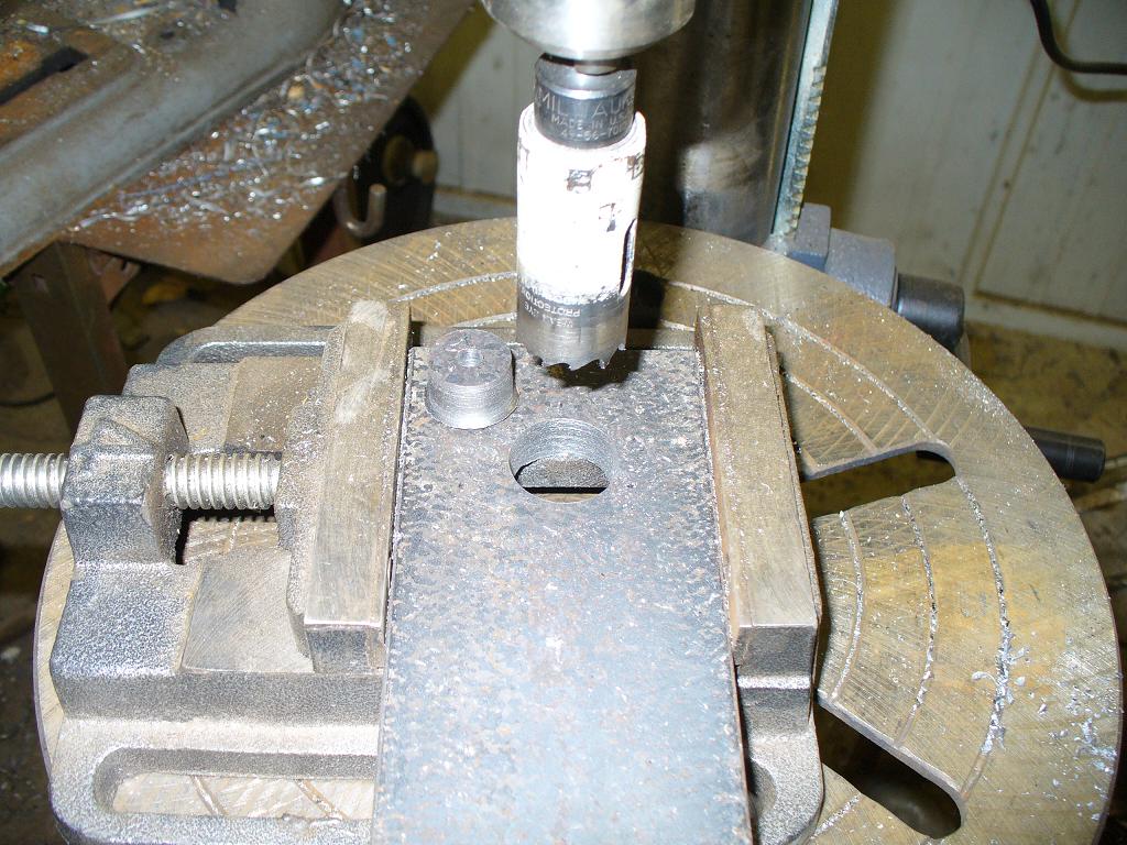

Only had about an hour to work on it this evening, but got most of the main frame welded up and the plates for the hitch made. Having all the cross members already cut to length makes it too easy. All told it would be equal to two full sticks of channel plus about another 4'.

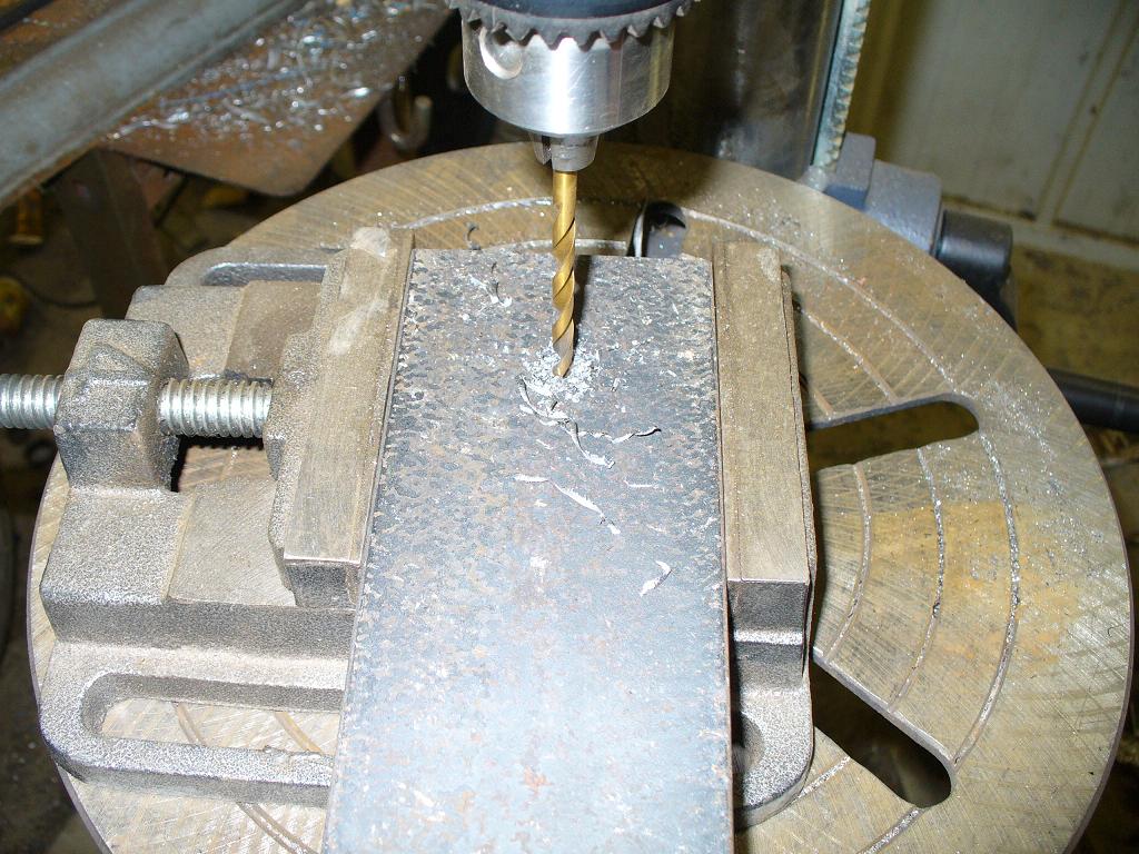

I'm welding the frame with my little Lincoln sp175 welder using flux core wire. I'll probably stick weld (7018) the hitch plates on as well as the axle. Drilled the hitch plates with a 1" hole saw. Top plate is 3x1/2", bottom is 3x3/8".
Attached are a few pics of the progress. The pic of the frame is what I got done yesterday. Finished welding all the cross members in today as well as the frame joint.

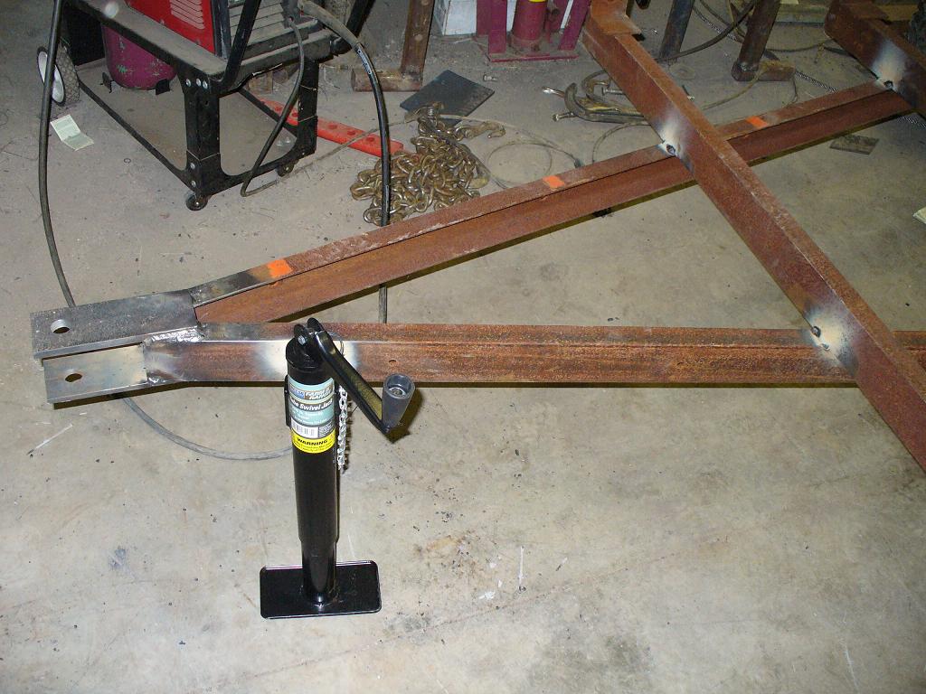

Made some good progress last night. Finished welding the axle plates in, cut the axle down, finished all the welding on the frame, installed the jack and rear hitch. The rear hitch is to pull my log splitter when I go to the woods.
The axle was a 72" Dexter 3500lb that I bought for another project and never used. To cut it down I simply measured how much needed to be cut out and cut it in my bandsaw for a nice square cut. Then I beveled the ends, cleaned off the paint and clamped it into the V of a piece of angle iron to keep it straight. Tacked around it four places, removed the angle iron and made one continuous weld all the way around. Since it is only a 4' long axle now I didn't feel the need to keep the camber in it.
The jack was just a little 2000lb pipe mount jack I picked up from TSC. I like the pipe mount jacks because you can swivel them up out of the way or take them off completely. Tires were some old 215/75R15 BFG AT's I had laying around, mounted on 15x6 wheels from TSC. This tire and wheel combo will ultimately go on another trailer, but will work here till I get the tires/wheels I want.
All in all it is going along pretty quickly. All that is left is to put the angle iron uprights on (to mount the sides to), paint it and install the wood.

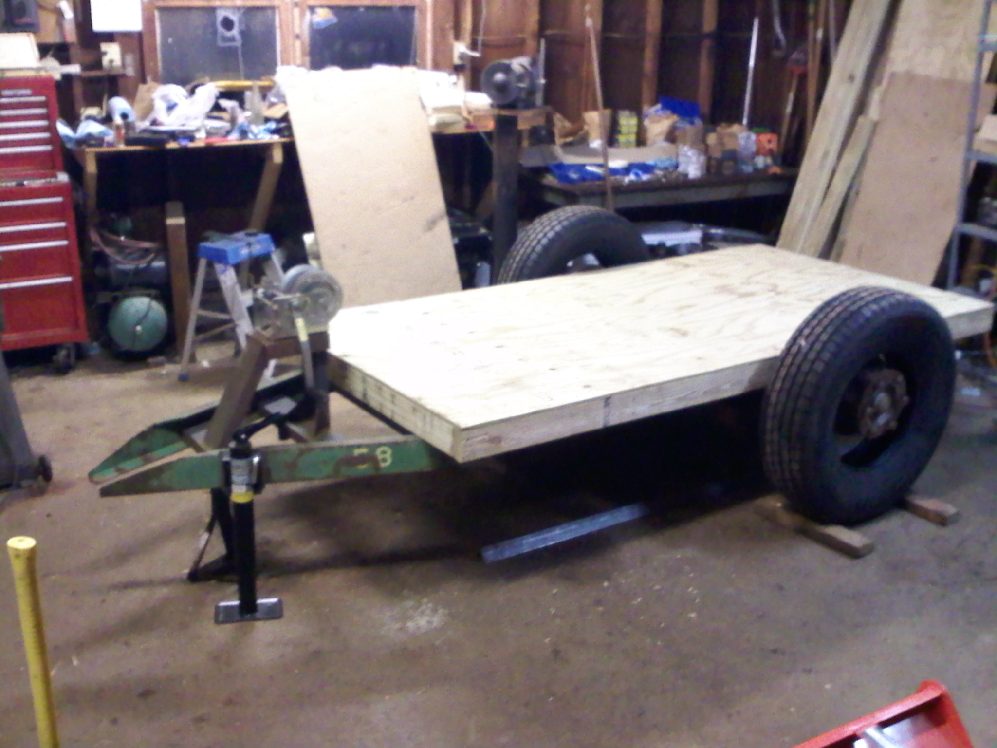

Finished all the metal work today. Made the uprights and got them installed. Ready for paint, then wood.
