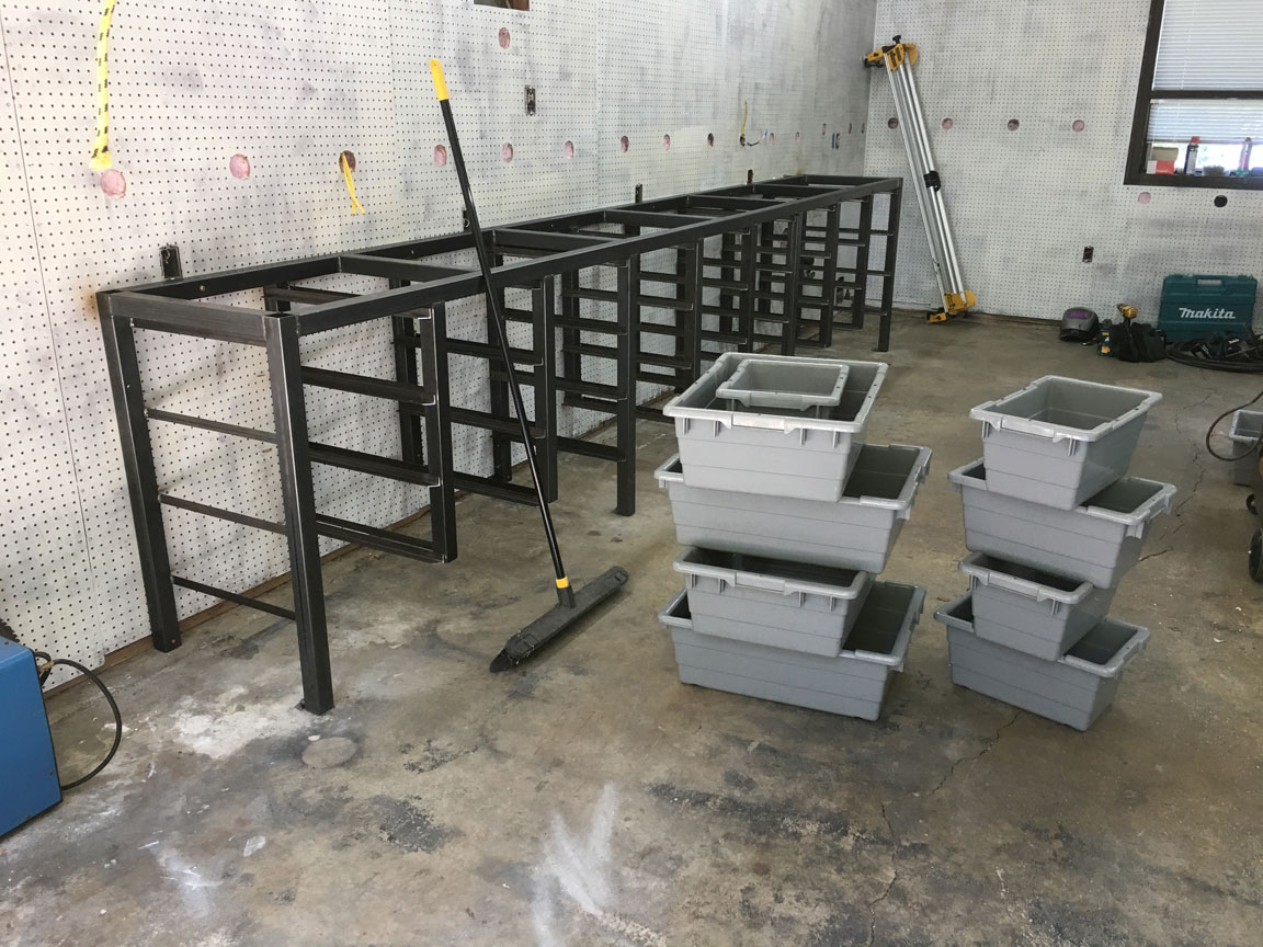

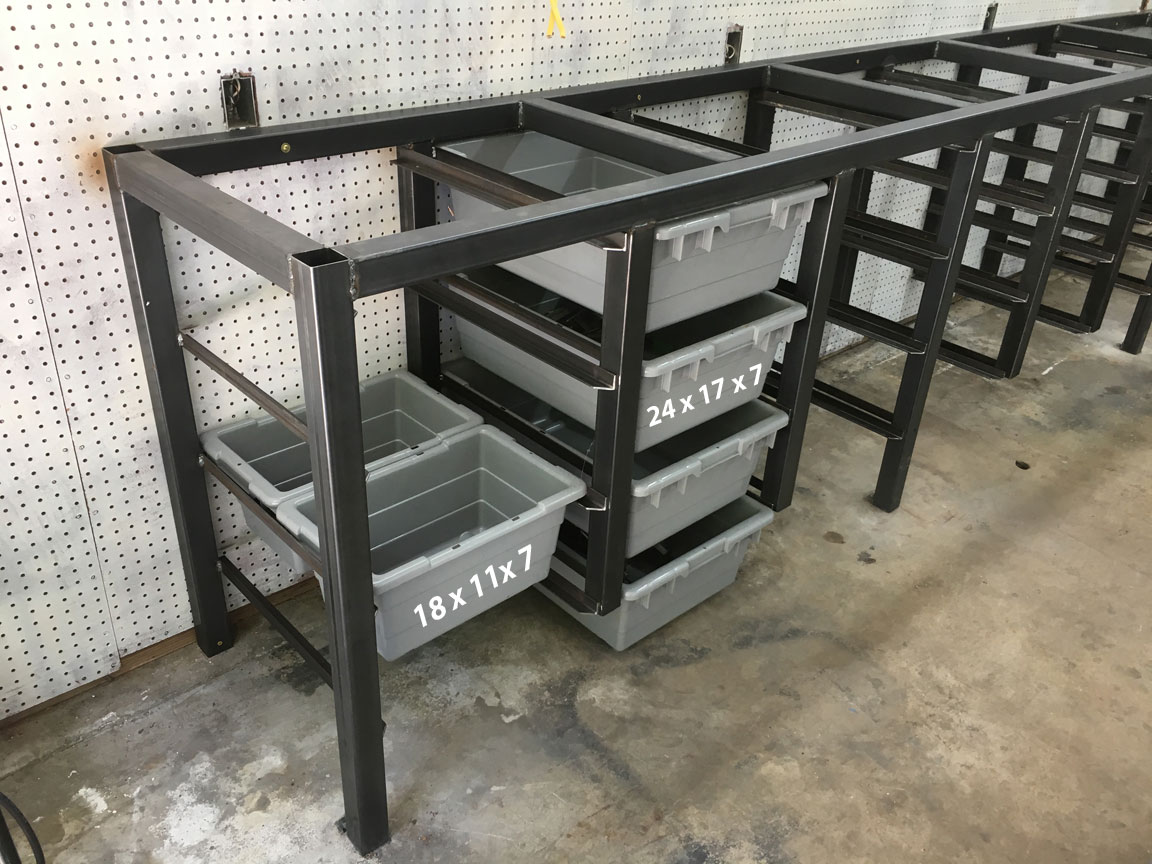

I'm using these type, which U-Line shows holding much heavier stuff than I will ever put in my workbench. I suppose they are engineered to last longer, but not sure how much longer. If they time-out in 10 years (and if no longer available) that's a problem. Buying spares now doesn't really solve the time-out problem.
501747d1489249941-building-workbench-cross-stack-plastic-workbench_cross-stack-tubs-jpg
Uline has some pretty nice stuff. More expensive, but better. Really nice job there, you have some pretty good welding skills.

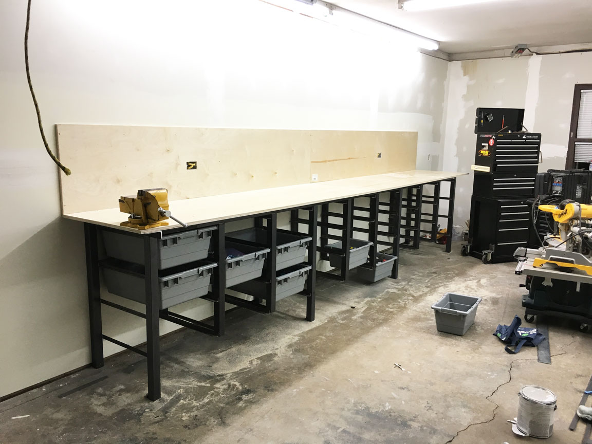

Finally got some time to work on my shop again
516712d1501223079-building-workbench-cross-stack-plastic-workbench_24s_11s_72-jpg
I found that TWO of the 11 X 18 x 7 tote size fit sideways on the drawer-slides set for the 17x24x7 size. This is good!!!
516713d1501223079-building-workbench-cross-stack-plastic-workbench_vise_support2_72-jpg

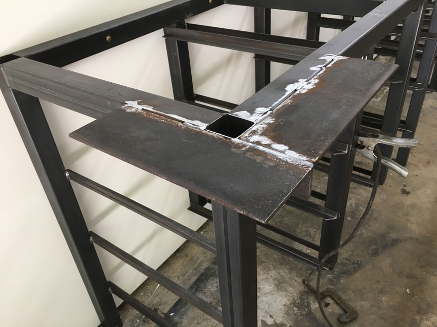

Added a support for the vise.
516715d1501223079-building-workbench-cross-stack-plastic-workbench_drawerslides_done72-jpg
I can pull out all the bottom totes/drawers and broom the floor.
28" wide birch plywood top with 20" backsplash. May put a long shelf above it. I intend to cover part of the worktop with steel sheet, maybe formica on the rest (later if it gets beatup).

jeez Sodo... good to hear this project is back rolling! Looking good. Is this the mountain shop? What is your finish plan for the metal structure?
I am looking at mounting a decent sized bench vise on my resurrected welding table bought online. Thinking of some kind of quick attach method so I can quickly go flat to function well as an outfield table. Your cantilevering plates give me an idea.

Looking good, Sodo!
Good call on the drywall. I'm not a fan of pegboard.

This is for my 'new' home we're moving into now (in the city). I guess Im not gonna paint the steel structure, it looked like too much work. Hope it doesn't rust....:shocked:
