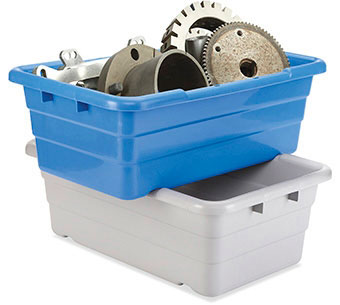

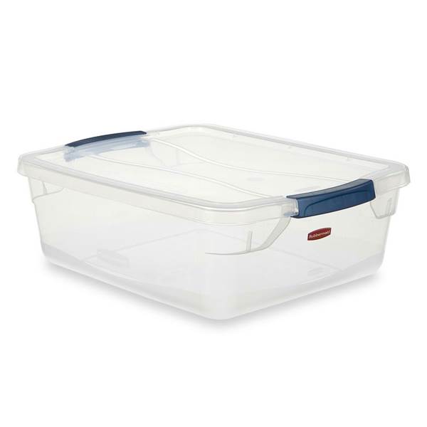

The tubs are thick plastic and rated for 100 lbs. You're probably thinking of these plastic tubs View attachment 501746
which are engineered to shatter after a few short years; quicker if you ever move them around. You have to be pretty careful with these tubs, don't knock them together. Or if they fall off a shelf they shatter. Good WalMart product to take your money - then plug up the landfills. Rubbermaid (to me) means the product will time-out in a few short years.
I'm using these type, which U-Line shows holding much heavier stuff than I will ever put in my workbench. I suppose they are engineered to last longer, but not sure how much longer. If they time-out in 10 years (and if no longer available) that's a problem. Buying spares now doesn't really solve the time-out problem.
501747d1489249941-building-workbench-cross-stack-plastic-workbench_cross-stack-tubs-jpg
Uline has some pretty nice stuff. More expensive, but better. Really nice job there, you have some pretty good welding skills.

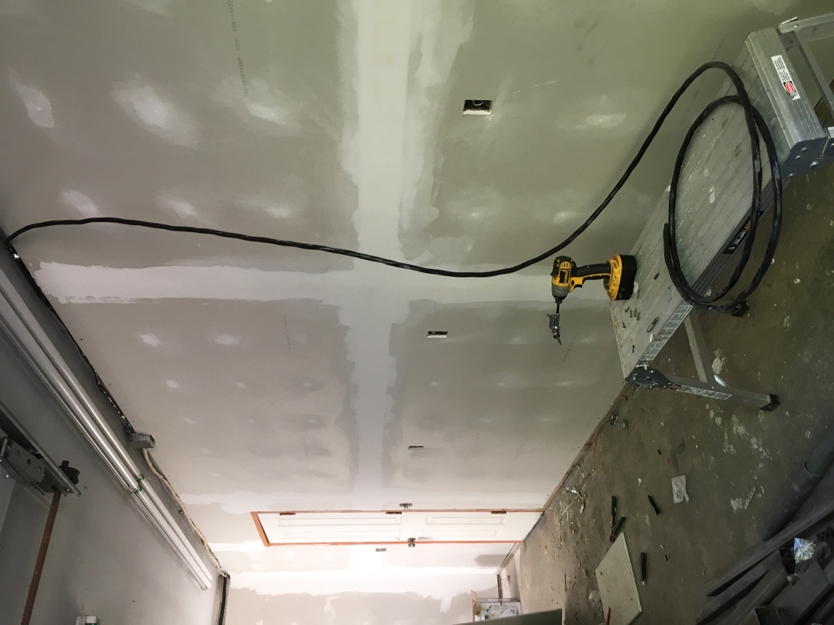

Welding outlet was on an inner wall, I'm moving it to the outer wall by the door. #6-3 wire.

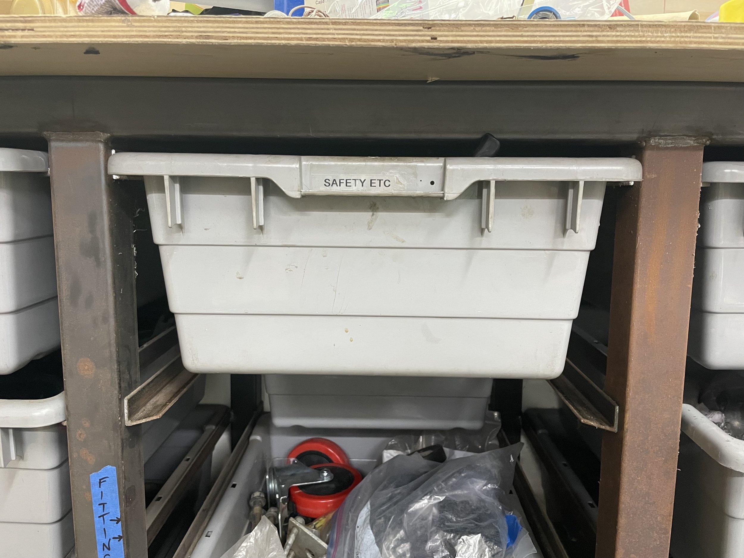

Heres the 6-year rust report. 4 posts have light rust. 6posts are still mill-scale.
The drawers pull out. It won’t be hard to paint if I ever get a round tuit. What I really need to do is clean off the workbench.

Now that you've used them for six years, would you do it again?
/ Building a workbench - cross-stack plastic tubs for drawers
#37
That’s a good 6-year question!
Yes its GOOD. I’m thinking about adding another rack.
