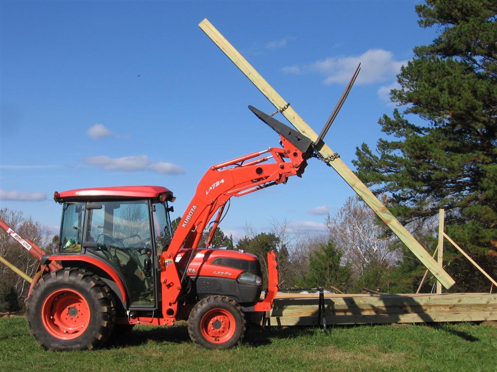

I actually added that pole barn extension to my shop 99% by myself. Setting those 6x6 16' posts by myself was a bit of a pain though. :D
Pete,
Next time you have to set those 16' 6x6 by yourself, chain them to your pallet forks. It is a lot easier on the back. Rick

I put in lots of 16' 6x6 posts by myself, found it to be pretty easy. pick them up about 3' with pallet forks, one end over the hole, lift the other end up, setting the other end in the hole, and walk it up.
