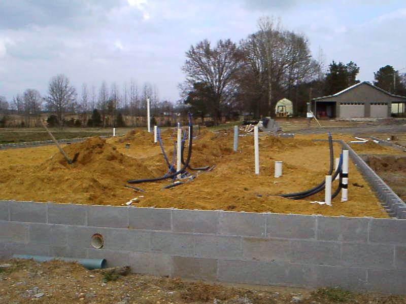

Excellent suggestion! I discussed with plumber today, and he will check w/ builder if that would be considdered an extra charge or not. If so and the amount is small, I'll let then do it, otherwise, I'll do it myself. Like you said, it is cheap and easy to do.

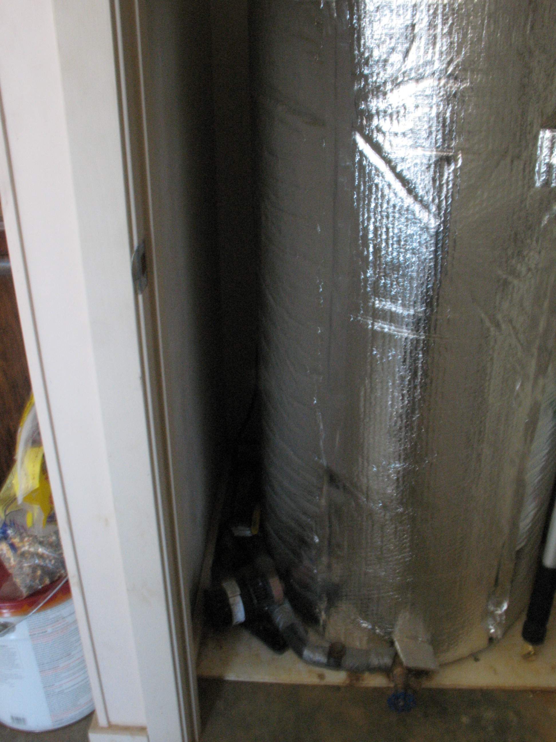

All my plumbing is copper and insulated and underground. I have a small pump located at the hot water tank that circulates the hot water from a header to all locations so it is instantly hot, well almost, it has to run from the header to the faucet about 4 feet normally. I would for sure insulate the lines with closed cell foam (cheap) and have the plumber run a recirc line for all the hot water ( a little added cost but not too much at this point) and add a recirc pump. Water costs more than the electricity to run the little pump when you have to run a couple gallons to get it hot before use every time and water costs are rising everywhere you have city water supply.

Again, yep, insulate ALL your water pipes! I also second sealing so mice can't get in - it can be done, I also did that to my house - no crits inside, except me hound of course.
