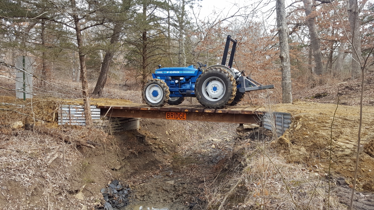

I cross bridges often with heavy equipment. If you are going to take the time to build a bridge, build a strong one, that will last decades.
A mobile home frame depends on the wall/roof structure to gain strength. Once you remove all that they get pretty wiggly.

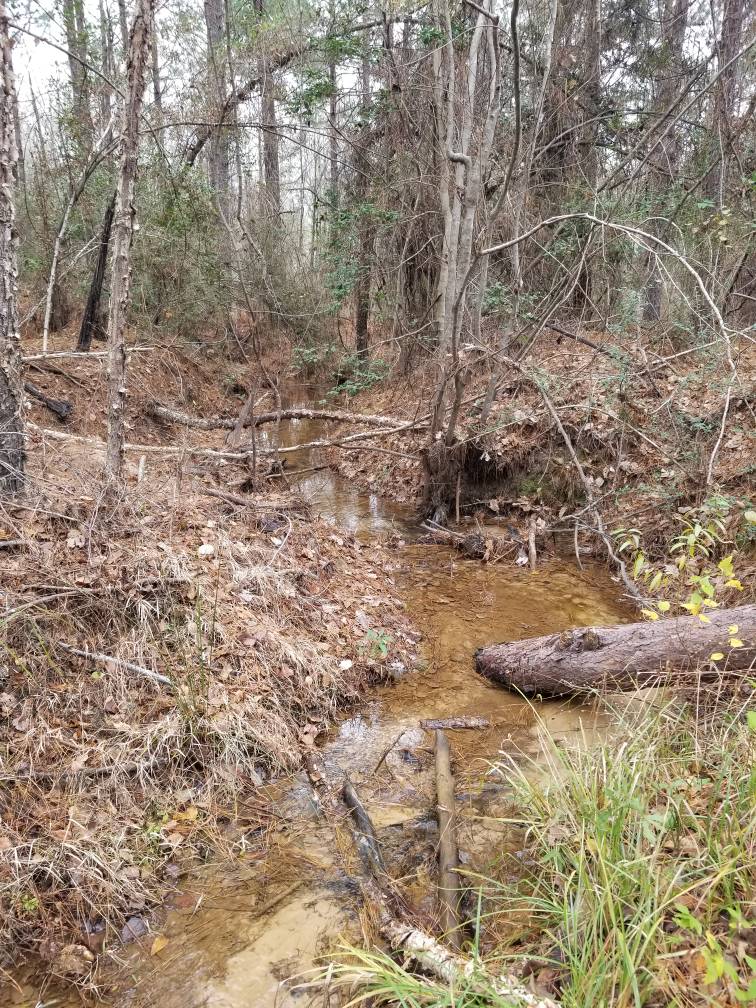

This is my little creek. I wonder if it would be best to just cut down the banks and make a crossing that way.20191128_133234.jpg

that creek is dry. why not just fill it in??..
   / Building a bridge? #38
This is my little creek. I wonder if it would be best to just cut down the banks and make a crossing that way.View attachment 630707
If you only plan to cross a couple of times that would work. If you plan to use it on a regular basis in all kinds of weather it will get messy; and in the long run it's better to do it right. The better crossing seems to be about 2/3 of the way up your picture, although it isn't where your trail is. The banks are higher while the channel is narrower.
4' dual wall plastic culvert is $42 per foot governmental cost here is Missouri. The cost of larger culverts is extremely high.
I was replying to a suggestion of concrete. I believe that the 18' bridge I was quoted for was a bit of overkill though. I probably will have a small bridge with a 6'span built on concrete waste blocks, as it's a major access road and will be used for longer than I'm around. I also have some short bridge steel which came out of another crossing a few miles away which will keep the cost down.

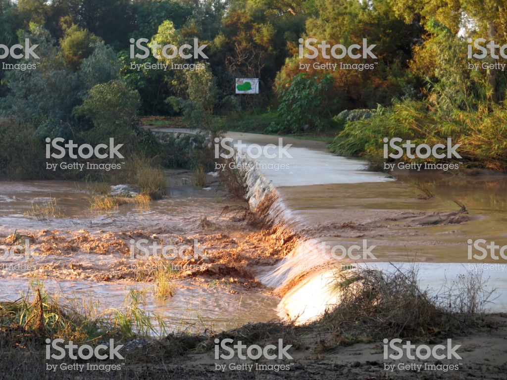

A concrete ford doesn't have to be at current creek-bottom level. It can have its downstream edge above that and make a nice waterfall onto large rocks. This lowers the approach angle.
Of add a culvert for low water and a concrete ford for high water.
