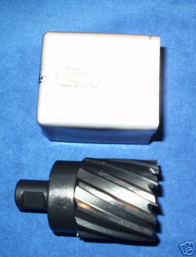

David, Do you have a way to cut perfect 1 1/2 in holes in your tubing for the pin supports? At the time I was doing my backhoe, I cut mine out with a home made circle cutter using a plasma cutter. Wasn't perfect, but once I aligned the tubing for the pins, it all worked out. If you have a big enough drill press, this annular cutter should do a nice job. Next best thing would be to have some one cut out all the circles with a computerized plasma or laser cutter. Then, all you have to do, is assemble and weld.

Would a hole saw give a clean enough cut?
   / Build A Backhoe For PT425... It Could Happen #70
That 14 in blade has about 70 carbide teeth on it and the metal comes out in chips. I cut three in angle i/2 in thick in 30 sec. It is fast and gives a smooth cut. The edges look polished.
