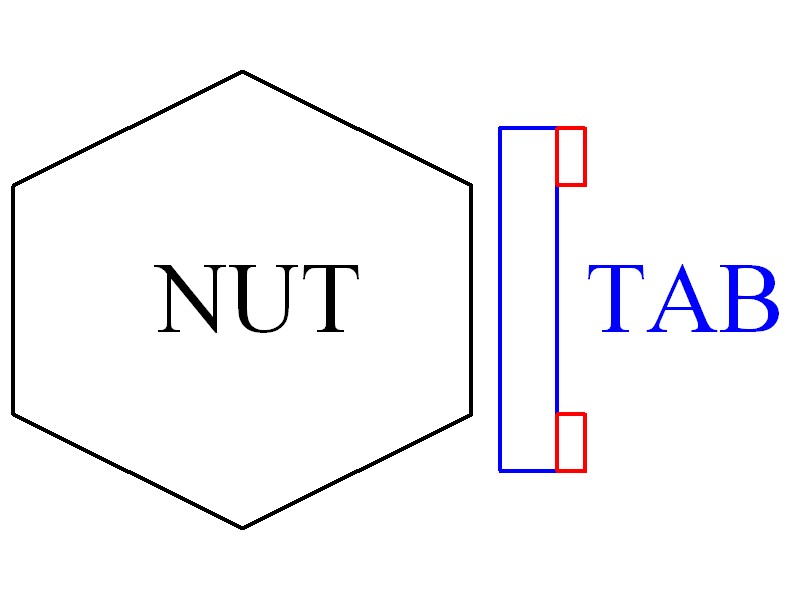

David, This is a drawing of what it should look like. Red is the tack weld.

Beautiful! Thanks. /forums/images/graemlins/grin.gif

Perhaps there's a reason this isn't being considered [and the tack welds do sound very quick and foolproof], but PT seemed rather found of NyLock nuts and I saw at least one "castle nut" on my machine too.
The former isn't as strong as a tackweld, but very simple for installation and removal [more than a couple install/remove cycles requires a new nut though]. The latter requires drilling a hole through the bolt for the cottor pin, but no big deal. Strong, but not a quick as a weld.
Also, I think drilling and tapping for the "lock tab" was discussed, again not as quick as the weld. How about red locktite?
   / Build A Backhoe For PT425... It Could Happen
#50
Yeah, the lock nuts would work, too. I'm thinking several methods are possible when using a bolt instead of a large pin.
1. Weld the nut to the frame and use a lock washer under the bolt head.
2. Weld the steel stock to the frame on the nut side and use a lock washer under the nut.
3. Use the lock nut method.
4. Drill and cotter pin the bolt through the bushing on one side and not worry if the nut will come lose. This is similar to what the design calls for, with the advantage being I can buy bolts to the correct length and not worry about cutting rod stock for pins. Disadvantage is I think bolts will cost more than rod stock for pins.
All I know for sure is I will need some 1" ID X 1.5" OD tubing no matter which method I go for.
Keep the suggestions coming folks. /forums/images/graemlins/grin.gif
